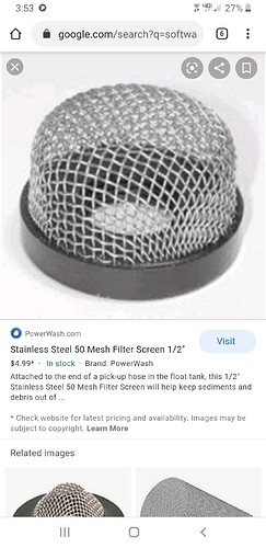

I bought a soft wash system from Power Wash Store and they provided a mesh screen filter in the kit. I built a proportioner and hard plumbed all my draw tubes into their respective tanks. I put that screen into the bottom of my SH tank draw tube and the screen completely disintegrated in 2 days. If I was thinking, I would have known this would have happened, but I obviously wasn’t thinking. Does anyone know of a plastic version of these filters? Or do I even need one? Can I just run a piece of 1/2 inch PVC into the tank and call it good?

The filter attached to a 1/2" hose. I can only find the DS 1/4" filters. Does anyone know where I can find 1/2 plastic filters?
I haven’t used a detergent filter in about 8 years.
All you doing is restricting the flow of soap.
Plastic or not, the screen corrodes within days and screws up the flow.

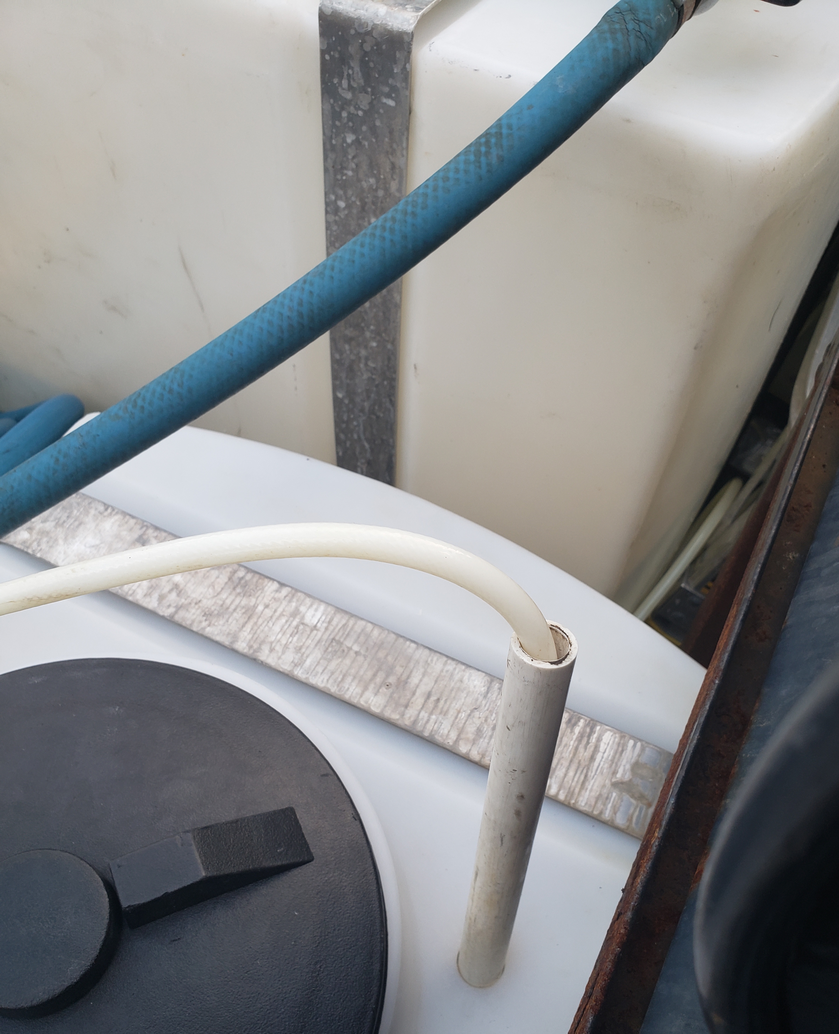

So I can just put a tube down there without a screen of some sort and it would be fine? If thats true then that is what I will do.
Absolutely. I’ve never ever used one.

Never use that one with the screen it it. Will corrode as @KMP said and usually get a piece stuck in your injector. This is the one you want for your injector - can get most places.
