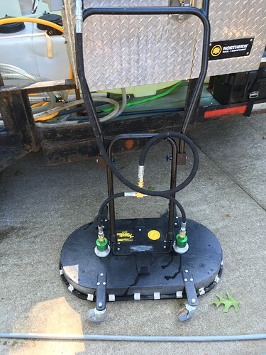

Which one the purple? I prefer them facing North south myself. That’s the design prototype. I have many changes coming to it.
But the mini mondo is build the same and no big issues. But we run 2 man crews and large stuff I have someone dedicated cutting everything.
On my mini had them put arms straight back front and rear. Works great and doesn’t effect stability at all, because it’s still wide.
