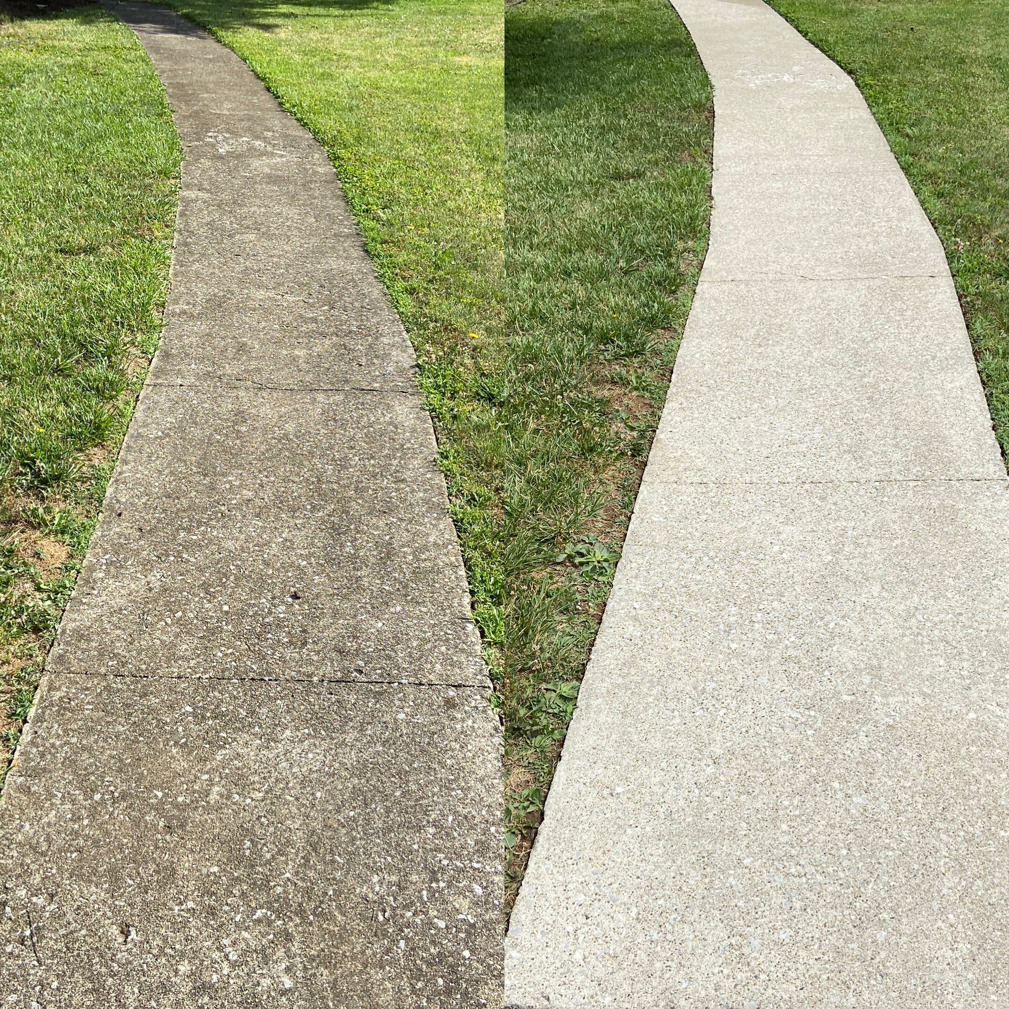

Yeah, just to kill any organics, have done without, looks same to me. But for customer sake I pretreat to kill all organics. Heat probably does, but…use hw mix.
19” aluminum WW
Came out beautiful :+1:
Thanks!
Seriously jealous. Maybe next year when I get a bigger trailer I can pick you all’s brains and add a hot box.
