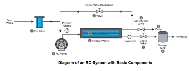

If running an enclosed trailer my preference would be to have the RO system running to a storage tank and have the reject water going into the buffer tank. Use a 12 volt for di h2o The added solids for a single pass through a 4"x40" membrane will not effect your pressure washer in the slightest. Commercially they recirculate the rejection fraction through membranes as outlined here
basic ro

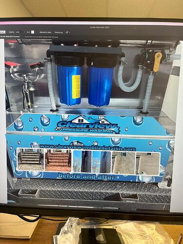

Looks good firefighter4hire. Those 20" ro housings?
40x4, 40x2.5 that machine runs 3 poles up to 65 feet high. I dont know any other system that will do that. You dont need that for basic window cleaning. We went down the cart road. I still use my unger hydropower system. I keep that thing with me all the time
