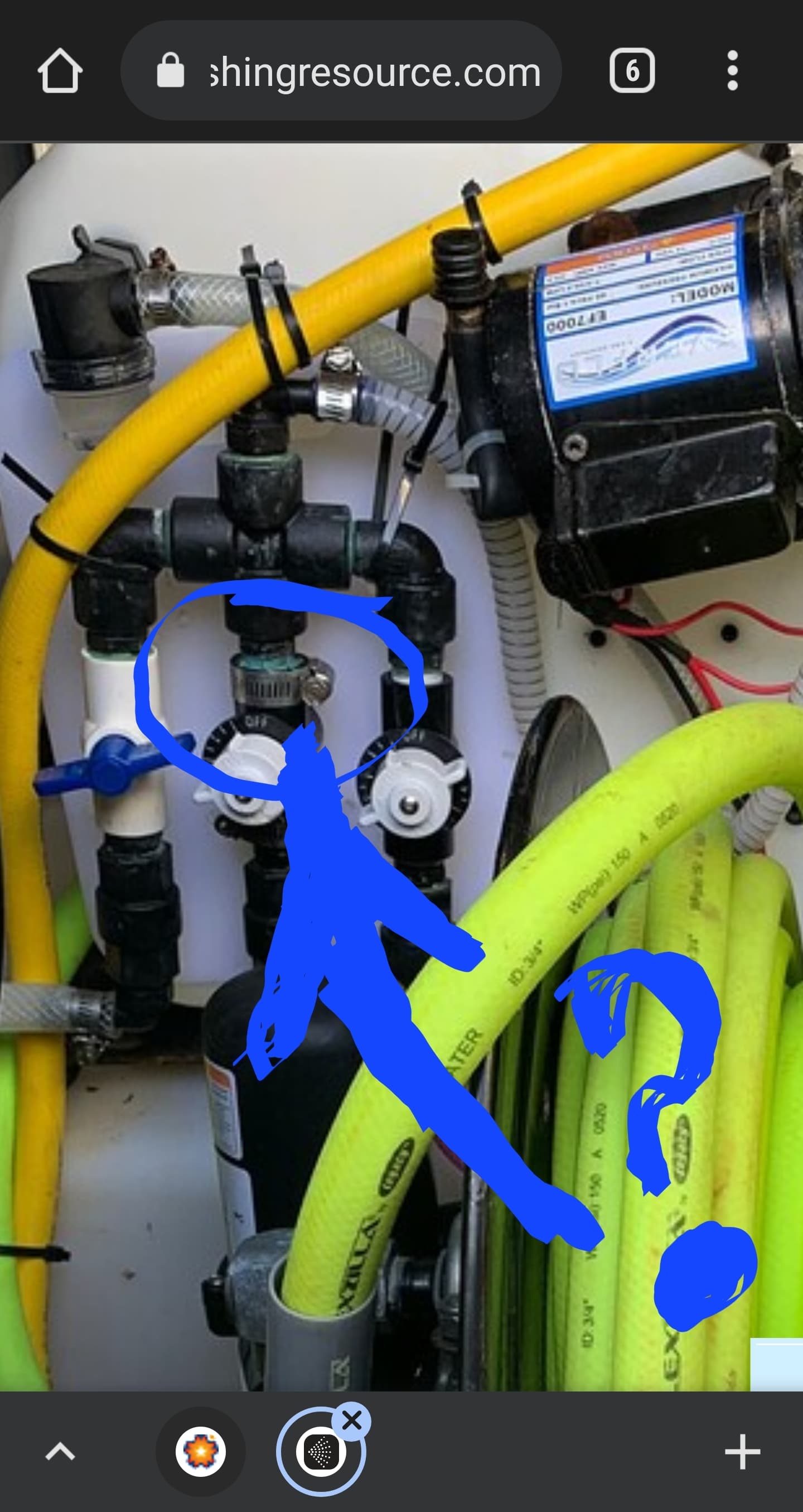

Not a bad looking setup and trailer other than your 12v and proportioner area. Sheesh, that’s a rat’s nest. Get a piece of plywood or something to mount all of that neatly to the wall or an upright and redo that section. Will make it a lot easier for you to work on and troubleshoot.

@dc1mk2 how is your 12v pump mounted? To my eyes it appears to be just floating. On my pump it states I have to keep it laying flat.

@dc1mk2 why is that there? crack remedy? could be where air coming from.
Yep. I was just looking deeper into the parts and asked myself the same thing. My hose reel needs a bit of work also.

The pump and proportioner base are both attached to the tank’s preset threaded holes. Needles to say the whole area will get reworked and remounted.
The pump and proportioner don’t need to be that close to each other when you rework it. With it bunched up like that your forced to use 90s to get it plumbed, something you want to avoid or keep to a minimum. Spread it out a bit and run straight Nipples off the proportioner and pump with longer plumbing. Think circle not square with plumbing, it’s only a 12v pump, the smoother your flow the better it works.
Yeah no doubt. .There is plenty of room for a complete new plumbing job. I also realized that it is the cheapest proportioner on the market. Definitely considering an update grade while I am in the process of correcting issues.
