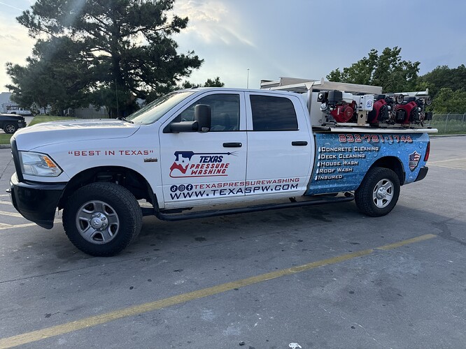

Leonidas 2015 Dodge 2500 8FT Skid
Leonidas finally rides. Truck #4
Some new things demoing on this skid:
Tank Monitoring System (Sharp Solutions)
Skid Clear Coating for SH resistance
Leon’s Mo Flow Soft Wash Pump
Also:
2x GX690 10GPM
300 Gallon Buffer Tank
100 Gallon Chemical Tank
7 Gallon Soap Tank
4x Hannay Electric Reels
3 Valve Clear Remote Proportioner
UWS Tool Box
Surface Cleaner Rack
22 Gallon Fuel Tank
The tank monitor kit we developed. We tried several off the shelf models but they couldn’t handle the driving around and constant splashing it seemed.

Did you put lights on the tanks to make them red, white, and blue?
Forgive my ignorance, but what do the tank monitors monitor? Just levels (amounts)?
How do these take hills? I know Texas is pretty flat, but I have inclines. It looks nice, and I would like to have a smaller footprint but still keep 4x4 so I can get to some houses.
Sorry for the 20 questions, but went to wash a small shopping center and the hose bib valve was busted. No other valve. I’m home now and bored, can’t do anything around the house until she who must be obeyed wakes up. Glad no one was there, string of profanity at 0600.
Yes sir tank lights for red white and blue.
Yes this is just showing the buffer tank level.
No issues with hills or hauling. I have a truck up in Tennessee now doing several projects.

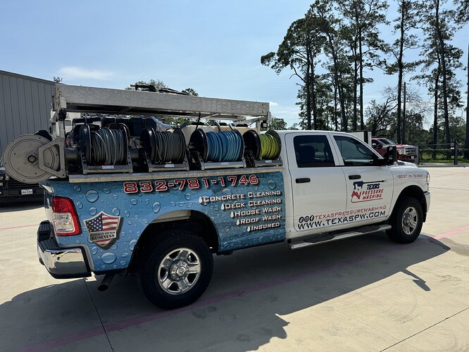

Added another 2020 Ram 2500 to the fleet. Upgrades to the truck. Hellwig sway bar and timbrens.
Are you getting away from the utility beds?
Yes I did one and done. Skids for me. Versatility and now with having a water trailer with burners on it… easy day. We’ve got it setup to 6 pin power off any truck skid so they all can use it. Skids has a 300 gallon buffer tank and the trailer is 500 gallons.
OK, I give up, what’s purpose of heaters on water trailer? You get 5 freezing days/yr, lol.
As I said we keep them mobile so any truck can run hot water units. They’re not connected or related to the buffer tank on the trailer at all.
We use a 6 pin cable to power them off the engines on the trucks and jump lines to connect the hot boxes to the pumps and reels.
Gotcha - good idea
