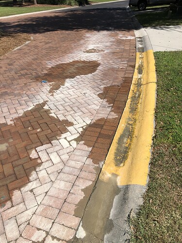

Finished this driveway but didn’t feel great about the mess I left in front of three houses. Tried to clean it up but really just spread it around. What can I do better so I don’t wind up with such a mess in the first place?
I rinse carefully out to the street gutter and then rinse push the water down to the drain. In our area we have drains everywhere, it’s crazy….not sure where you’re at.
The drain was another four houses down, so I didn’t even make it half way there. I could’ve pushed it if it were the asphalt section of the street but I wasn’t able to push it very well with all the dips in these bricks with my 2.4 machine. Starting to see the need for an upgrade, really going to appreciate it.
Yeah you need more GPM for sure….that will help. Have to use what you have at the moment, but try to upgrade to at least 5.5 but 8 gpm be great.

015 nozzle on the surface cleaner which if I’m reading the charts correctly should put me between 1500-2000psi, but you probably mean on pushing the dirt down the street during my rinse which I just used my 0030 because I wasn’t even thinking of using pressure during that. Next time!
Wash it all into something that resembles a pile, then use a square-pointed shovel to scoop up majority of it. Put it in a 5-gal bucket, throw it in an inconspicuous area of the landscape or find a trash can. Rinse down what remains.
