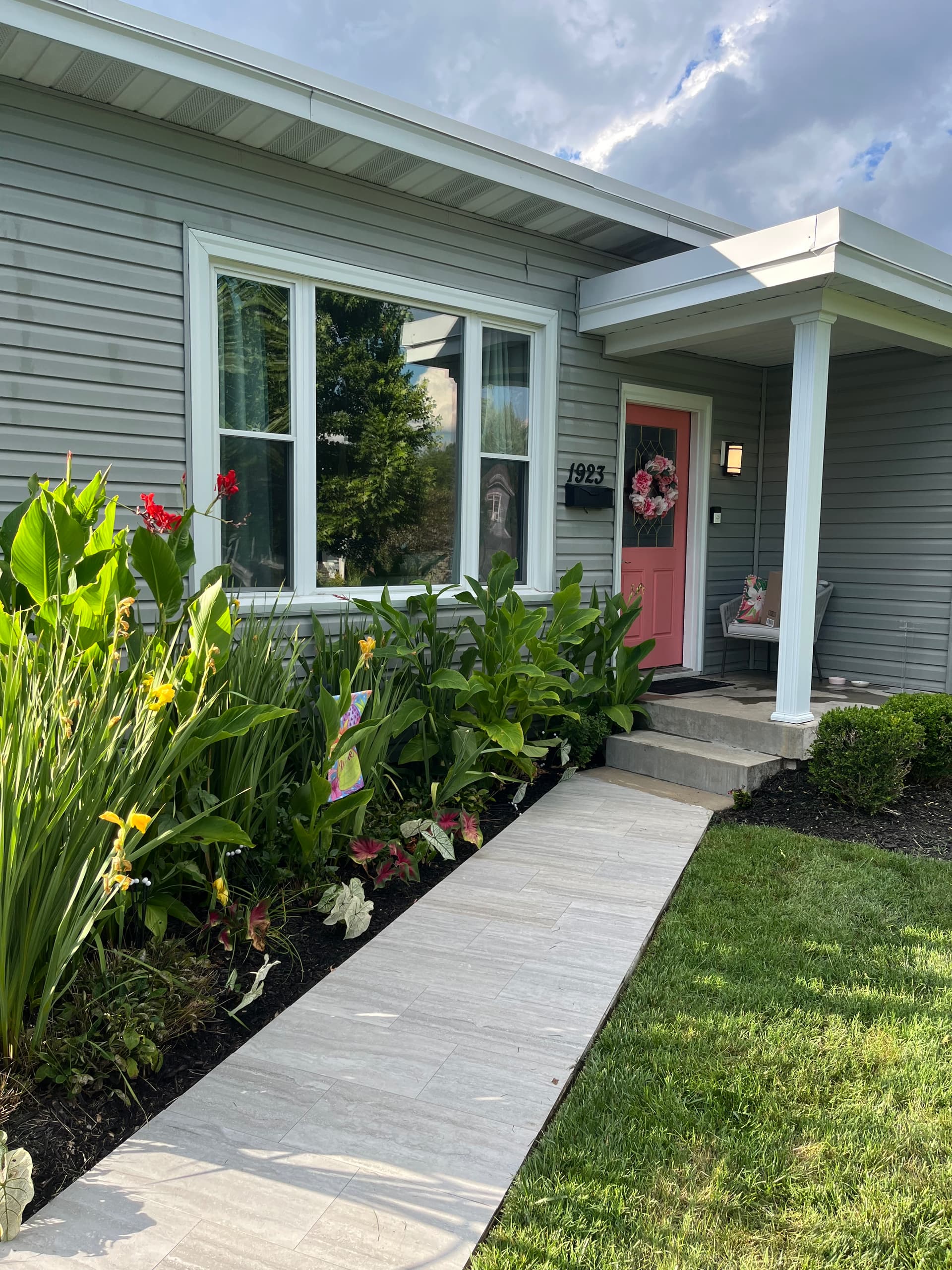

Here’s a pic right after I got done.
Did you rinse them right after your chem application?
I did, a couple times. Looks like I need to either use plastic or have someone spritzing the plants constantly when applying.
Wow….we’ve worked around those Japanese maples and they are sensitive. I just prewet then apply chem on that side of the house then immediately rinse the plants well….seems to do the job. I wouldn’t think hw mix would do that type of damage? I guess if you never rinsed at all….maybe you’re pulling a little bit hotter mix?
Those look like cannas, or canna lily by what we’d call them in South Carolina. Hosta is a different plant, don’t know about “hostels”.
Yeah ‘Hosta’ I believe.
This FlowPro is definitely pulling a hotter mix, very close to what my 4gpm machine did. No air leaks, straight from the tank. Amazing.

Sounds to me like your mix is too strong. Also, i think hostas are cheap and grow easily. Don’t worry too much about them.

Hostas are tough, they don’t look like hostas to me. My hostas don’t grow vertically like that. I wash my back deck every year and I don’t even pre wet the hostas anymore, they laugh at SH and mock me saying is that all you got?
Doing a google image search, it looks like those are Canna Lily’s.
She had a mix of Hosta in the front and taller canna in the middle.
