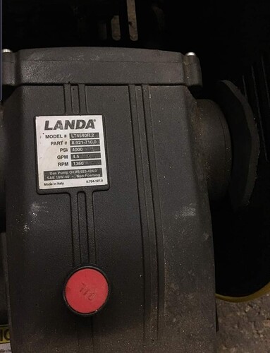

Hello everyone, my name is Eric im from Central New York. I’ve been looking into starting a preasure washing business for a few years now but finally getting serious about it. Been on the page a few weeks now, I’ve read a few threads on Londas and have seen positive reviews.
I found what I think is a killer deal, feel free to let me know what you think. Its a 4gpm 4k psi machine, looks like it was ran very little and the description says it was only used twice. He wants $700 for it
My only worry is that I’m in NY and we have had freezing temps the last two weeks and I’m assuming I will not be able to test the machine prior to purchasing it.
I’m not against buying a new one at all but saw this and thought that it might be worth the risk. I’m always looking to save money where I can as I’m sure that the majority of you are as well!

Provided everything works, it should do the trick. Many of us start out with a 4/4 unit.
The other guys can comment on specifics like belts and oil changes.
Id go for it
You can pull the belts and take them to your local auto parts store and they will match them, You might be lucky and the part number is printed on them.
That pump calls for 10w-40
Non Detergent pump oil…
I agree with @Chesebro. Looks like a clean machine. Would be a good way to make sure you like pressure washing before going all in. Even if you end up wanting to upgrade to a bigger machine down the road that one will make a good backup.

I looked up the model number that’s on the cart
I wouldn’t know how to explain this through text easily but in short that machine didn’t come with that pump new which is why the specs don’t match up.

Test it, if the oil is clean in the site glass on the pump and in the engine, check the un-loader isn’t maxed out, it’s a good price
