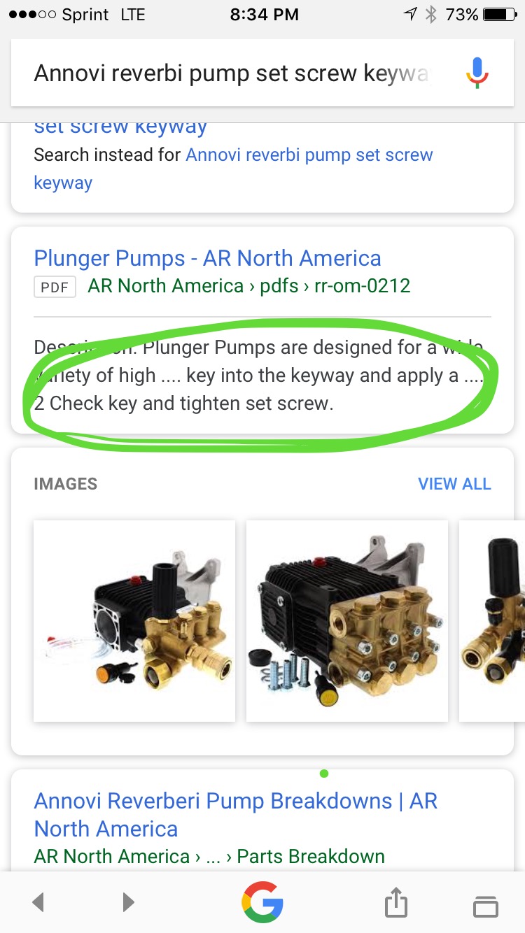

I didn’t deep dive into the PDF, but there are some clues here.

Sorry man. I really didn’t think you were asking a question. Thought you were just complaining lol. I don’t know what you have going on but if the keyway is moving around on you temporarily magnatize it. Couple of ways top do that but i know ypu can or will figure it out. Post a video. Presentation withoyt demonstration is merely conversation
Put down the Tequila bro! I thought I was very precise about my question.
Let me reiterate…does it matter where the key sits it they keyway as long as the set screw is tightened and loctited(blue) on it?
You have to start with the key at the end or beyond of the crank keyway to get the pump to slide on. All I am saying is with this pos AR you have to slide the key back at least halfway in the keyway for the set screw to get a lock down on the key.
