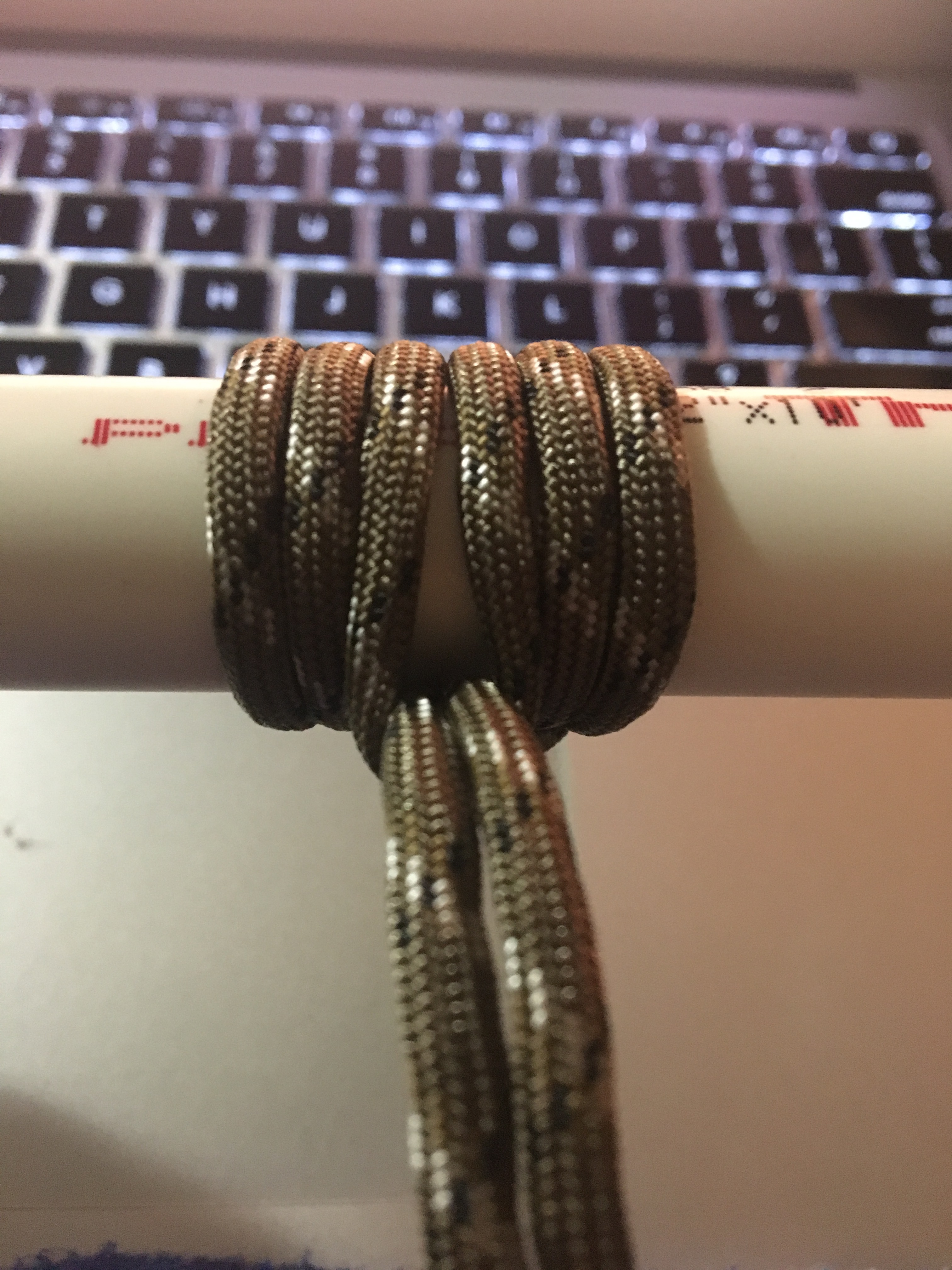

I have some experience in knots thanks to the navy. @zfranks I already Googled it and have the paracord out. I appreciate it though!

Close. Now try experimenting with different numbers of wraps (friction) to see what’s easiest to work with.
@squidskc It’s hard to explain without a picture, but you have to dress the knot so that the looped section is to the OUTSIDE of the knot. (It’s inside in the picture you posted)
Please let me know if that explanation makes sense.
