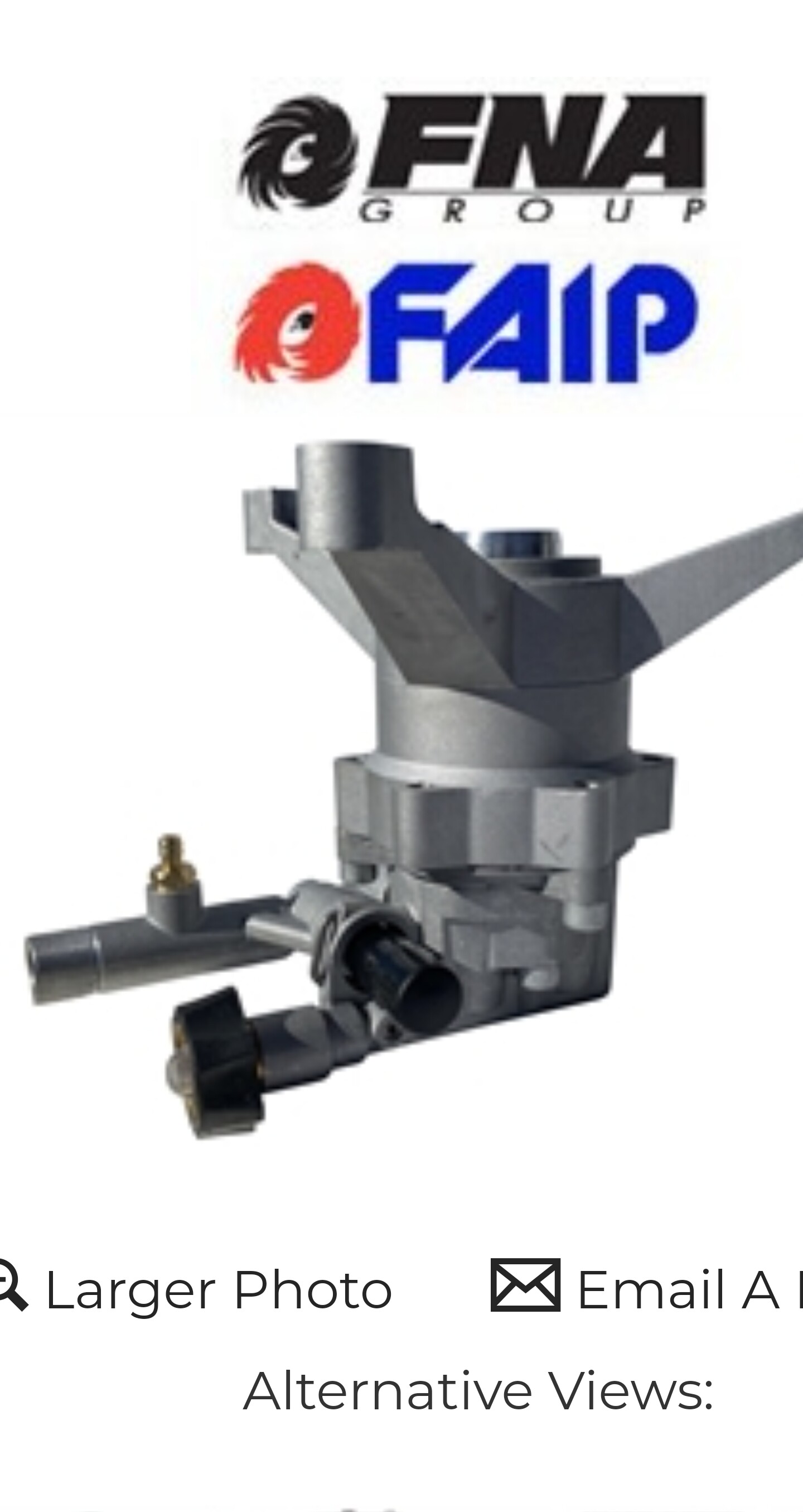

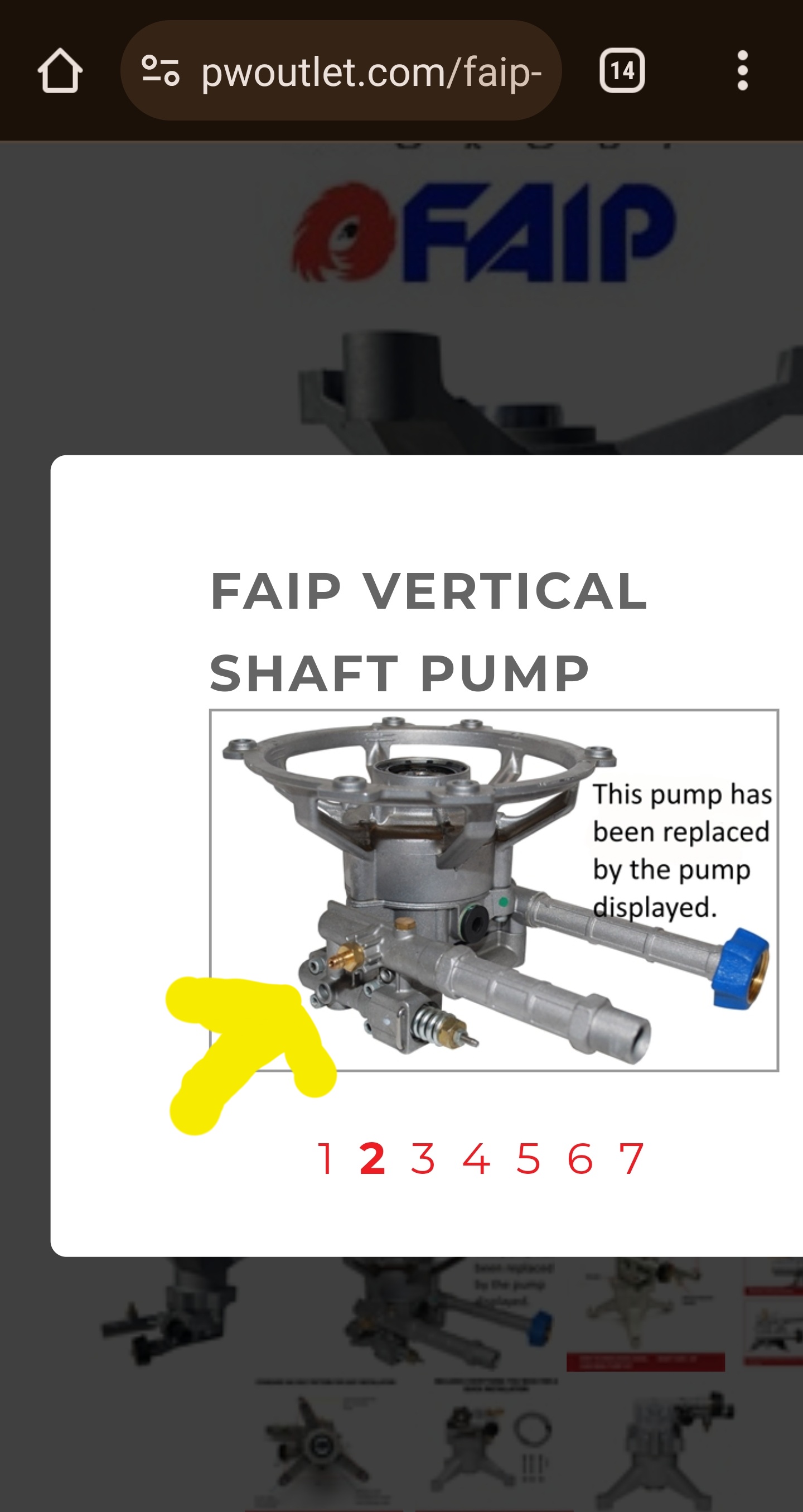

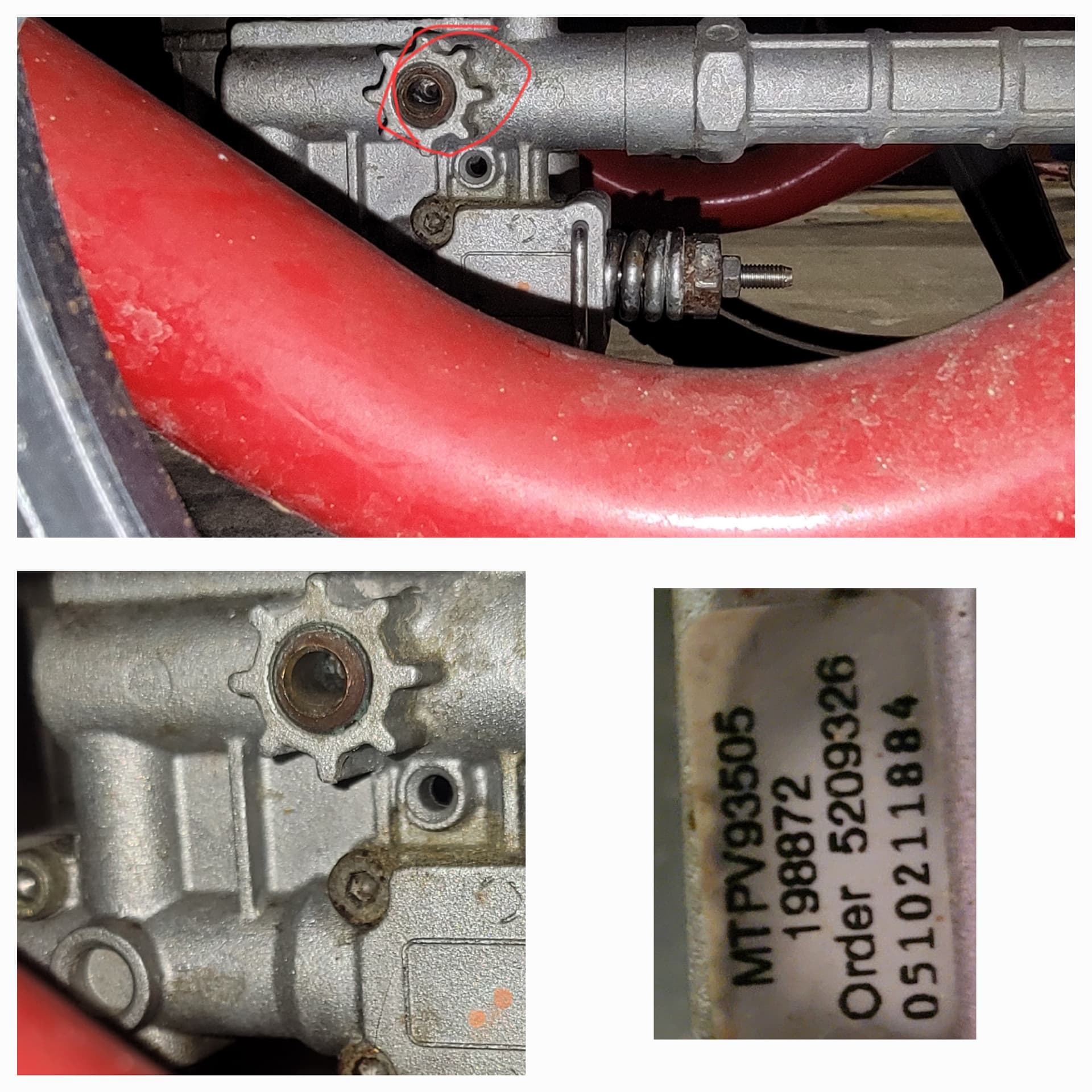

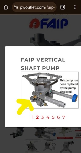

I have a craftsman pressure washer that is leaking from a port(?) on the pump manifold. I have taken the relief valve out and it seems fine. The problem is that this looks nothing like what is pictured on a diagram of the pump, it is not threaded on the inside, so I’m very confused.
The water shoots out as soon as I turn the faucet on and only stops when I have the trigger on the wand engaged, and shoots out again as soon as I release it. Could this be caused by the o rings on the pump, or just a faulty manifold? Pictured is where the water is shooting out.

that hole is where your thermal relief valve was. seems it broke off.
No, thats on the other side and water would not go through there during the bleeding process because the motor isn’t running to build pressure. But thank you.
This is what had me confused, my pump is older and doesn’t have the chemical injection port. Regardless, im sure i need the diaphram at minimum which pretty much answer my question. Thanks!
