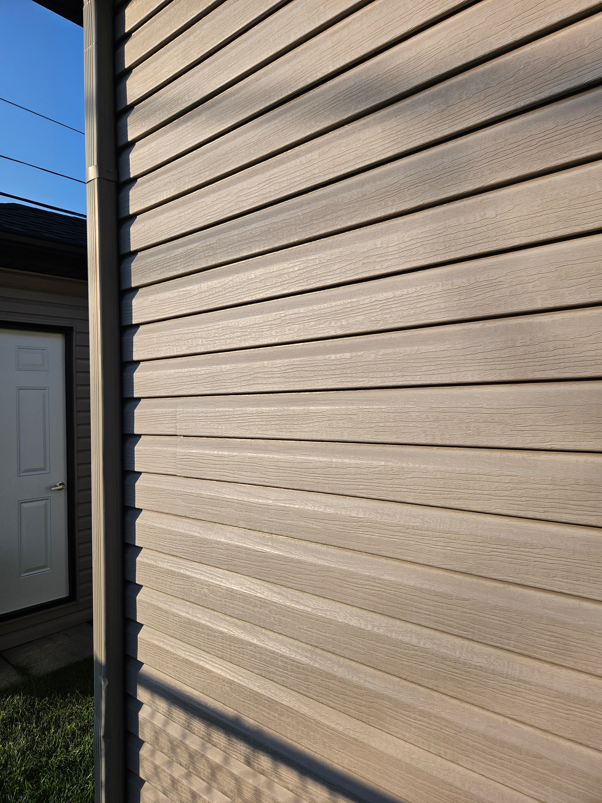

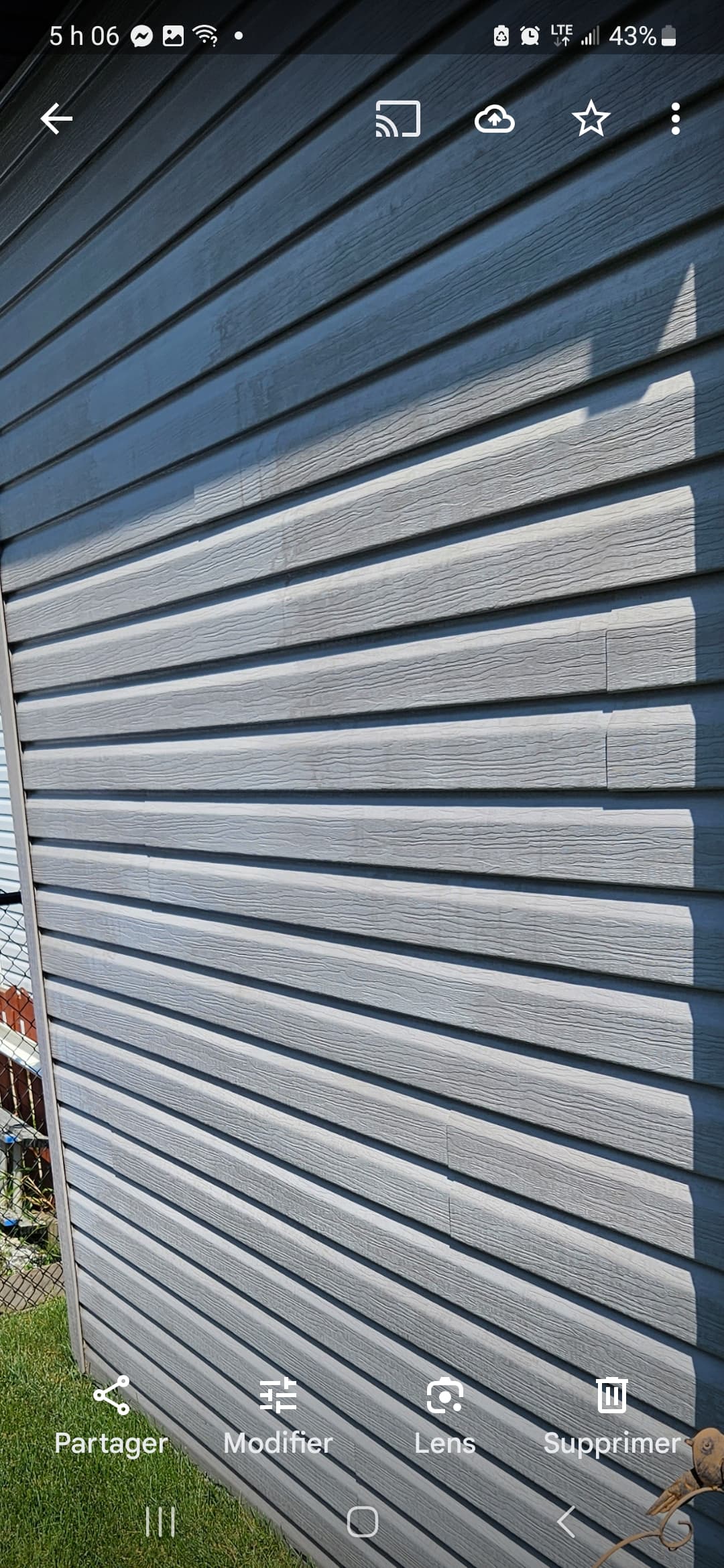

An ant extermination company called us to remove stains from their insecticide (Dragnet) that left streaks on their customer’s vinyl siding. It’s on the south (oxydized) sides. I washed with housewash mix first to remove other stuff (spiderwebs etc) then tried: degreasers, then cleansol bc. They light up but are still there. Any ideas?

Are these before pics. House still dirty. How did you use the Cleansol? You do any scrubbing or wiping. Give some details
Yes, they’re “before” pics. I tried 1 part cleansol and 3 parts water, up to almost 50/50. Lots of scrubbing.

Thanks for investigating further, the owner said the stains came back! I’ll go take a look as soon as i can, but really out of ideas to try. Maybe steam?
