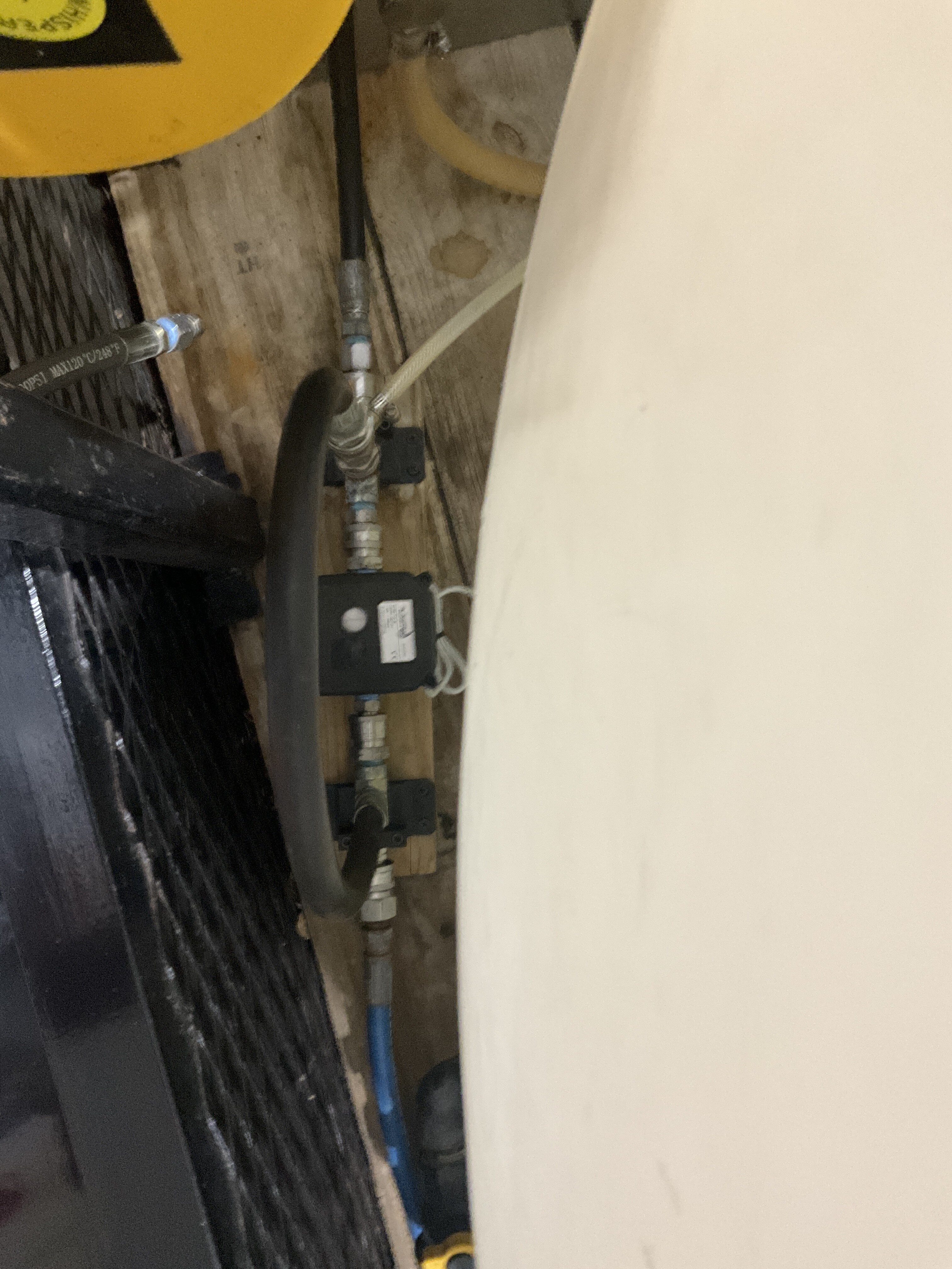

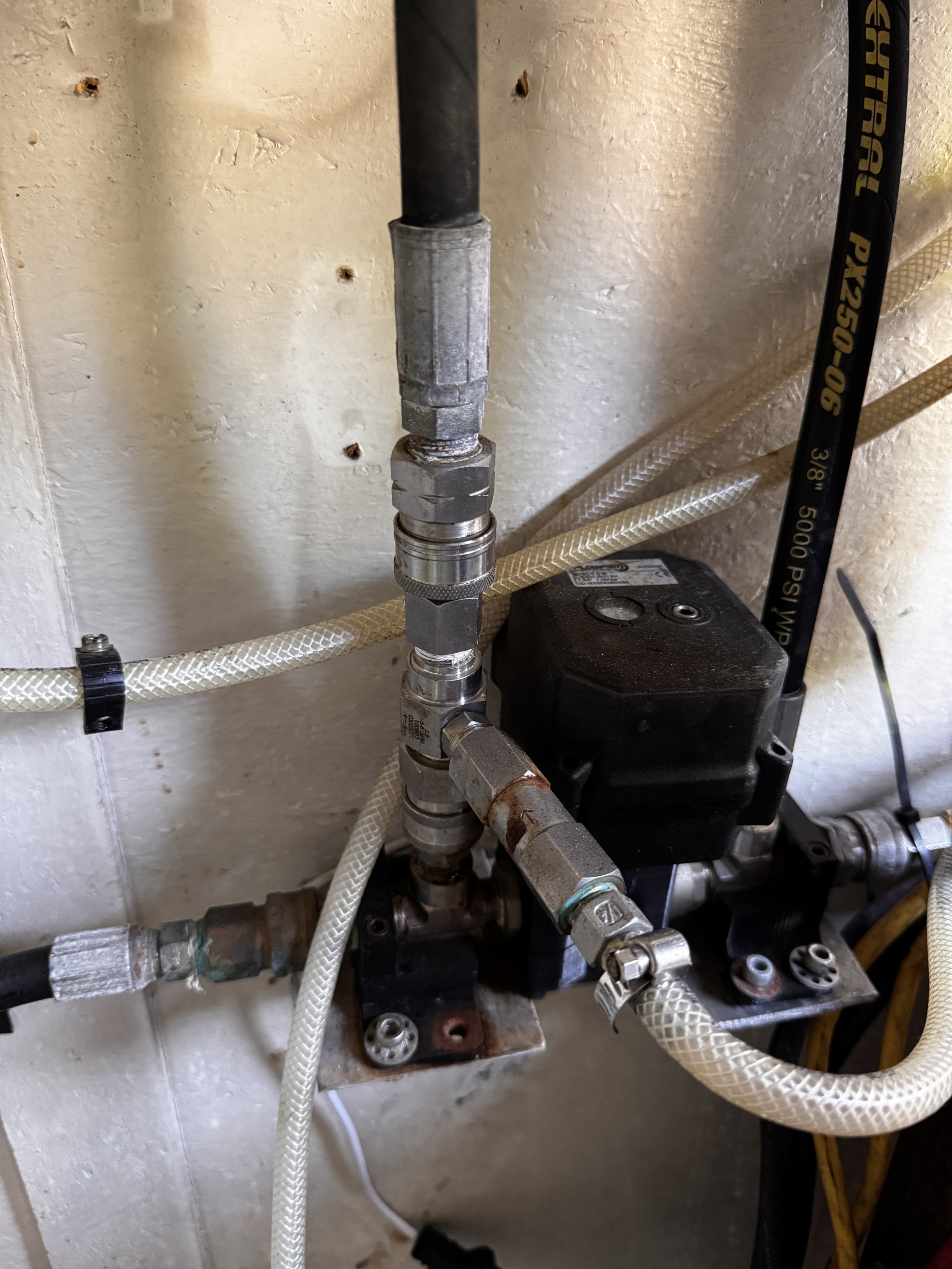

Should the injector be on the side of the pump or the other end of the bypass loop? Having issues with injector still drawing with the FlowPro in ‘rinse’ mode
My injector is after the flowpro…right before my reel.
Mine is on the pump side of the loop.
Mines on the Pump side
Mine just like @Kentucky1234 's
Mine is on the non-pump side… part of me likes to think that having it there is a precautionary “just in case” if any chems were to backflow, they wouldn’t make it up over the hump. Not sure how realistic that logic actually is, though.
