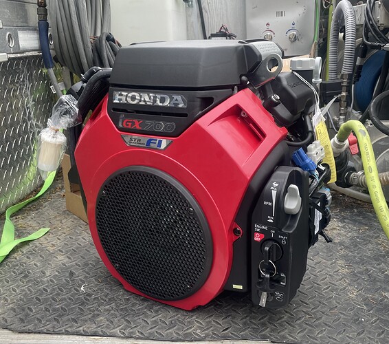

You can’t do that to a Honda, that’s rough man.
It’s mine. I paid a heck of a lot for that thing, and I’ma do with it as I please
I’d have to agree… Lime green on a Honda engine? That’s just wrong.
