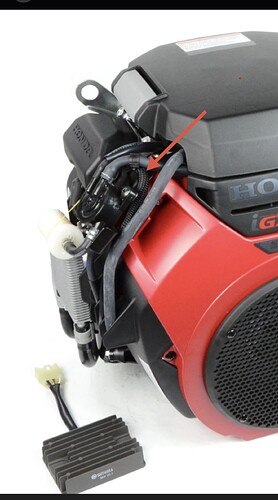

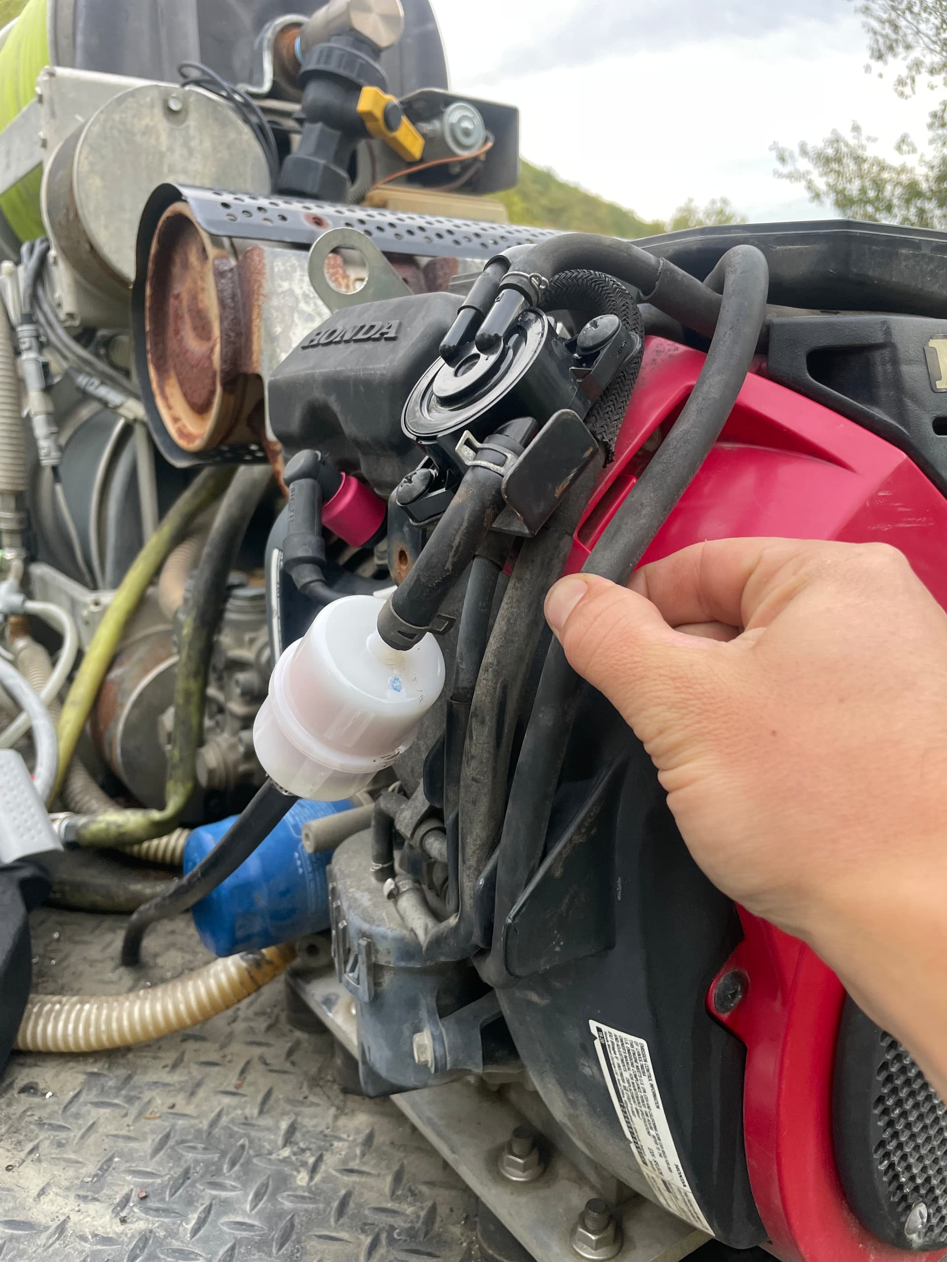

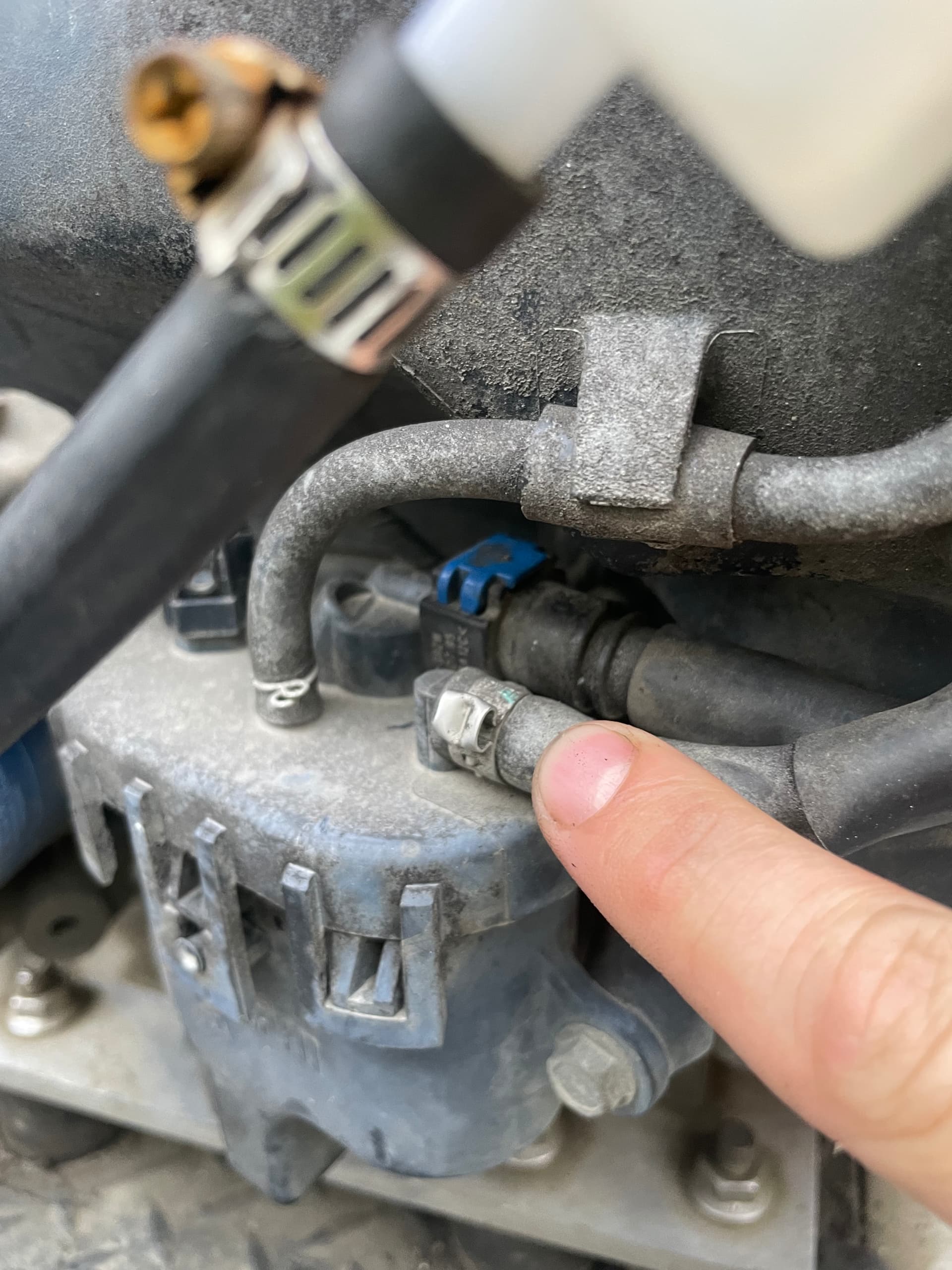

would help if I had the Manuel for this motor but after trying to complete this engine that was tore down when I got it. I can’t figure out where the top of the vapor tube goes to. (Braided tube in picture) does anyone happen to have any pictures or videos of where it goes. I can’t seem to find anything online. Any help is appreciated.
I have an iGX700 but I assume it’s the same.

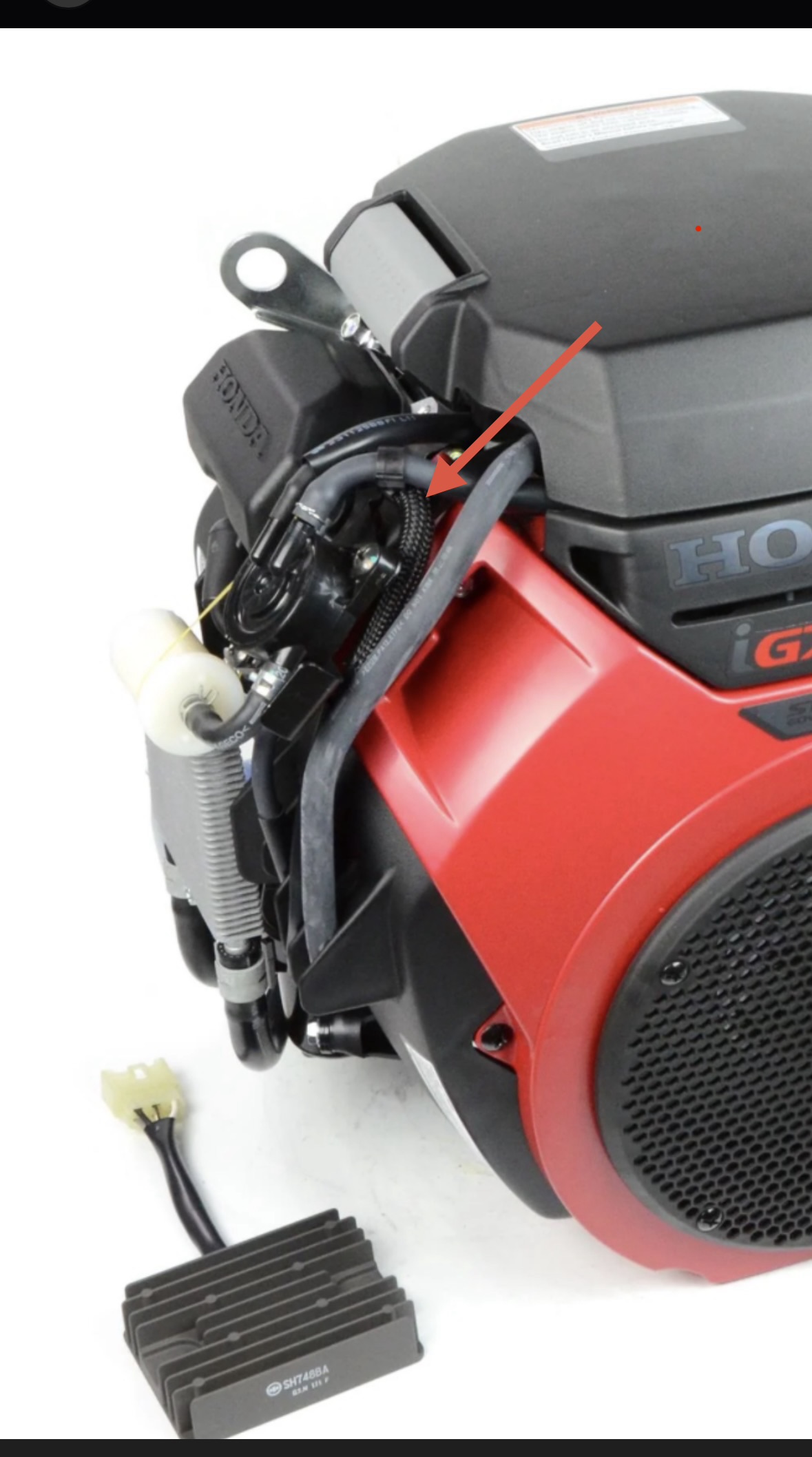

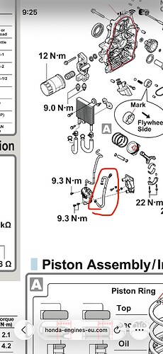

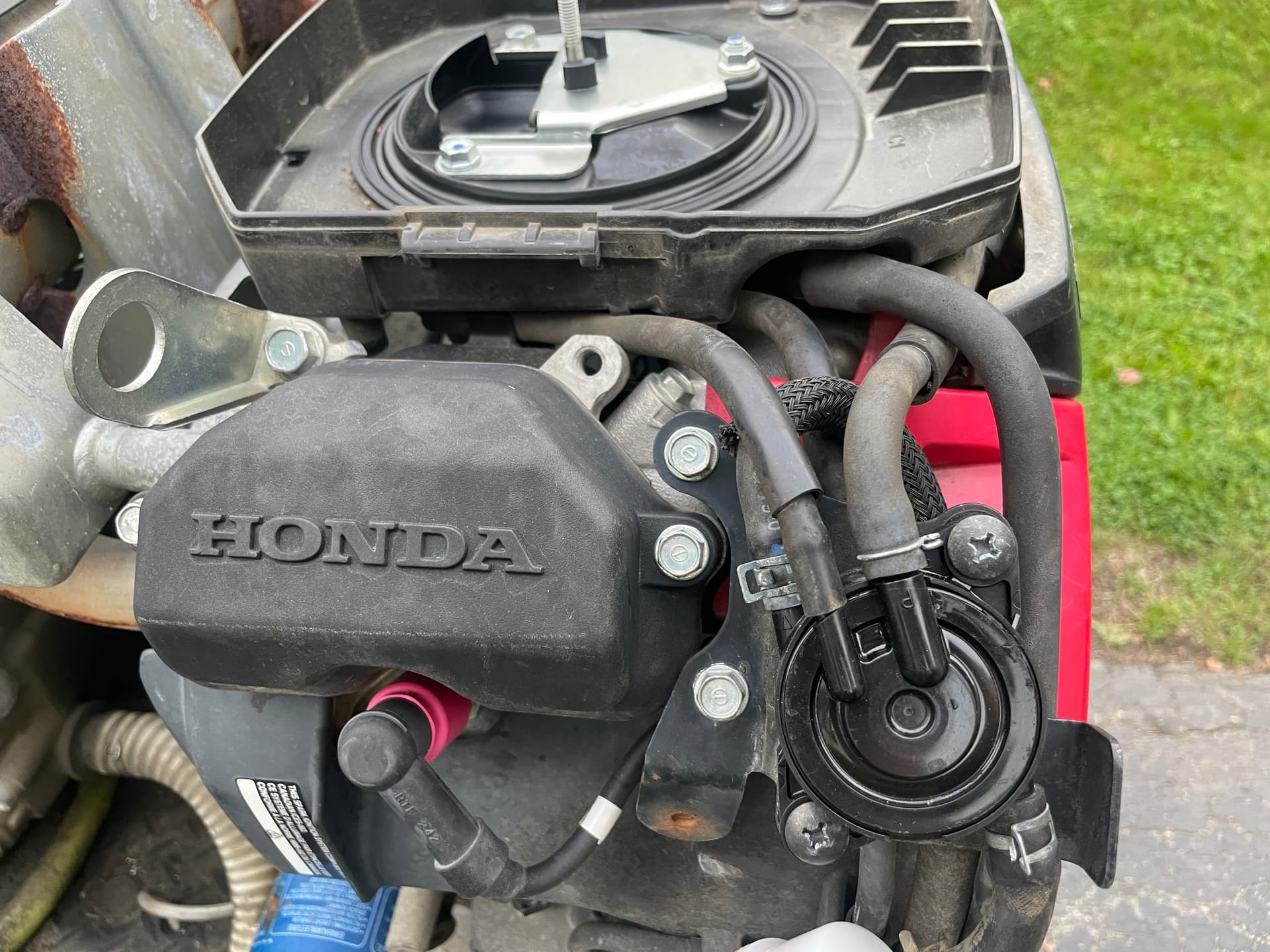

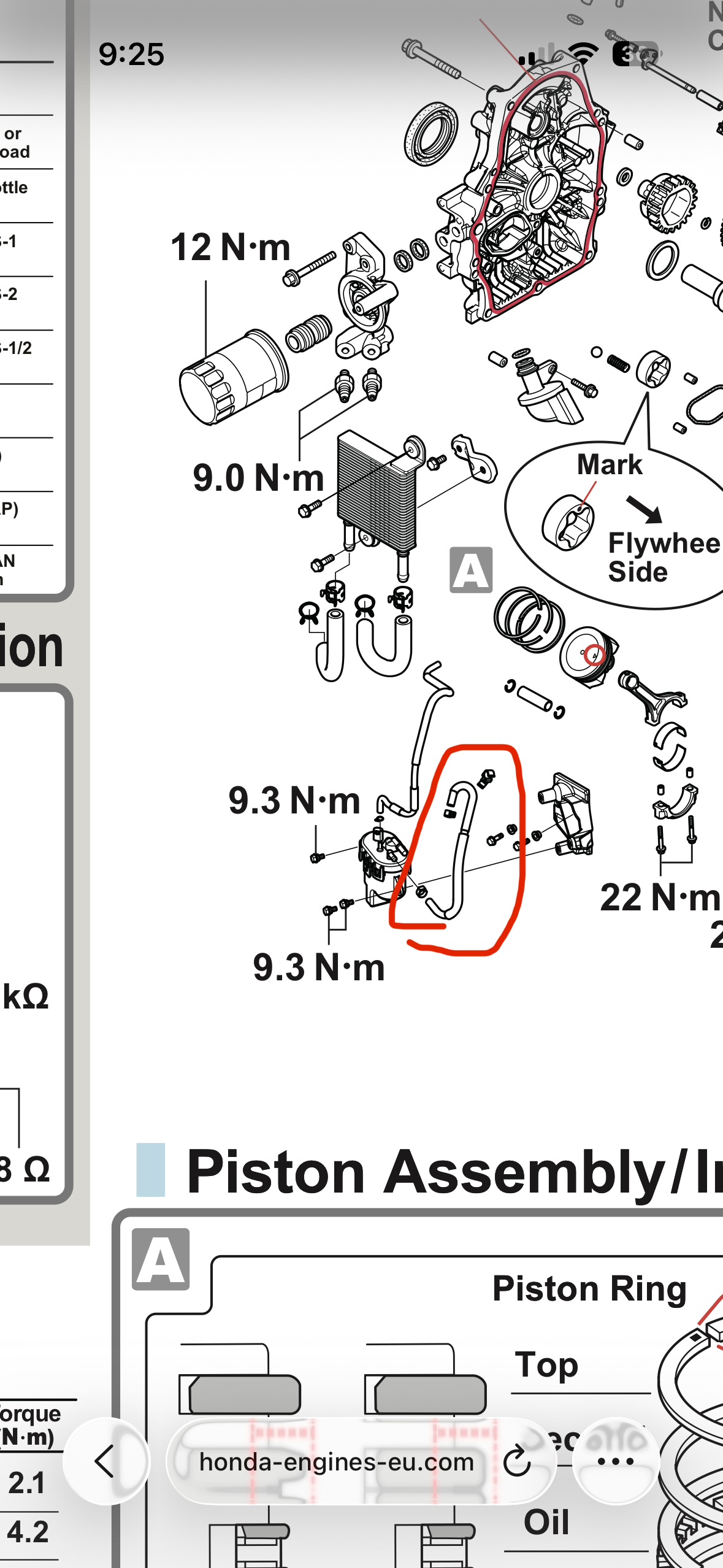

It doesn’t look like that braided line is a vapor tube. The one above it goes to the underside of the airbox. The braided line goes to the high pressure fuel pump.
You’re a life saver! When I bought it from my buddy it appears that he threw on fuel pump that didn’t go with it so there was no spot for me to put on the braided line. Your pictures answered my question so I really do appreciate the help! I’ll order another pump and see if I can finish it off!
