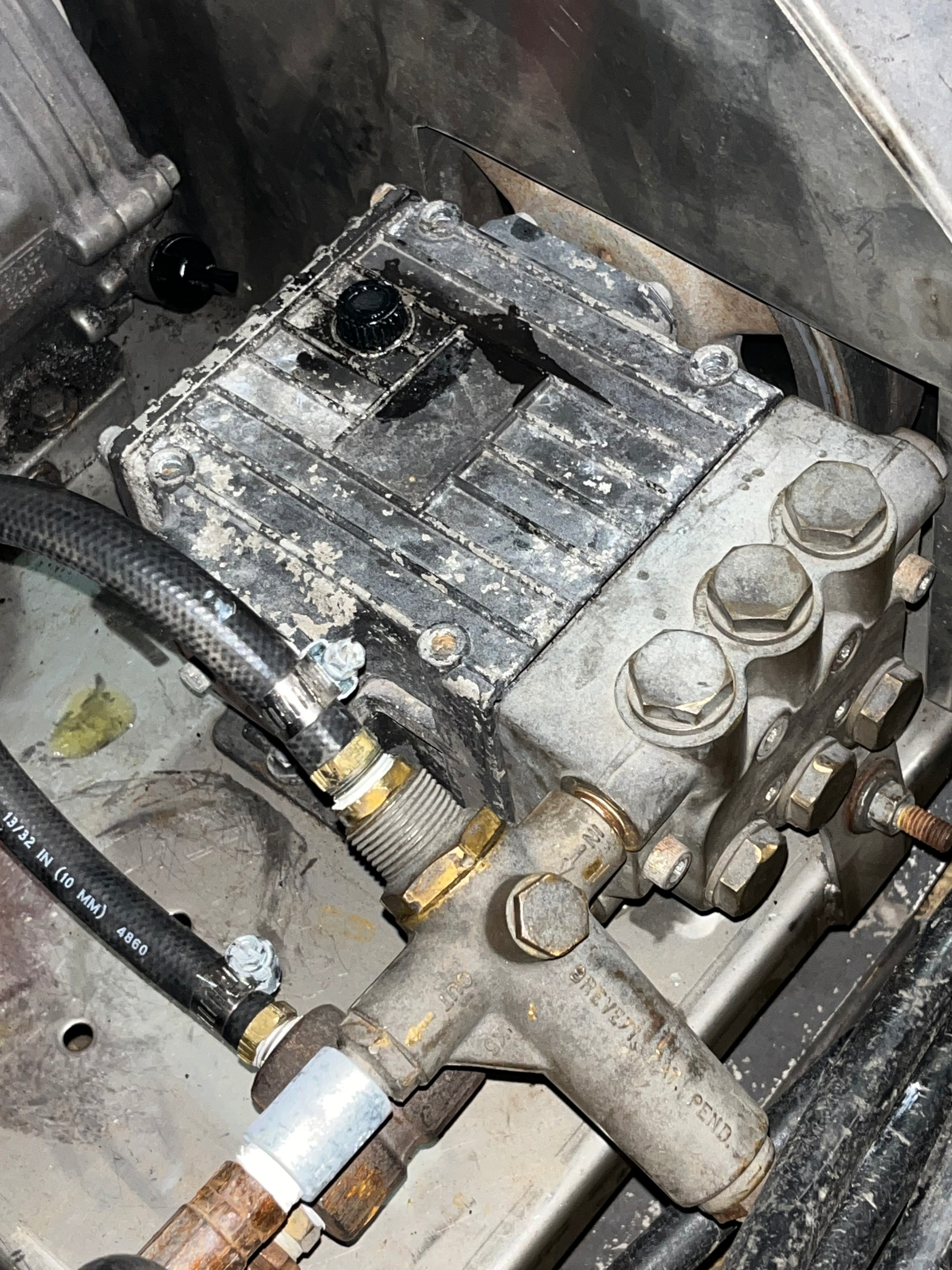

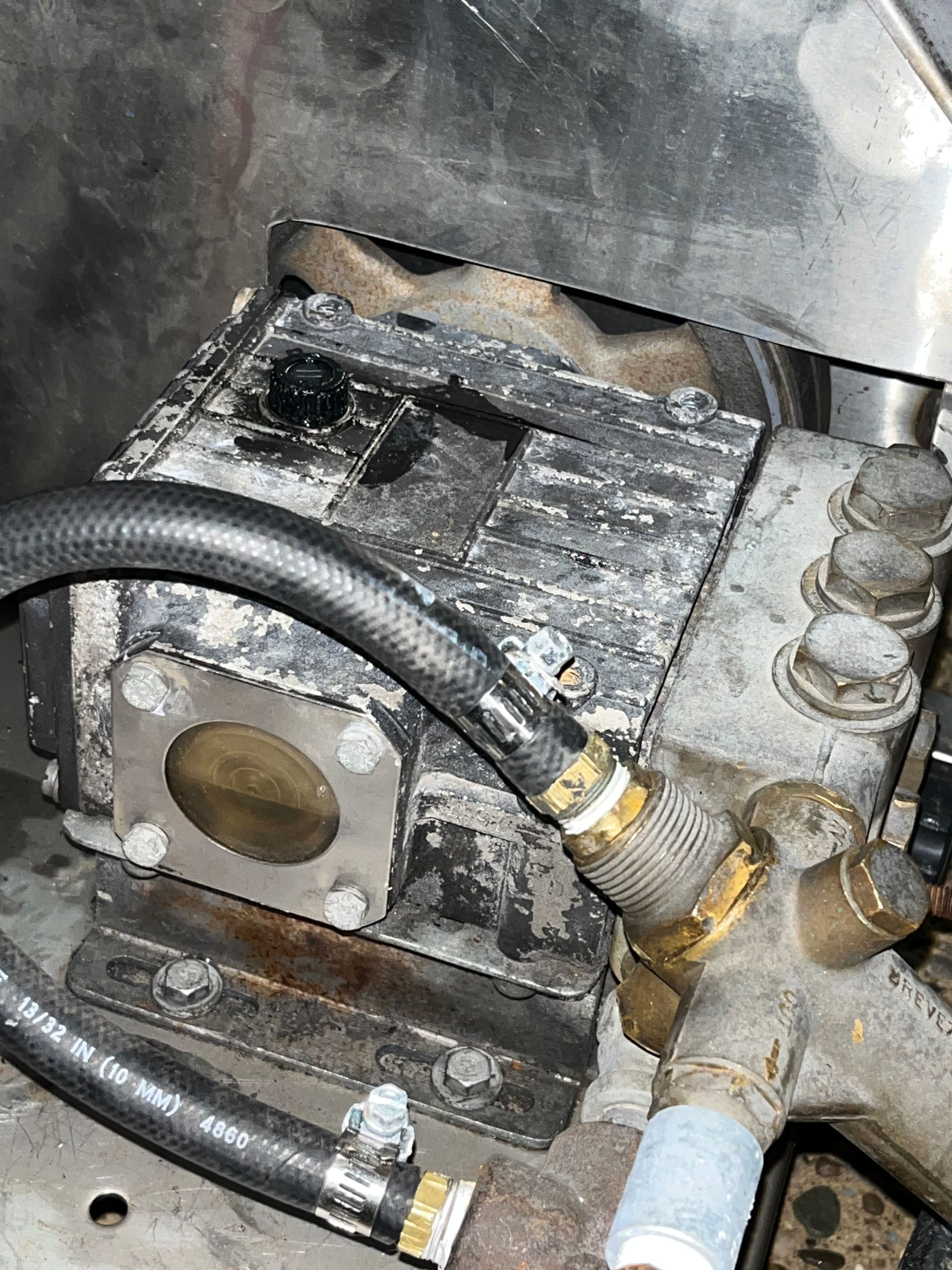

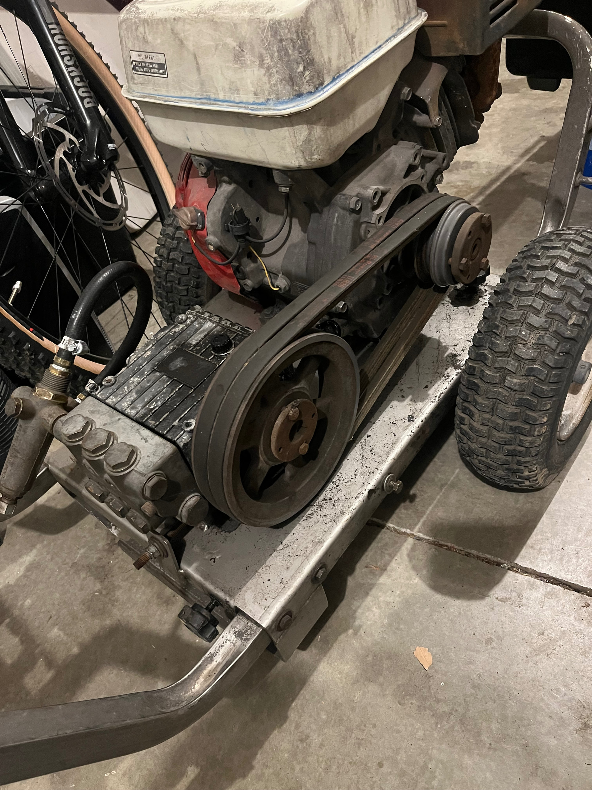

I just picked up a belt drive unit pretty cheap in hopes of flipping it. The motor and pump have milky oil but the previous owner probably left it in the rain.
I drained both oils, motor started finally. Can anyone identify this pump, the label is MIA
Oh and when I flip the fuel lever the bowl overflows and pours out where the black carb spacer attaches to the motor. I’m thinking float valve but open to any suggestions
Looks like a Giant P200 series pump… but not sure what model.
Giant P200 Series Brochure
Thanks for the link, as this is a GX390 is it a pretty good chance this is a 4gpm minimum? Pump looks pretty small.
Looks like it’s FUBAR. Hooked unit up to water today and fired up the motor, oil mixed with water almost instantly. I have a bead on a used 4/4 so we’ll see how that goes.

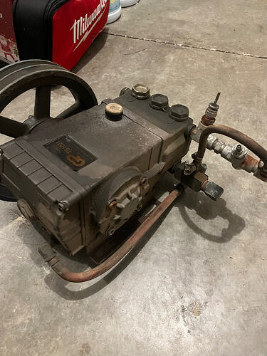

Here’s the pump I bought yesterday. Can’t say as I recognize the fittings, he wasn’t sure what it came off of. Note the shader valve like a bicycle tire.
The flywheel is bigger than the current one too so looks like I’ll have to change that out as well or add spacers under it somehow.
Only time I’ve heard of using a schrader valve was to winterize the pump. Supposedly a lot easier to blow air or antifreeze through the system that way.
Exactly
