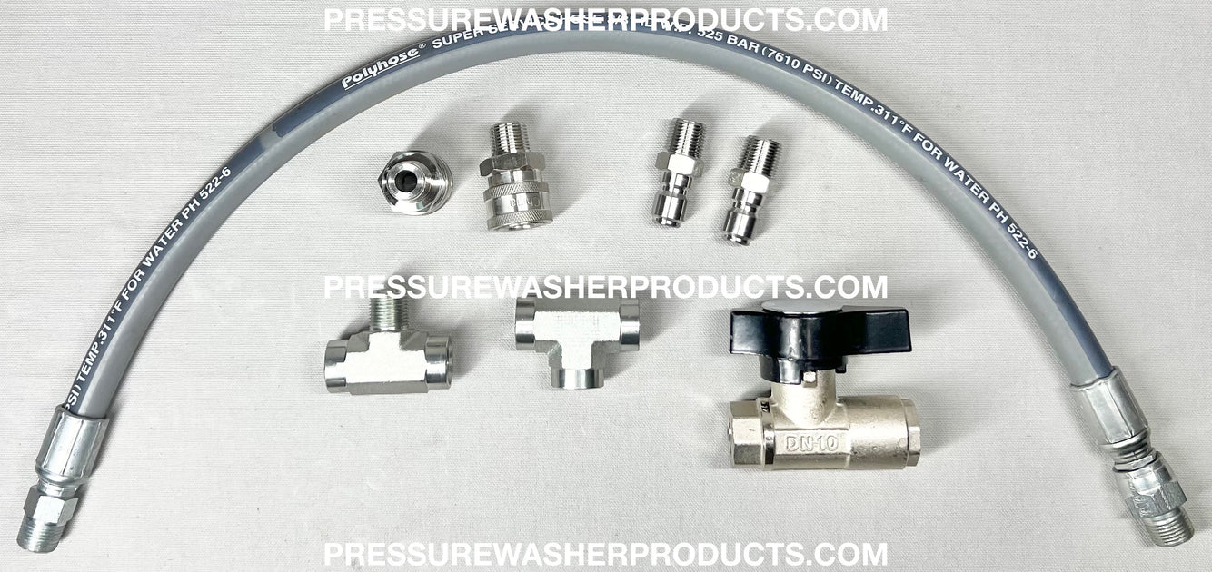

I have a injector bypass on my 8gpm machines but my smaller machines do fine without them but they’re not hard to build you can buy a kit here
