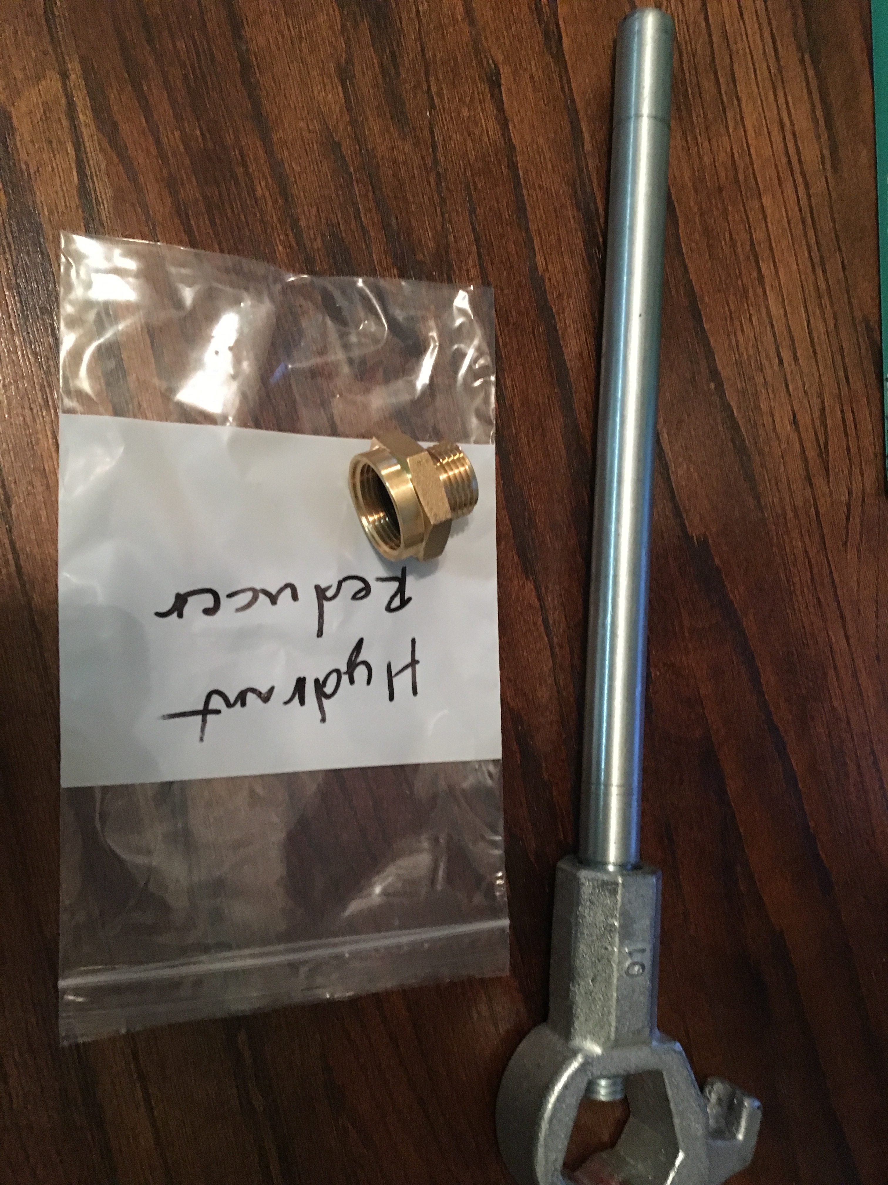

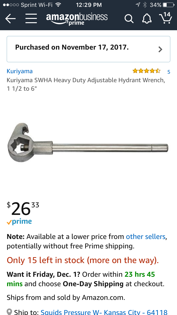

The water district told me to pick up a wrench and one of these fittings because some came ready for a garden hose and some needed this and it was a crapshoot. We got lucky with one that was ready to roll.
They gave us a jack stand to support it with and the last one they didn’t. The jack stand was too small for one of the hydrants so I’ll start carrying a large one.
Other than that, from my experience only using hydrants twice ever, it’s pretty easy. You’ll pay a few hundred dollar deposit. The most recent water district charged a $5 daily rental fee and will refund the deposit minus any water used and daily fee or I’ll get a bill for a few dollars for water.

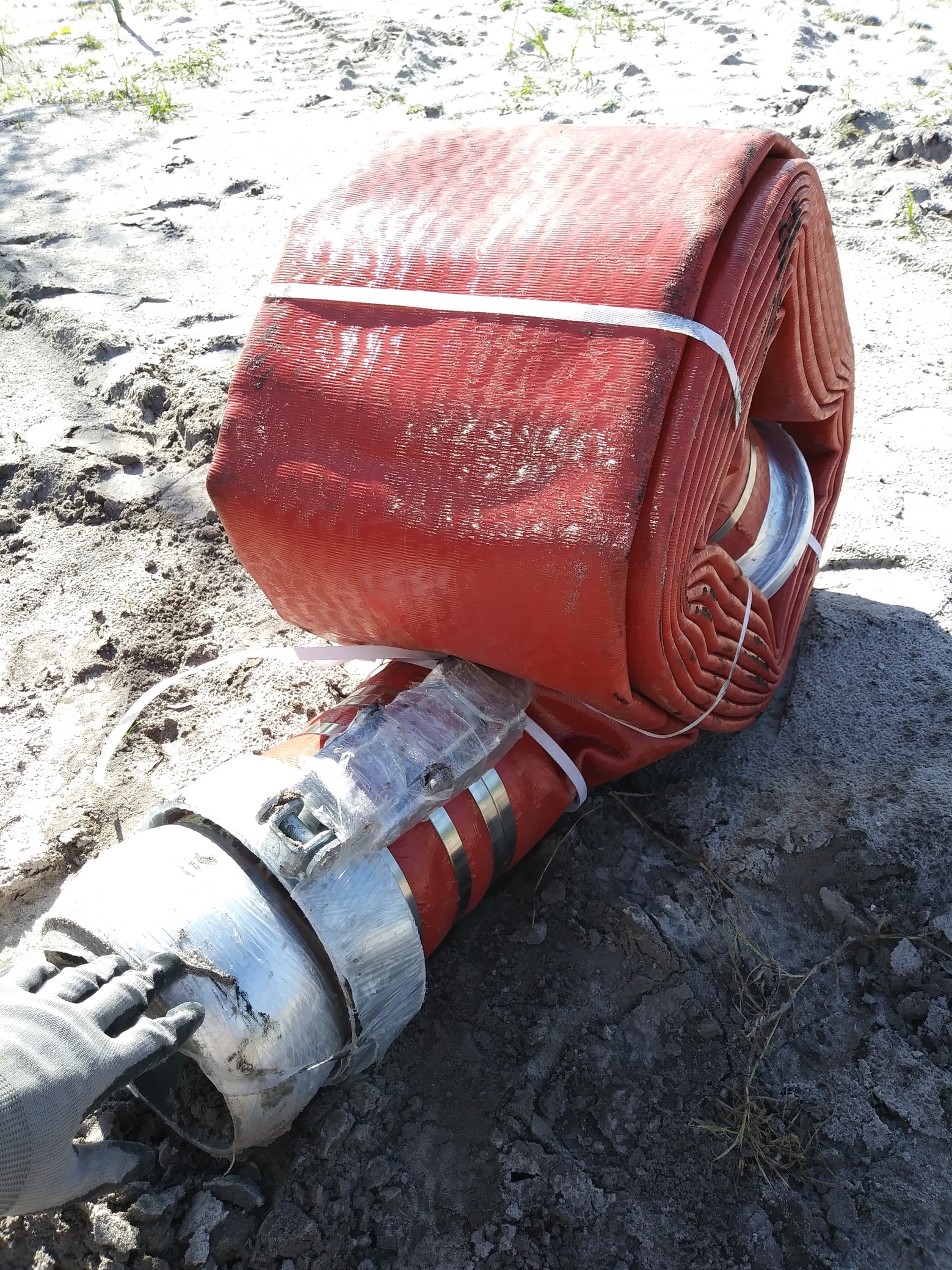

You can put an adapter on it and use regular old hose IF the meter has a ball valve on it to choke the flow. You can’t choke it at the hydrant as I learned.
You can get decommissioned fire hose too if you want and install a fitting on your tank if you want more flow, but I’d still recommend choking it with a ball valve of some kind so you don’t turn your tank into a bomb. @Innocentbystander would definitely get a text from me if I had this question so I’ll bug him here to see what he says.
