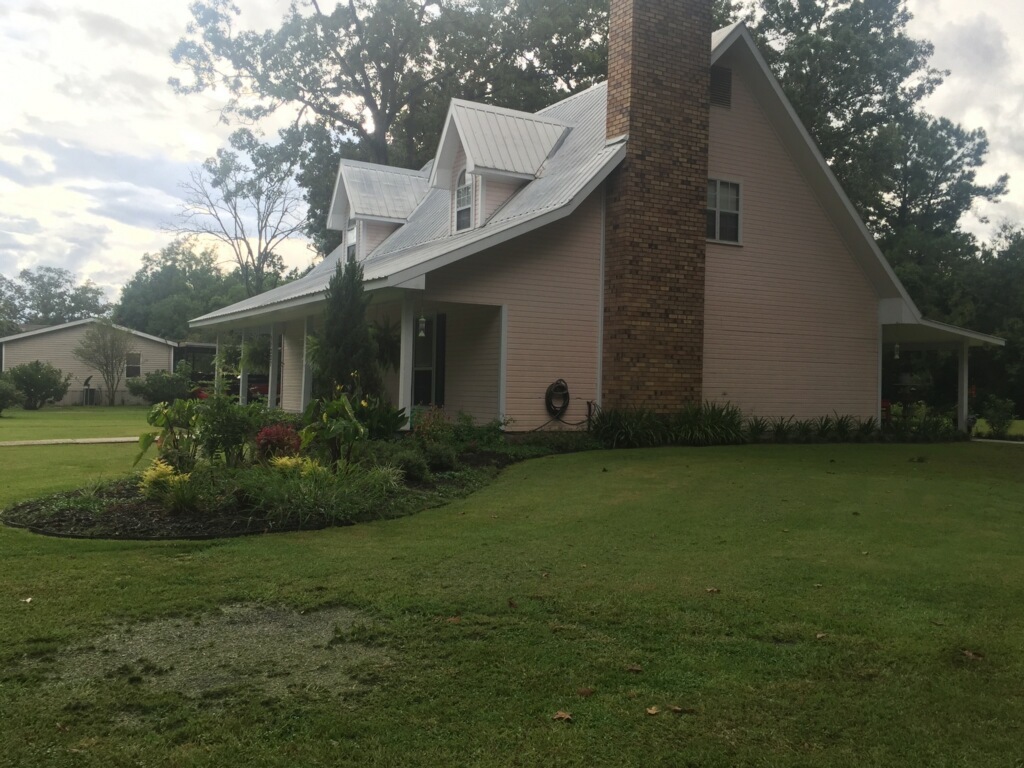

Here’s a pic of his spread
I’m just curious, what would the procedure be for cleaning a roof like this?

I’m guessing your do more landscape / lawn-care work and PW is a side line thing? If that’s the case I would suggest the following. Find a local guy and build a mutual working relationship. Get him to bid the job to you with a discount built in, then you present it to your client at the un-discounted rate. Let the other guy do the job, you be his helper and protect the landscape, drag hoses, whatever, and learn. He in-turn will help you get business down the road.
I had a landscape guy turn me onto a job for one of his clients. I bid it like normal and cut him a 20% break since he would be doing the billing and processing. A week later I was on a job that had beucoup hi-end landscaping and I called the guy to see if he would come be my ground guy. So while I’m doing the roof he’s keeping the plants watered and protected and being a good landscape guy he pulls a couple of weeds, just a few big ones ones. The homeowner pulls up and is talking to him and she finds out he’s a landscaper and they work out a deal to redo her beds and a sorta spruce up kind of thing.
So when we are done she’s all “like I didn’t know you were going to hire a landscaper to protect my stuff, Like that is so professional.” He gets a job out of it, doesn’t charge me for the couple of hours he helped me in thanks for hooking him up. Of course I took credit for it, it was all part of my plan.
Moral of the story, it’s not wise to ask a Dentist to take your tonsils out just because he works in that area anyhow. And before anyone goes on a rant about not helping others to learn, take a close look at this house. It’s a steep pitch multi slope metal roof with some unique complexities. Shooting this roof is going to take serious experience and / or some 3 story ladder work. The yard appears to have some slope in places making ladder work tricky, no gutters, decent landscaping to protect, and whether it’s vinyl or painted wood siding to hot a mix isn’t going to end well if it gets over-sprayed.

I have a 12V system I use to shoot cleaner onto moldy roofs/siding/grounds etc. With a 25 degree nozzle I can spread cleaner up to 12 feet with the zero degree nozzle I can shoot cleaner up to 30 feet. Then I rinse with a 1/2" hose and the results are usually spotless. If there is the odd spot that retains algae/mold/lichen I have a scrub brush mounted on the end of a 24" pole for that. I have all the ladders up to 36’ with roof standofffs and leg levellers.
Very simple job as long as your ladders can be set up in all the right spots so your stream can hit all the roof. I think the back would be most challenging because you have to reach over that huge canopy.
