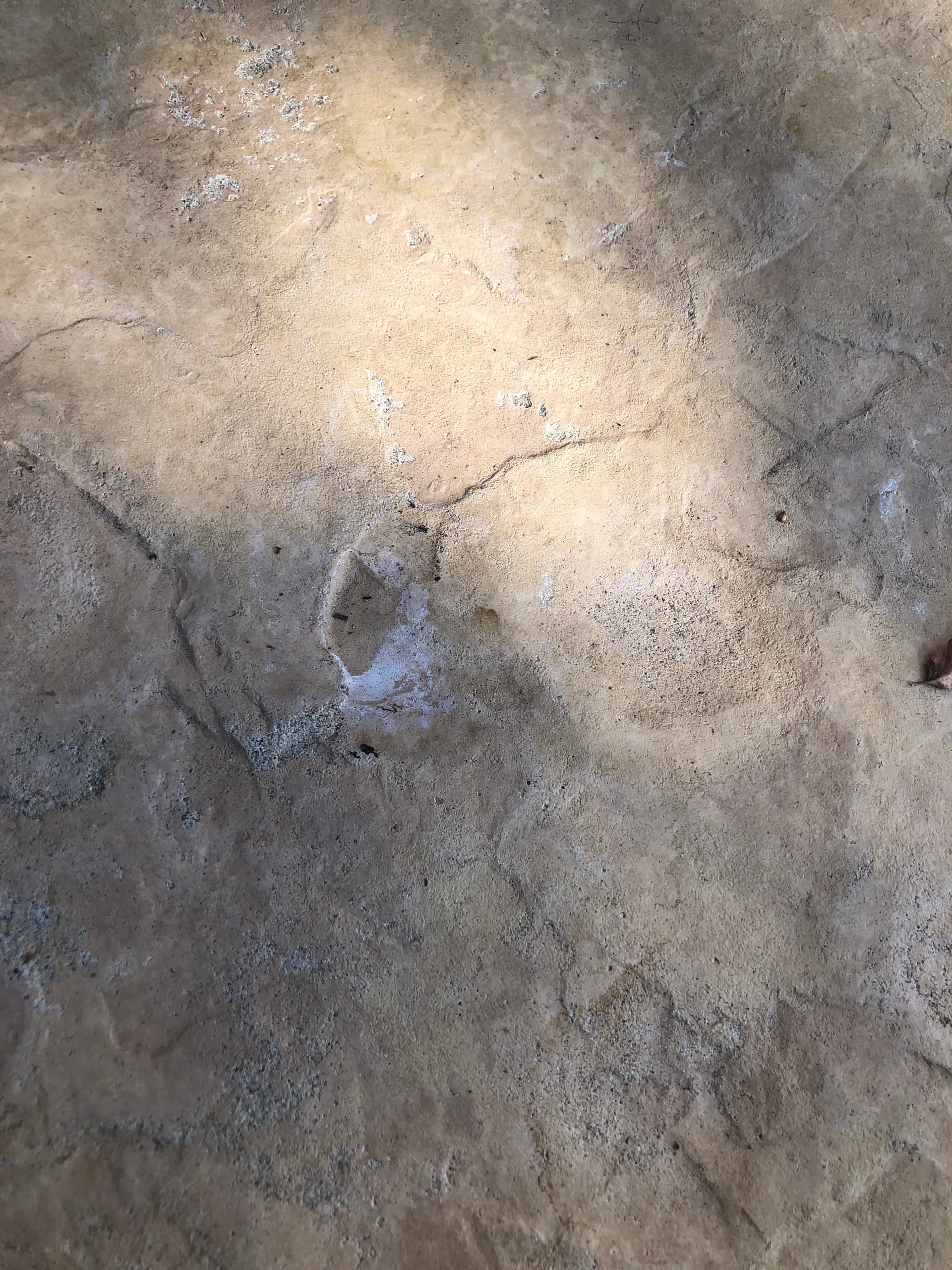

I accidentally applied a water based penetrating sealer to a customer’s stamped concrete. It resulted in small white patches left on the concrete.
I tried using an Efflorescence Remover - nothing. I tried using Muriatic Acid - nothing. Anyone know how I can remove the old sealer?

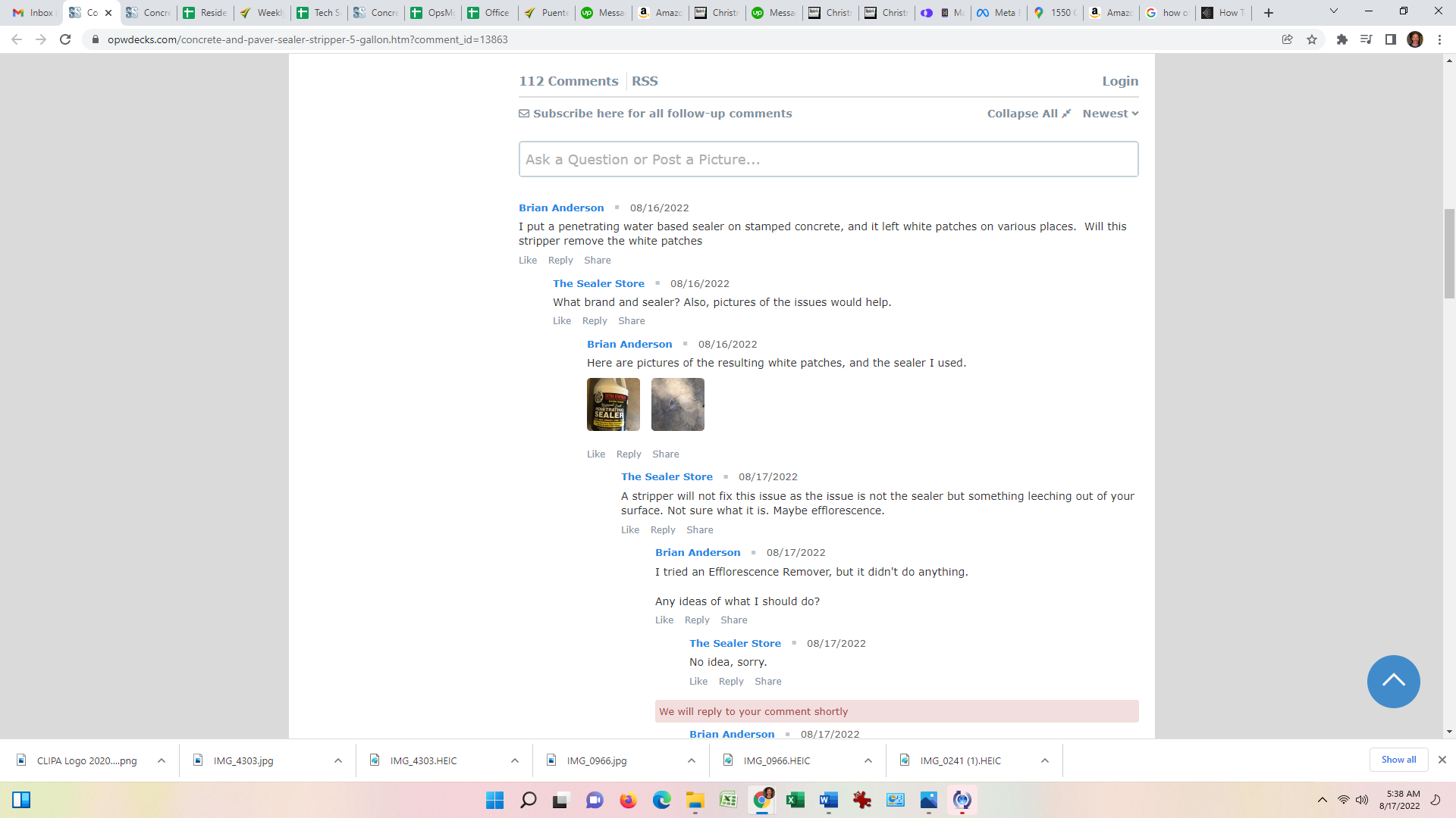

That is the sealer I used. I also included a picture of the white patches on the surface of the concrete.
Would a turbo nozzle damage this stamped concrete. It has a yellow/tan appearance.
This is an answer I got online.
Your thoughts on this?
usually stained coloring is integral, but yes that would definitely need to be figured out. If it’s post-stained/colored…definitely a no-go on the turbo (and probably on the stripping chems as well…)
It’s not efflorescence or anything. Listen to @JAtkinson he’s right
