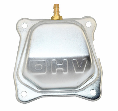

You can run a ported carb spacer or a ported valve cover assembly. For the smaller engine j recommend the valve cover. I ordered a carb spacer from NR racing and it fit but the bolts were not long enough.
I will be installing the valve covers soon and running lines to my 22 gallon Boyd welding tanks.
If your going to do this. Drill and tap the the block. Please do use these kits they are unreliable. They are made for the cart world. Those small engines get tore down 10 and cleaned ten times a year. They also run for a short time. You will have problems
