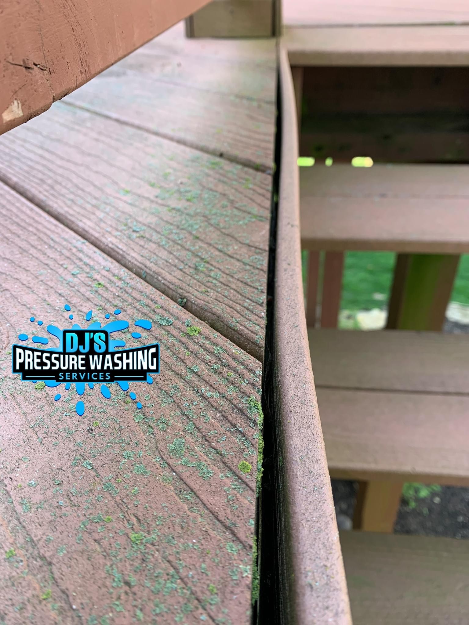

Here are the results from the wood cleaning ! I was super nervous as this was a big project for me. Paid well too! I learned a lot from this and I’m happy I did it
!Ready for stain
Excellent work
, amazing how it all turns out when you just dive in a give it a crack.
Looks great!
Looks good
