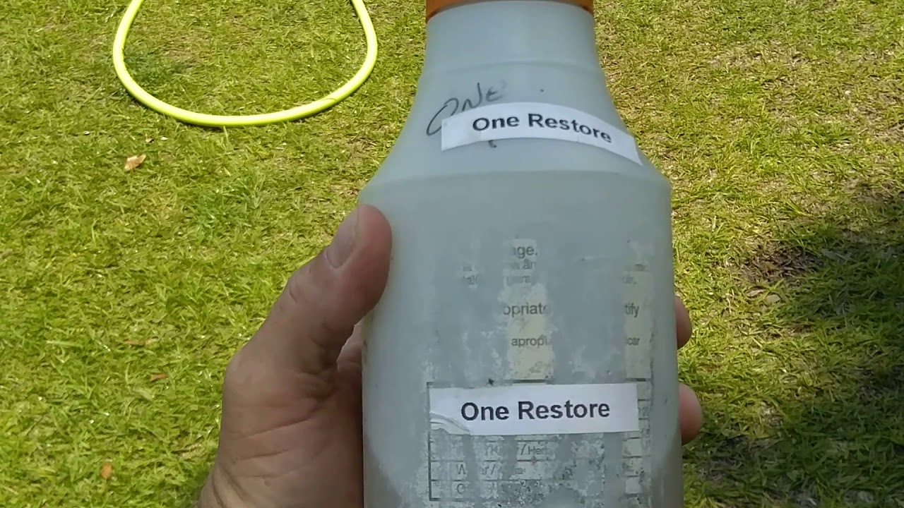

We keep deactivator (I know, almost no one uses it, but it’s a solid part of our processes), we also keep oxallic and Gutter Butter on every truck at all times. Some of the guys like to have BARC and Efflo on hand, and most carry a little One Restore.

Read the instructions on your products. One restore says to always do a test spot.
One restore instructions can be read here:
