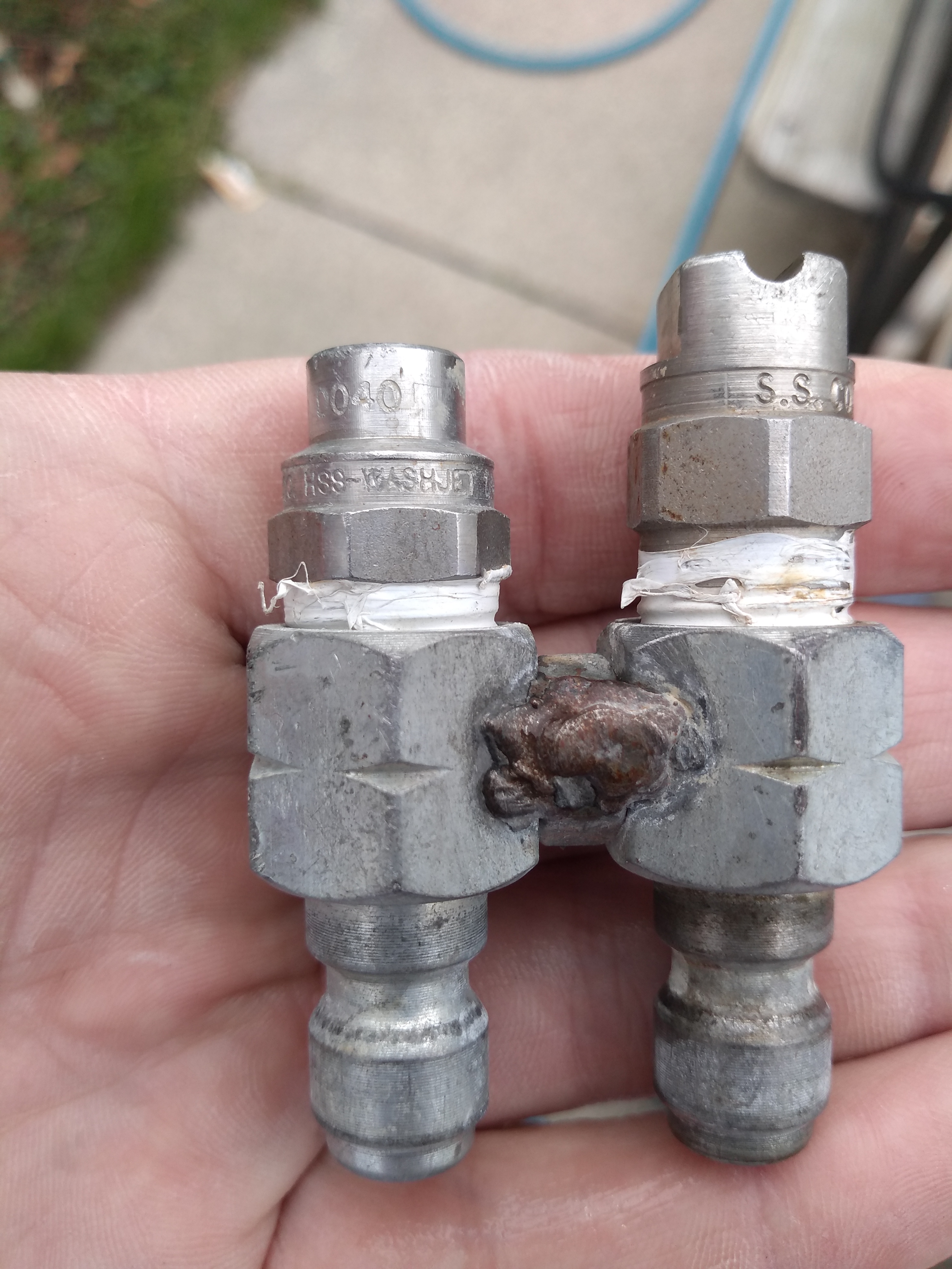

You’ve been told multiple times to not use the high pressure nozzles to stop the soap it’s gonna cause you a problem one of these days. Low pressure nozzles are all you need hence don’t use the 2510 and 0010 on your jrod. A jrod is just a nozzle holder. This is all I use to soap and rinse.

Why on Earth would I run 200’ of hose to the back of the house down a steep slope, soap a section, hike all the way back up the hill and remove the hose from the bucket, hike all the way back down again to rinse? Doesn’t that defeat the idea of an injector/proportioner and jrod?
Maybe houses are different where you’re at. We have lots of hills here, most are 2-3 story dropouts.
No one’s scolding, it should just be common sense to you at this point. You have to let the soap dwell so what’s wrong with walking back and forth to the trailer? @SchertzServicesLLC and a few others offer a remote to switch the soap on and off for washing a far distance from your machine. Why would they offer such a thing if everyone used their high pressure nozzles to stop pulling soap? I am actually sorry if you feel I am being rude. I just legitimately feel you should have a grip on this by now. If not just keep researching and listen to the advice you have been given in the past. It will all work out eventually. There is no need for high pressure nozzles for soft washing.
Ok thanks, I’m just getting conflicting information. The guys at Southside set me up with the jrod and even picked out the proper nozzles to use.

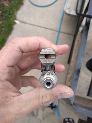

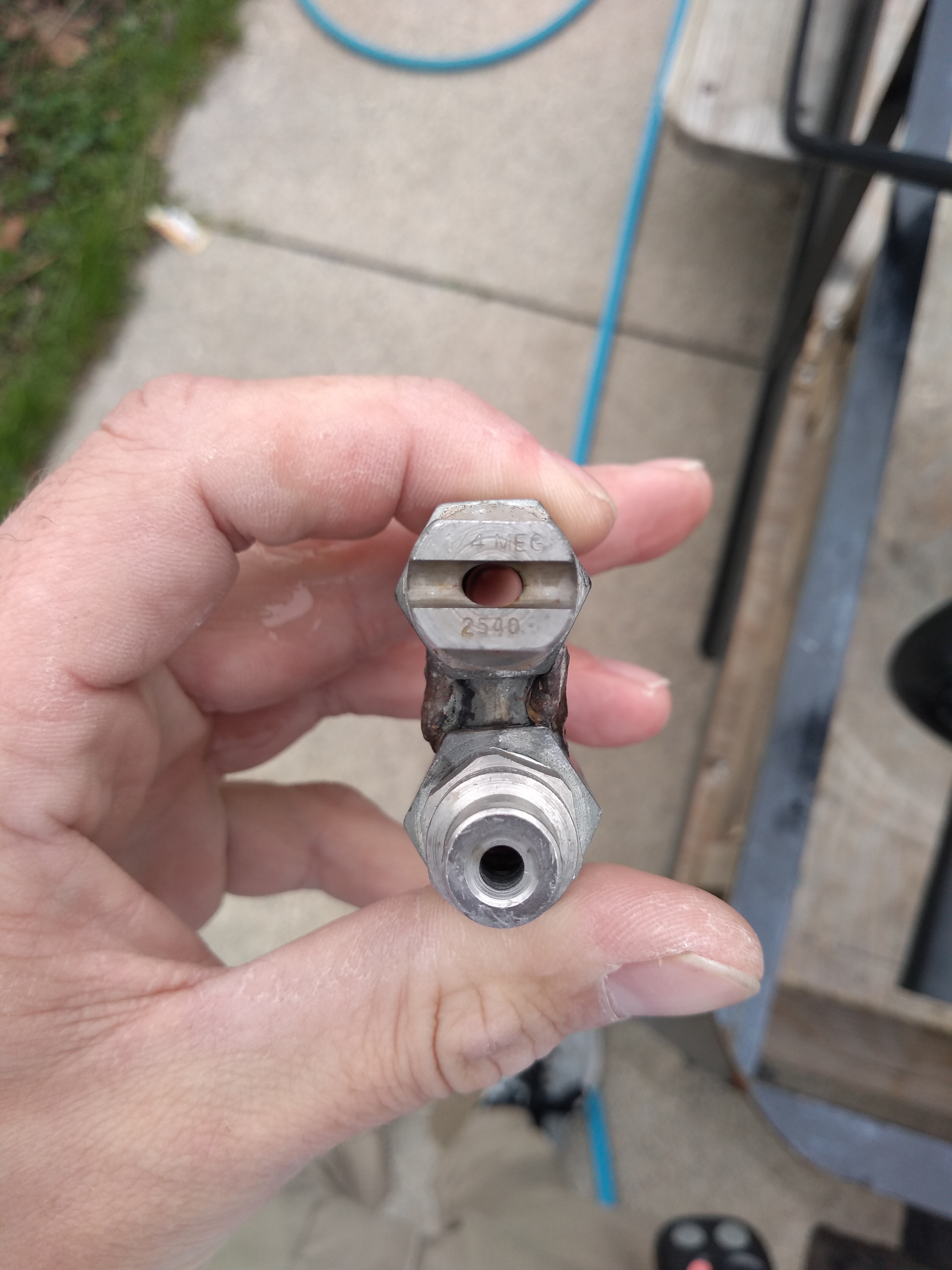

The guys at Southside and other vendors are in the business of making money. They are not users of their own products. More money to be made selling 4 nozzles than two. M5DS is not an Xjet. It’s an adjustable downstream nozzle with an old style admiral tip. M5 is in reference to Mike Baker and his 5 family members, Mike Mary Julie Christine Michael.
