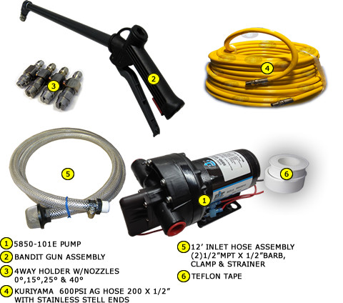

So as far as GPM go on a roof system. What is not enough? I’m looking at this system in particular vs the fat boy.
VS
Or
Plus the added pump in a box. I guess it would be cheaper to go the pressuretek route and just add my own hose reel and make a stand.
However the gen 2 pump comes with everything. So 4.7 gpm vs fatboy’s 7gpm.
