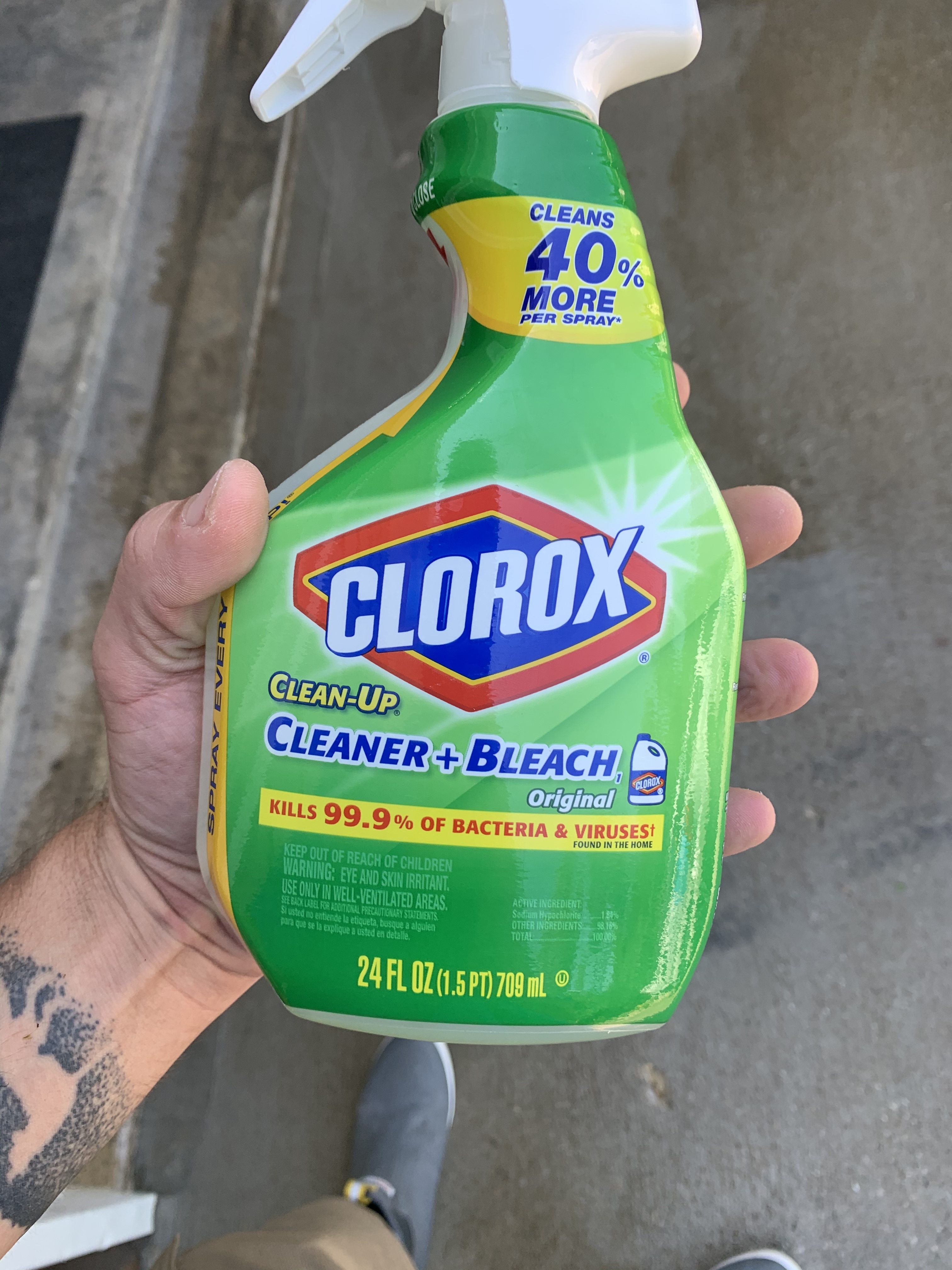

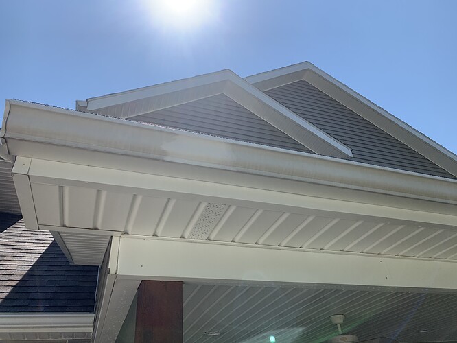

My house wash went like normal, all the black mold and algae was removed and dirt on the gutters and soffits were removed as well. Customer had oxidation (tiger stripes) on the gutters which I told him cannot he removed in our housewash process but I do have the chems to remove it and I explained that process to him. Well after service when I’m showing him the home and ready to collect payment, he goes inside, and grabs this bottle instead and a ladder
He did one spray on the gutters and whipped the oxidation right off… I’m shocked. I felt like an idiot infront of the customer but that made zero cents to me.

I applied my soap to that gutter like normal and used my high rinse nozzle directly on it to “blast” off the dirt… he mentioned tree sap but tree sap doesn’t cause gutter striping. What’s going on ?
When the oxidation isn’t real bad I’ll use a 2-3% sh mix applied with pump sprayer and brush, usually whitenings up. That looks around 2% from the bottle. If real bad I use GG.
That’s not just bleach in that Clorox Cleaner+ Bleach. It also has Sodium Hydroxide. What your customer did was “gutter brightening” or, stripped away a small layer of paint, which is not part of the normal house wash procedure. It’s no different than using Gutter Grenade and wiping the oxidation right off. As you know Sodium Hydroxide is a stripper.

If I’m not mistaken it also has over 1% SH strength as well. I used it on my ladders that had some algae.:laughing:
