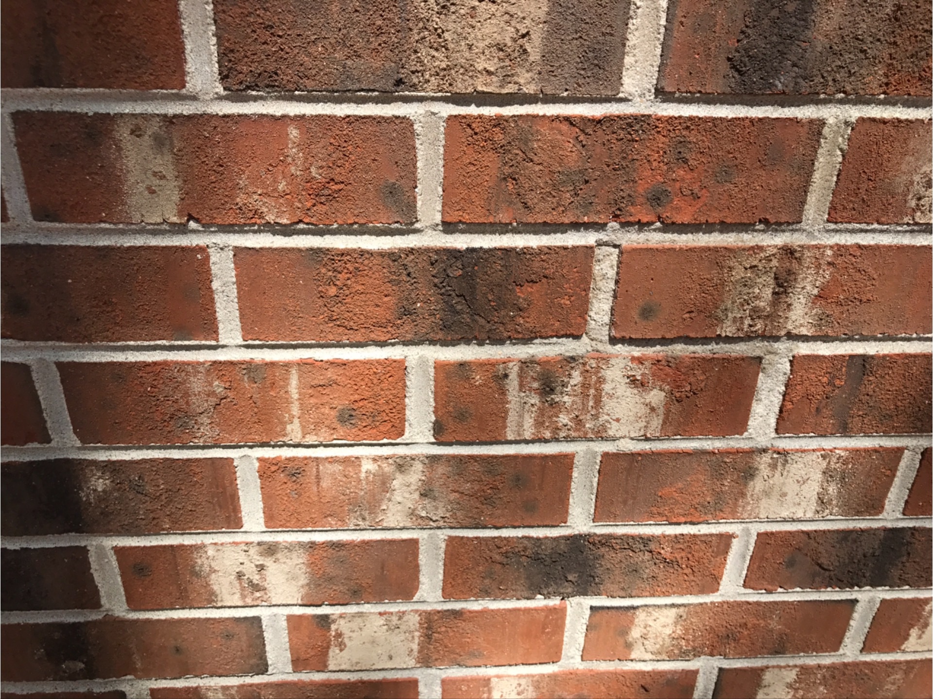

How can I get rid of the white and black spot on this brick??? I house wash this brick with a house wash mix 12.5 sh 2 gallons of water and a gallon of brown stuff…

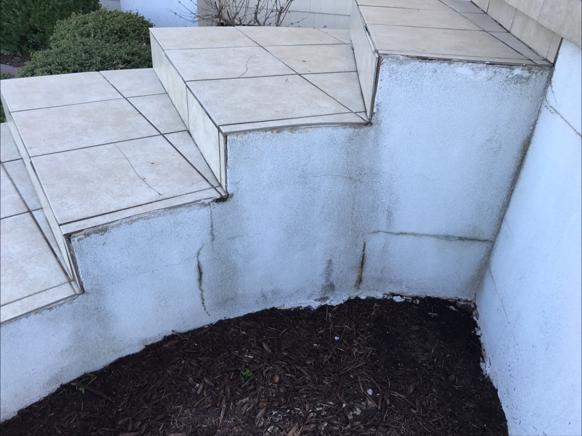

Also use the same mix in this stucco and could not get this black stuff off… I am downstreaming
Don’t know what brown stuff is but it might have killed the bleach
On the brick its probably just the color of it. Brick comes in many different colors.
The stucco you cant really down stream, you need to hit it with about a 3%-5% mix direct apply. So put some SH in a pump up and hit the stucco again, and you can try that mix on the brick and see if it kills/cleans the black spots but most likely just the color.
On the stucco it looks the same on top of the house… you think I could just downstream straight 12.5 and some soap??? I have 200 foot of hose so it should dilute it some … thanks for yours guys help
