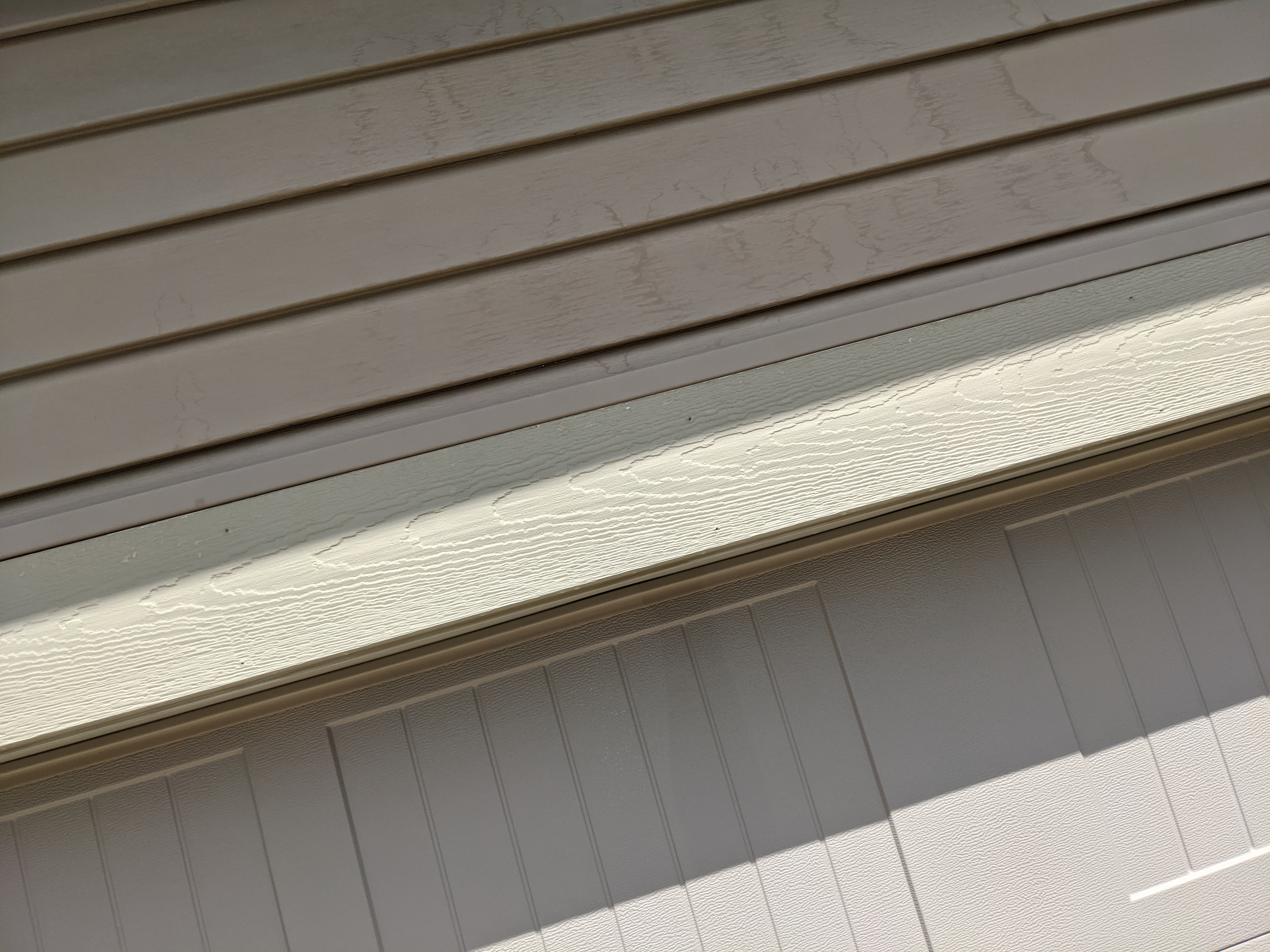

Hello everyone,
I had my house pressure washed today and it left these marks not sure what they are the guy who washed my house said that it’s drips that will just happen but will go away over time with rain? I don’t mean to be picky I just wanna know if they actually will go away over time
Thank you!
Yes, they will. The weep holes on the bottom edge of your siding sometimes trap dirt and debris and it leaks out when drying. A good rain should take care of it. Or call the guy back and ask him to re-rinse the area.
I did feel bad for the guy as he said he had rinsed it a couple times and it kept happening but thank you for the response I feel much better now.
No problem. He was probably rinsing too closely. A few steps back and he probably would’ve succeeded.
Ya I did a house a few days ago and got a little close to the weep holes. It went away and had no issues but, it definitely would have helped to spray farther away. Sometime if it’s an enclosed area it’s difficult to rinse.
