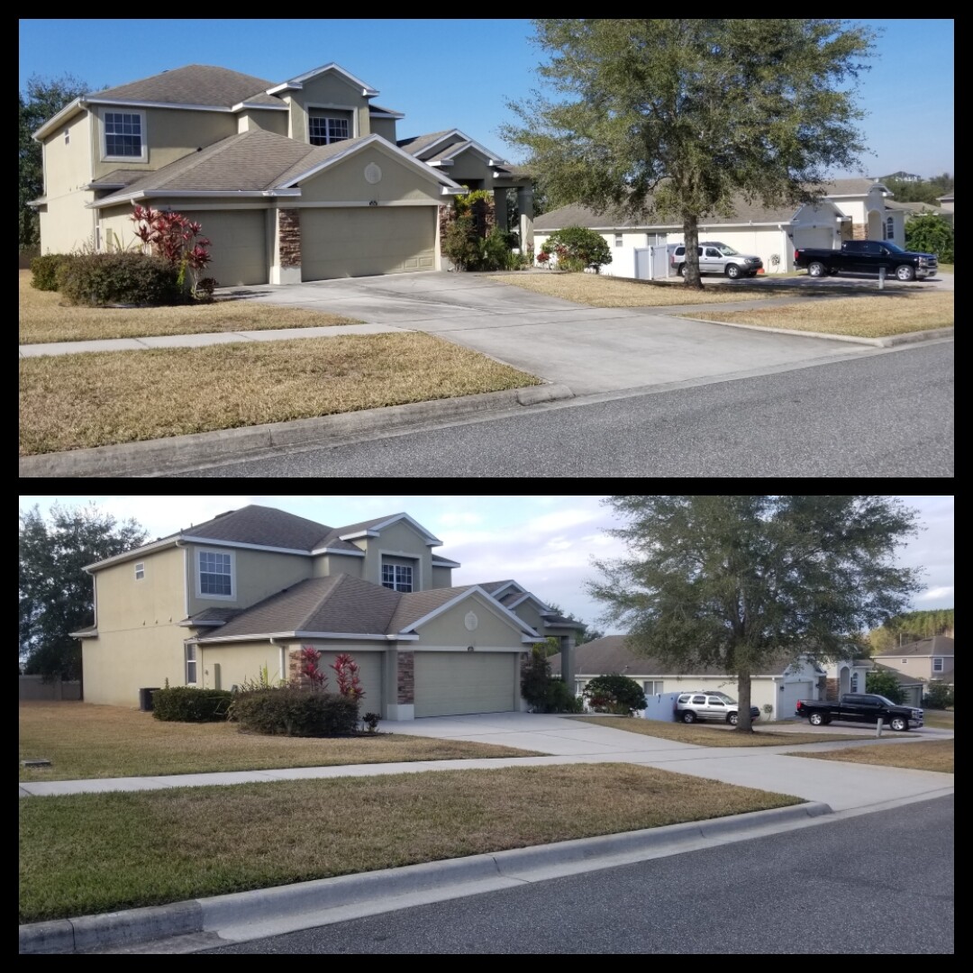

Finished pressure washing a customers driveway, now they want to repaint the house so they called me for a house wash. Would like to know if I should only softwash it or pressure wash it too.
My concern is the dirt, dust, webs, mud daubers… the stuff that’s not affected by SH.
OR should I just softwash it and let the surfactant lift away the dirt, dust, webs, and mud dauber.
