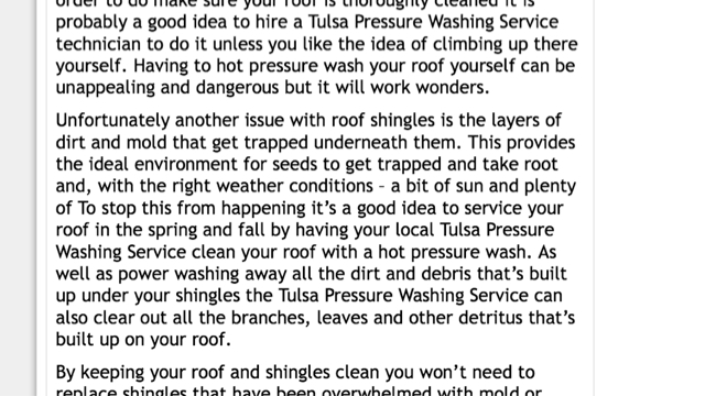

Been reading up on local guys methods. This guy does a HOT PRESSURE WASH. Anyone else do this? This is the first I’ve heard of it. Seems dangerous and damaging, compared to soft washing. Am I wrong?
Don’t do that.
No pressure washing a roof at all!
Absolutely not.

Even pressure washing the dirt and debris beneath the shingles. That’s impressive. Ha!
What an idiot! I wonder how many customers roofs have been damaged if not ruined by this practice?
Holy smokes. He’s washing UNDER the shingles!? Does he use a red tip?
