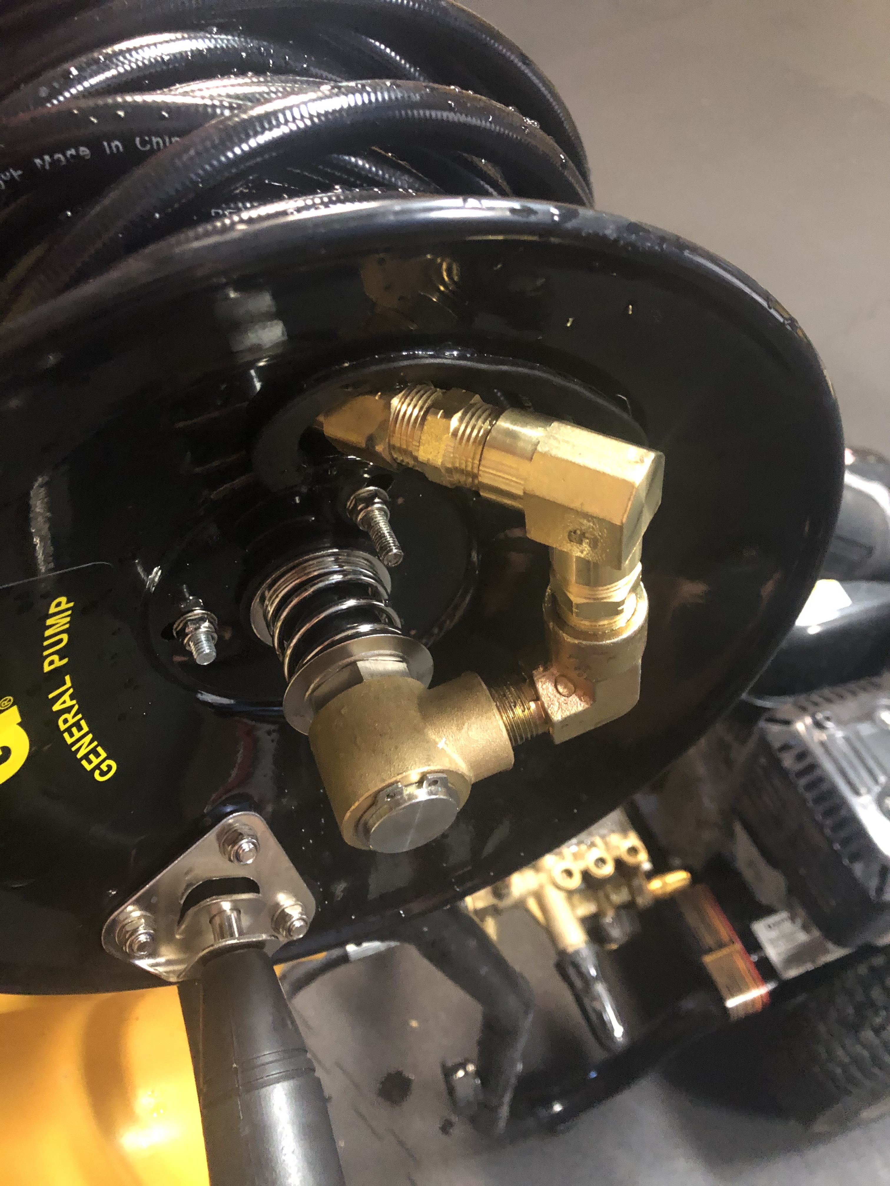

So I ordered a hose reel from Amazon as well as 100 ft of pressure hose. I used multiple pipe connections I got from Home Depot to set it up, and it is leaking water everywhere I’m assuming because the connections are not rated for high pressure. Is there anyway I can seal the connections so that it will work?

Does this look to be setup properly?
I took the first picture before I connected the whip line from where the gun goes on the pressure washer to the bottom connection on the reel.
Whole lotta restrictions with all those 90°s. Just loop the hose out a bit and back into the swivel straight in. Like so:
Ahh - okay then you’re not in bad shape. I think all you’re missing is some teflon tape on the threads which should stop the leaks. Also @Infinity is spot on - ditch the 90s when you can.
Even though they are just normal pipe fittings you think Teflon tape would work?

Yes sir. Later down the line if you start building a softwash system that flows chemicals you might consider replacing the teflon tape with blue pipe dope… but like most things everyone has opinions on what to use where lol.
For this I would keep it simple and use teflon tape.
Look up PTFE on a chemical compatibility chart. It is super resistant to the chems we typically use.
I think the blue pipe dope has other beneficial features, though.
Everyone has a different method. My tried-and-true, never had a leak method is 3-5 wraps of Teflon tape on every male fitting with blue dope on top. It’s really hard to get NPT fittings tight enough to be leak-free without some kind of tape or dope. And if you do, they’re just a foot pound or so away from buckling the male or cracking the female
