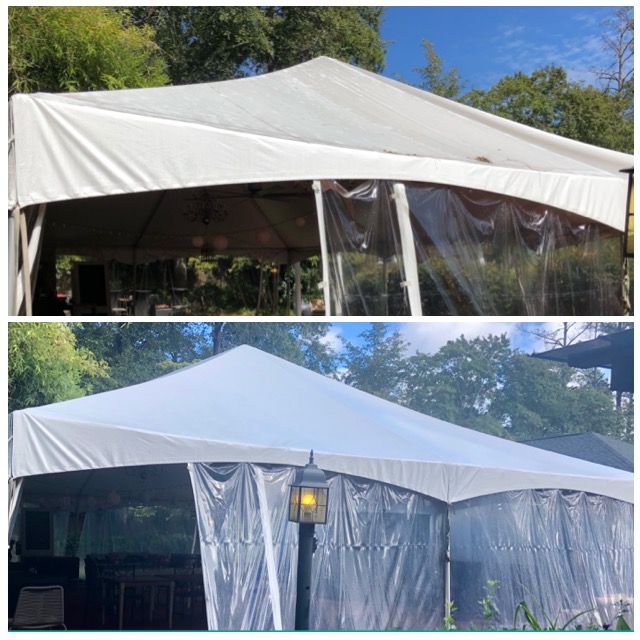

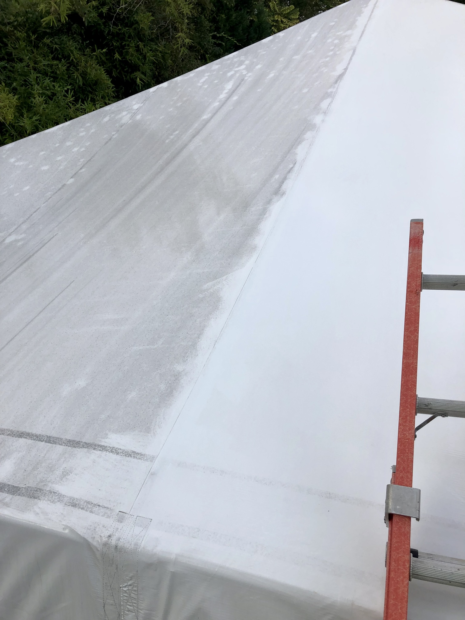

Can’t state I’ve cleaned specifically what you are asking, but if it’s anything like a wedding venue type tent material, a HW mix did great for me. I used my gutter scrubbing brush (green bristles 270 degree) on a telescopic pole to get any stubborn areas where lichens were holding on. I did both the outside and the inside of the tent. The inside had a couple chandeliers hanging down and I had to exercise caution to not let water drip down into the any of the many, many lightbulb sockets.
