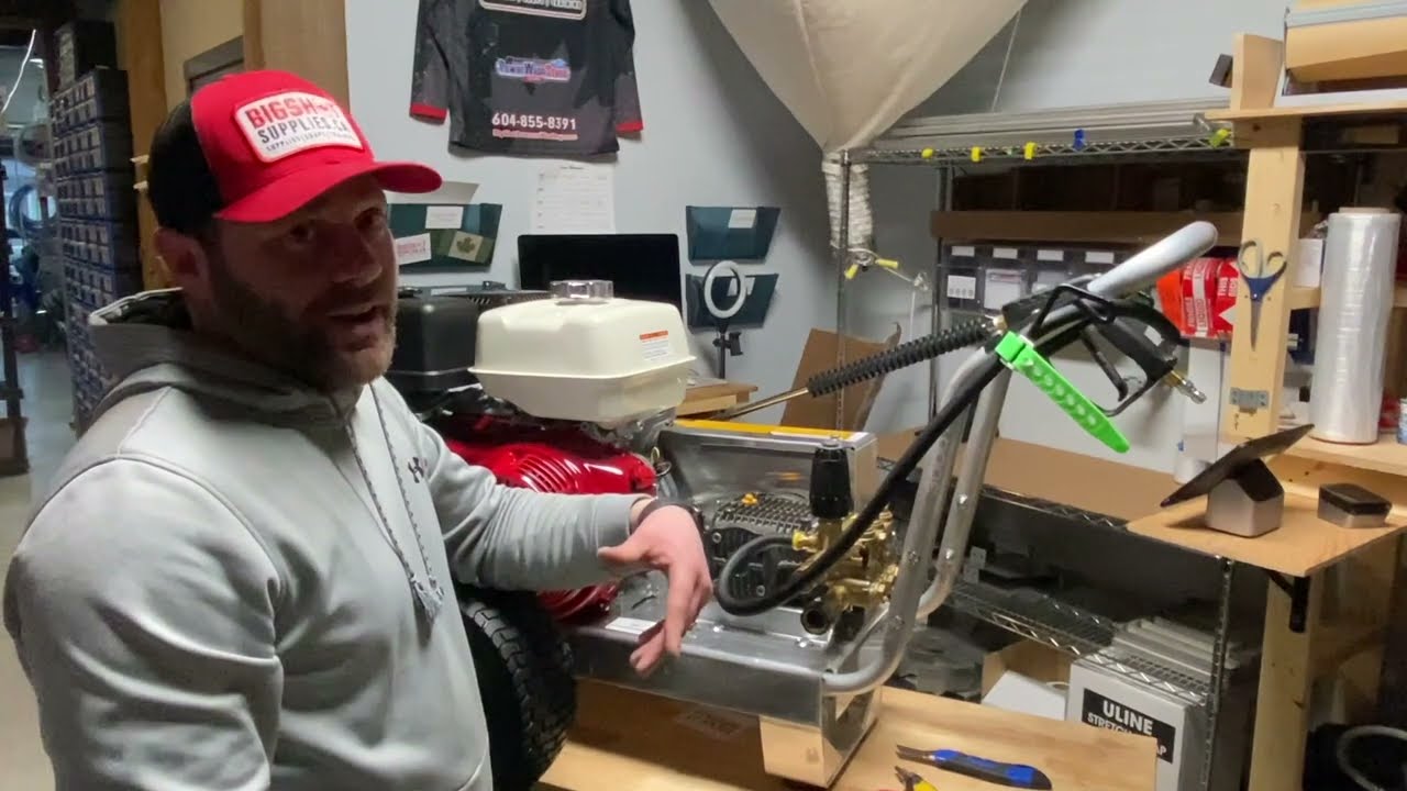

Ok, so now I’m really confused. You asked a question, didn’t really believe us and now posting a video on how to do it.
Not sure where you got the part that I didn’t really believe “us”…??? Your previous response was really non-helpful anyway. "Get a braided vinyl hose, "? If you had bothered to pay attention, you would have realized that I already had the hose…and it’s pictured. Now you’re back with more nonsense? Give it a rest, dcbrock.
No need to get worked up, he was jus responding to your follow in which you stated a bunch of data points and asked what others thought. If you were using a closed cycle where the pressure could build up, then yes, you could potentially burst the braided line… but using it as a bypass line it will be continually flowing when in use. I’ve had braided lines blow off the end of the barb (wrong diameter/clamp not tight enough/etc) from the force of water shooting out the bypass but never had one burst because of it. So as @dcbrock said, don’t overthink it… use what you got and move on. If it does burst you’re only out a couple bucks and now know to get something more durable.
