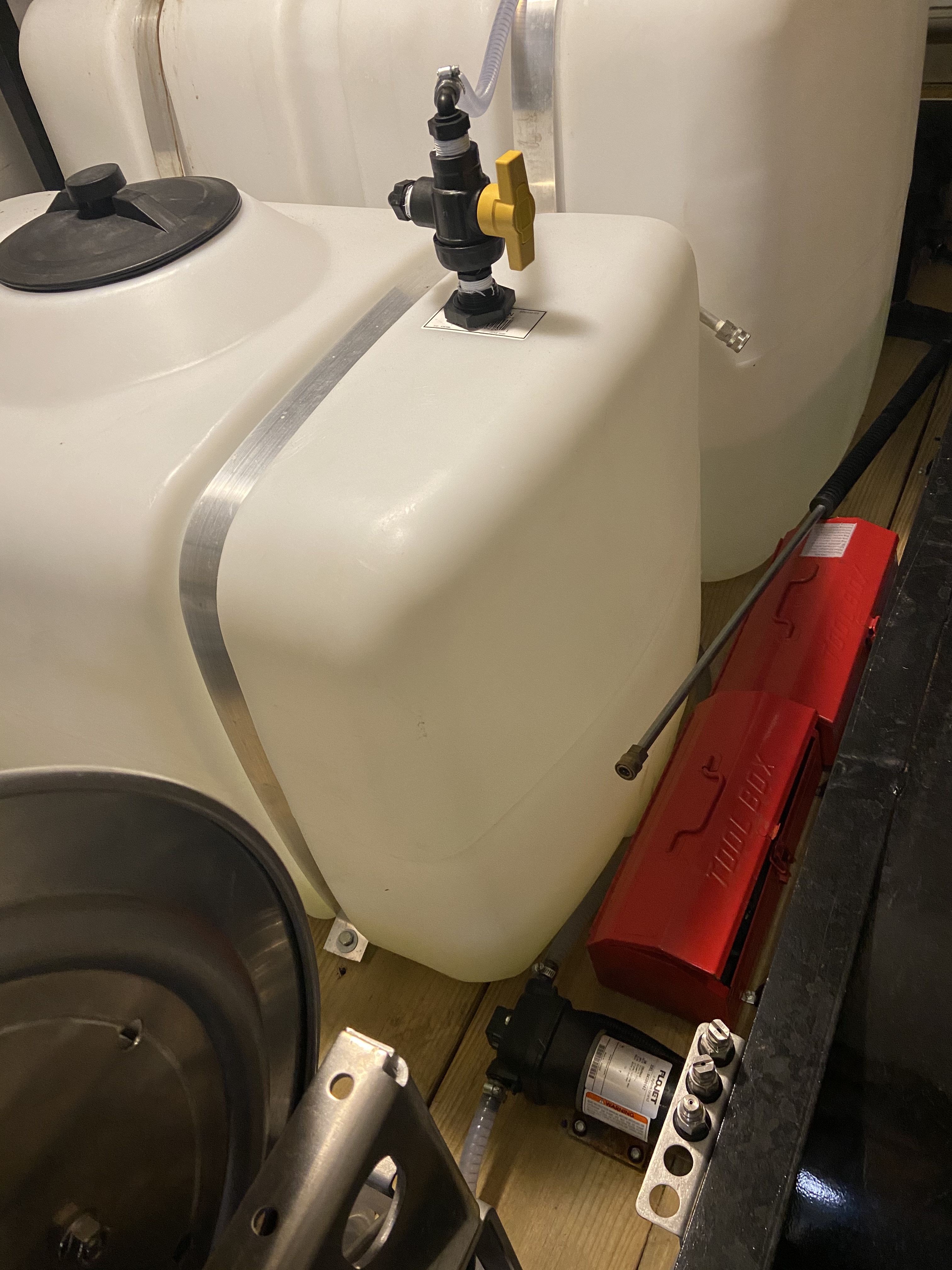

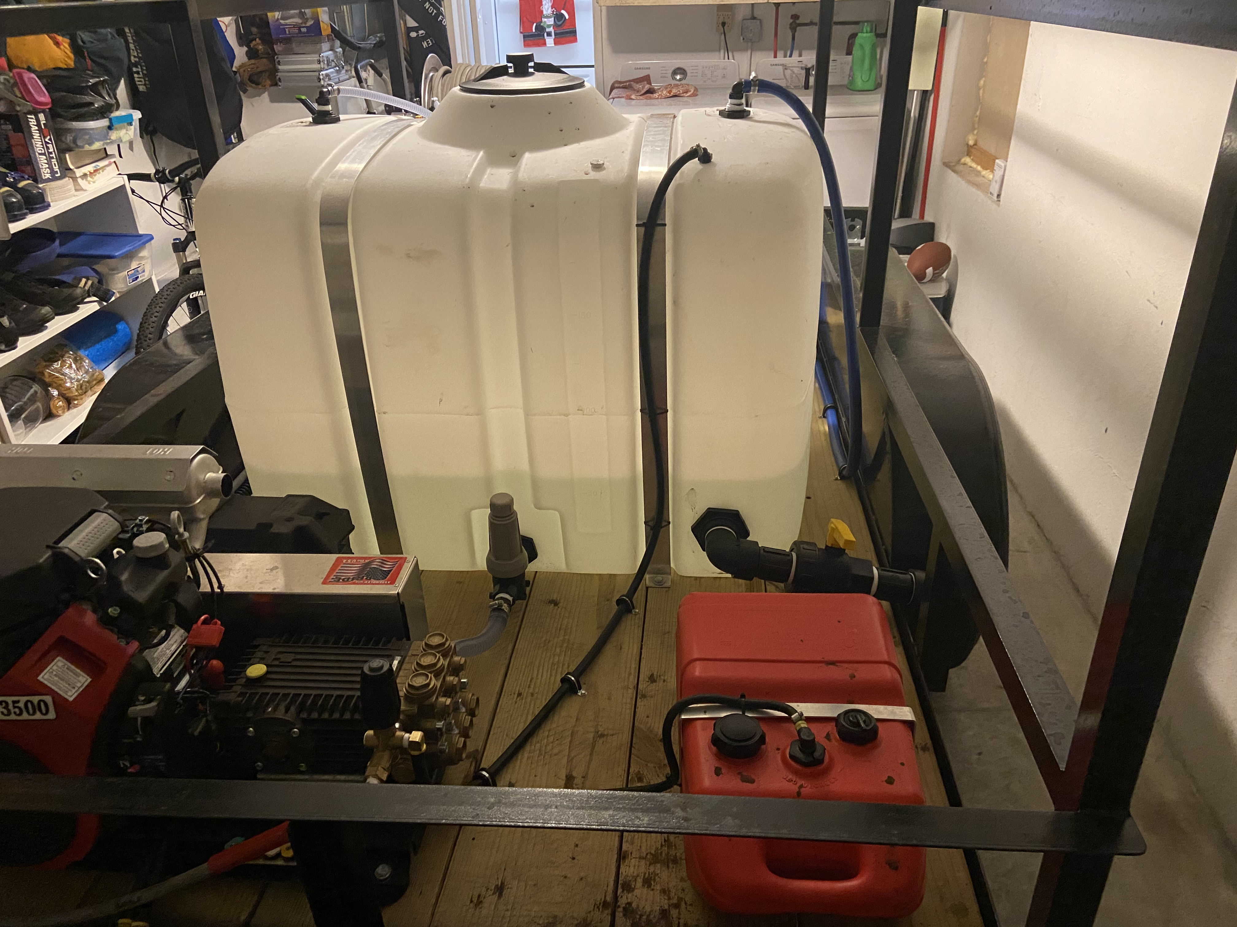

Here’s my new setup. Thoughts?
I love those short tandems! They look like they mean business, stalky little F’ers. :smiley:
I would use a non collapsible inlet hose if it was me. Looks good though.
I really dig the rack all the way around I’d mount my reels under the top bar on the rack so you can free up some floor space. Looks clean though!
Might consider an unloaderblock. Clean setup though!

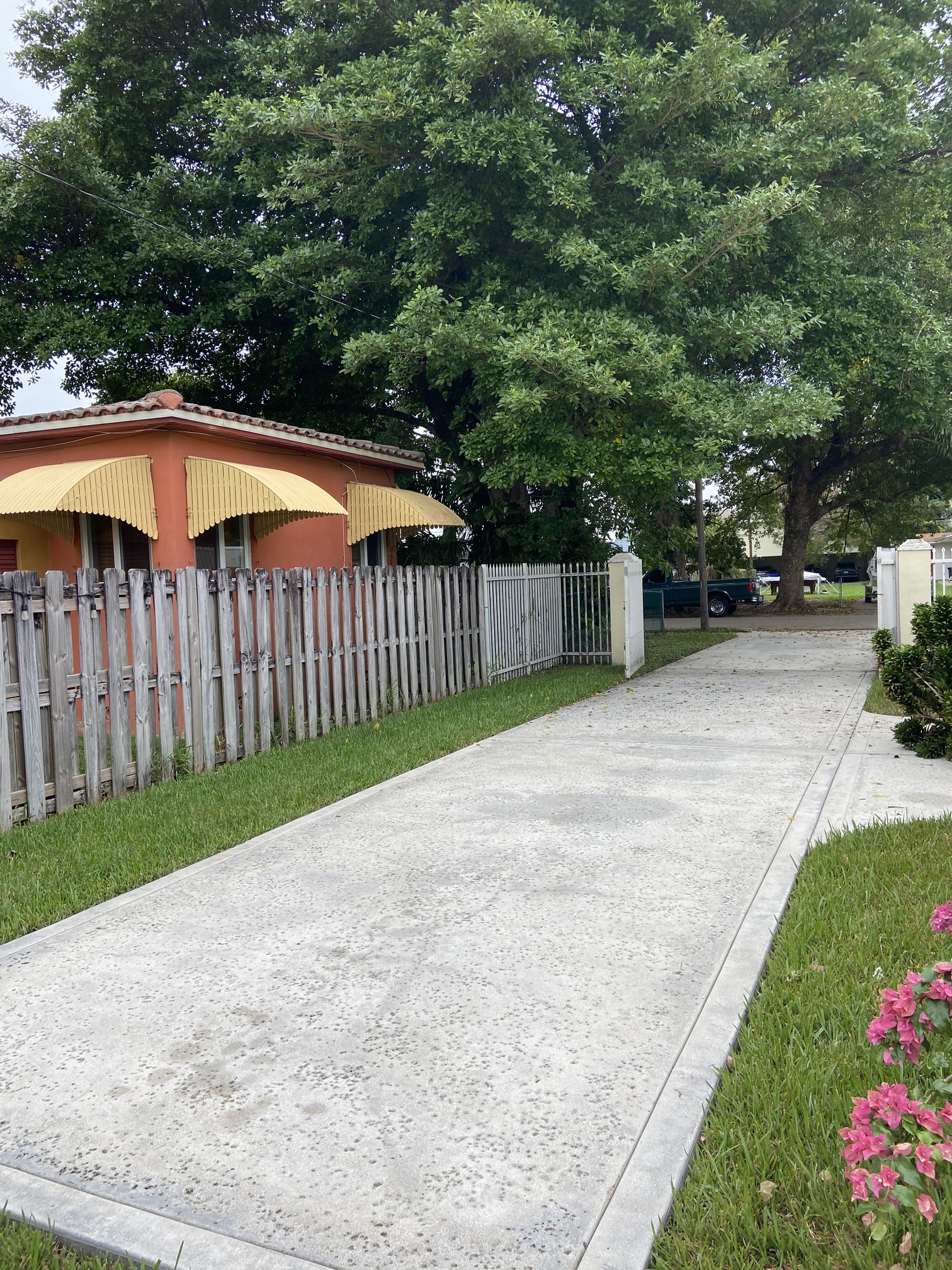

Looks like you need to try it out on the driveway is parked on
Nice set up. Where u get the tanks cant find those in my area
Already did. Also the roof walls and walkways haha

Not worth it for me personally but if everything works well then yeah it’s probably worth $450. Over $2k for all that brand new. It’s a soft wash pump on that engine though. I’m sure you already were aware but just wanted to point that out.

What are those stackable reels called?
The ones in the OP’s build are Titans. They sell a stacking kit for their full frame reels. Most manufacturers do.
