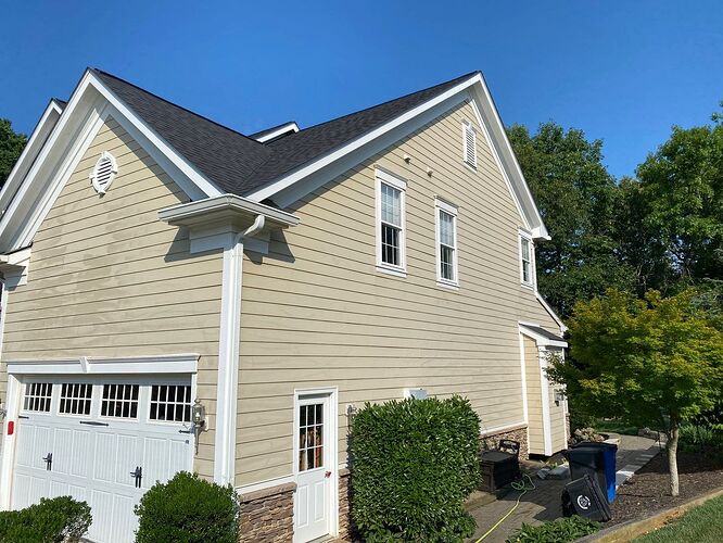

Has anyone actually test spotted Hardie with Cleansol BC or similar? I’m going to get more details Monday morning, but my guy washed a house today that he swears is oxidized paint on Hardie plank, and the homeowner thinks was caused by another washer in the past. I’ll probably just have him stop by and try a test spot, but was wondering if anyone had already beaten that horse to death…
TBH, it looks more like it was washed with a zero tip than disturbed oxidation… ![]()
Yes, I’ve done one house that had blue hardie board that was heavily
Oxidized. Used cleansol. The areas down low that I could hit with a low pressure 25degree or something to rinse cleaned well but anything out of reach needed to be done from a ladder. End of story, per my recommendation they just repainted it.
This stuff melts the oxidation off….
Just saw this advertised the other day. I’m guessing you’ve used it?
I haven’t yet but another company I know used it and loves it……said you need no brush to remove oxidation, just a little pressure. Stuff I’ve used in the past almost always needed to be brushed, so….gonna get some.
Let me know how it goes. I saw a vid and it looked promising.
We’ve used Cleansol BC without brushing successfully several times, so I’m not looking for a a new product. My question was had anyone tested that on painted Hardie Plank, or any painted surfaces…
That was done with a white tip from a ladder
In my experience, If the paint on the Hardie is in good shape then the chems will be fine used as directed. I always set expectations based on the condition of the board….and do a test area too. If customer is good with results then we proceed. I’ve ran into some where the paint was failing and recommended them to paint. I could do the prep for that but would recommend they talk to their painting contractor first, he may want to prep so he can provide a warranty for his work.
That’s probably because there is a ladder & a Ryobi behind that garage door.
Keep us posted on how this turns out, I would like to know too.
You think a Ryobi has enough power to do that? ![]()
What @Barry1 said
