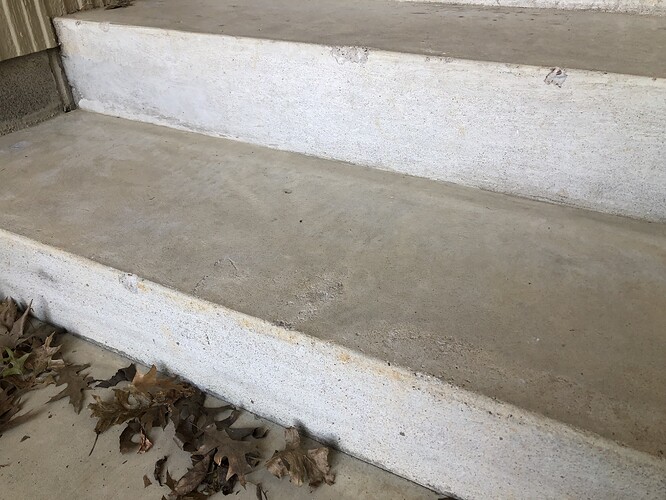

Home owner says the concrete is 39 years old, however it looks brand new, still has the cream on it. Should I surface clean it or just a light rinse with chemical? They just spent 120k on a remodel and want the concrete to look new again but I don’t know if I can do much to this.
You should be just fine pressure washing it since it’s not newly poured. Just do a test spot. You’ll still be able to see cream on concrete that isn’t exposed to weather or concrete that is kept sealed. Looks like both of those come into play here. How long a cream layer stays also depends on the finish. A lot of exterior concrete is brushed which means a little less cream. The concrete above looks hand troweled so they bring a lot more cream to the top. I’d be very surprised if you have issues. Just keep it around 2800 psi or lower.
Yes you are correct, no issues whatsoever, I have never seen concrete keep it’s cream for so long. But that makes sense about the hand trowel comment
