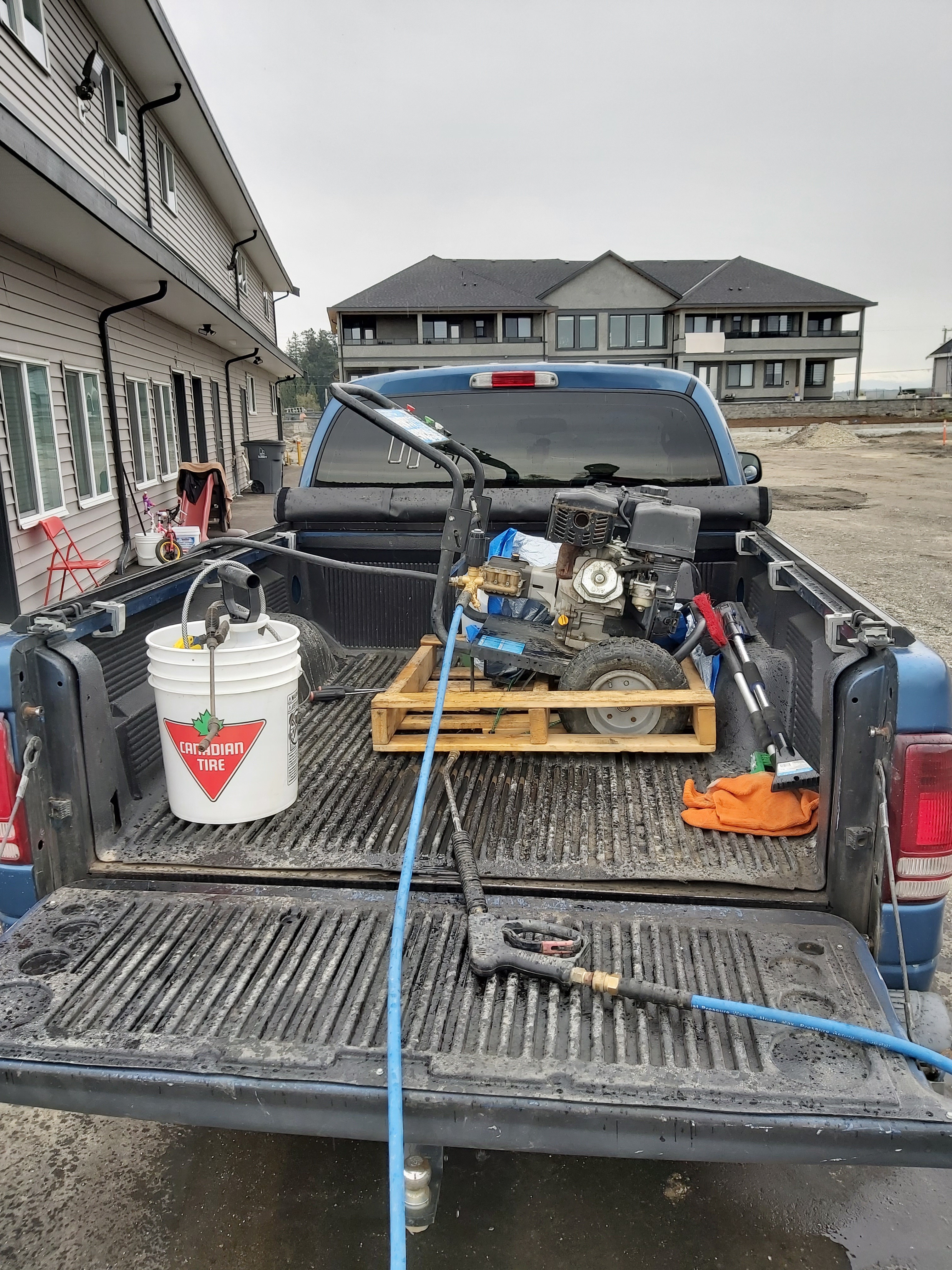

Got the pressure washer hooked directly to the garden hose. It’s a 4 GPM threw a new unloader valve on there so I can bypass water to tank. Took the old valve and outlet valve off. Haven’t got everything set up yet. Was just firing the power washer up too test. Its starts up great but no water is coming out of gun… I’m dumbfounded How can I fix this?

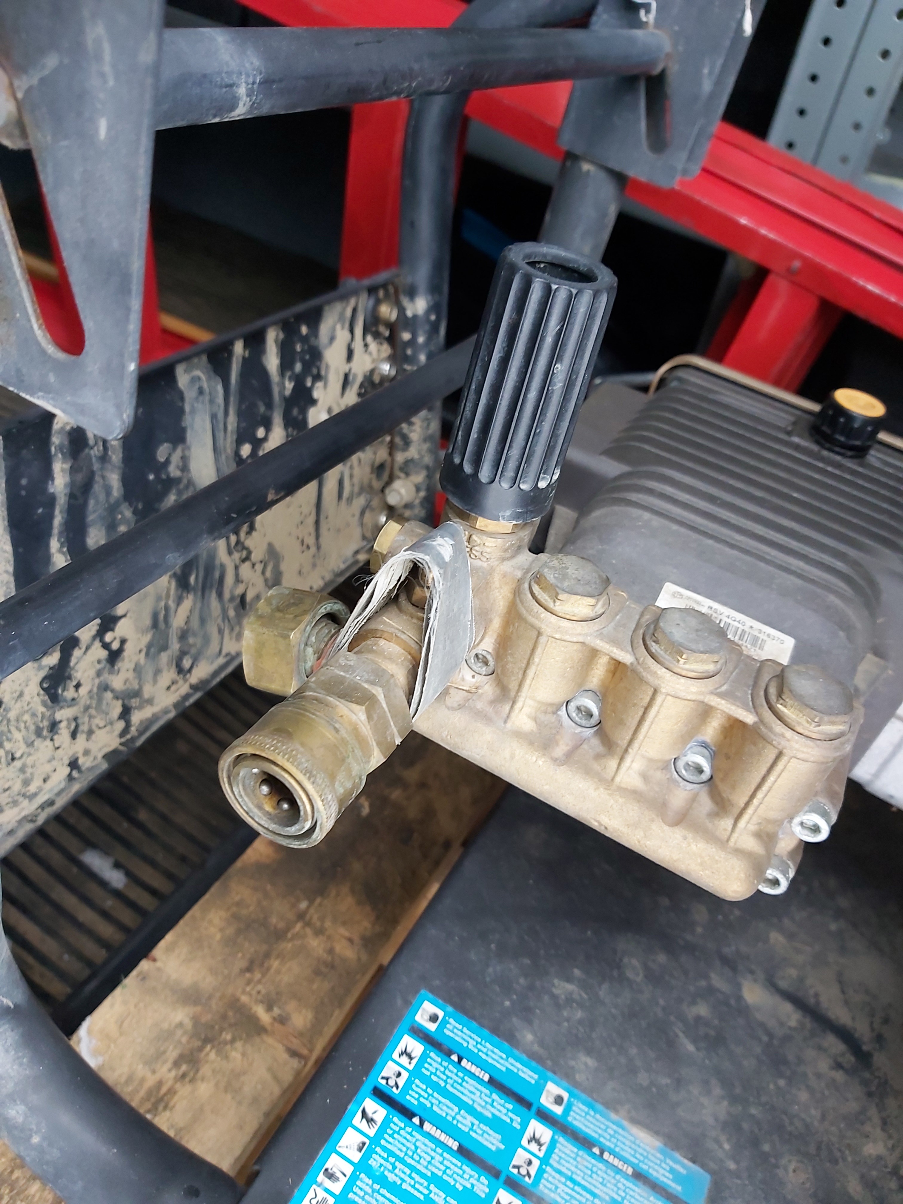

Original valve before taking it off and the injector.
The other guys know more than me, but that unloader is built into the pump, don’t think you’re supposed to take it off.
I didn’t even notice you added an unloader after the built in unloader. @dcbrock is correct. You can’t do that. Although, there are ways to accomplish it but it requires drilling out, tapping, and plugging certain passageways inside the original unloader. You’re better off just picking up a new pump without a built in unloader.

I’d say use it the way it came until the pump craps out, then swap it with a real one, are you just planning on bypassing onto the ground? Some people have issues with direct drive machines on buffer tanks, not an expert here, just what I’ve read
Yeah you’re right. Just gonna have to use for now until I can get my hands on another machine!

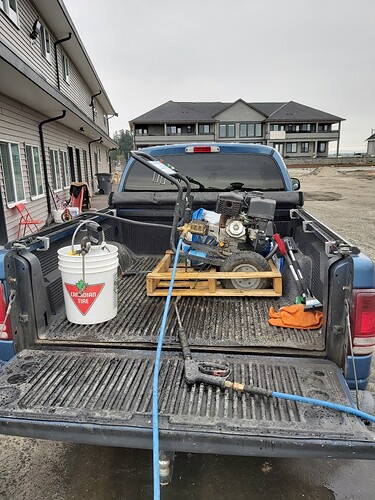

@cclean Please go ahead and level out that unit it’s a ticking time bomb. That pump and unit were not designed to be run for hours on end on a slope. Not to mention oil levels and gas etc…
