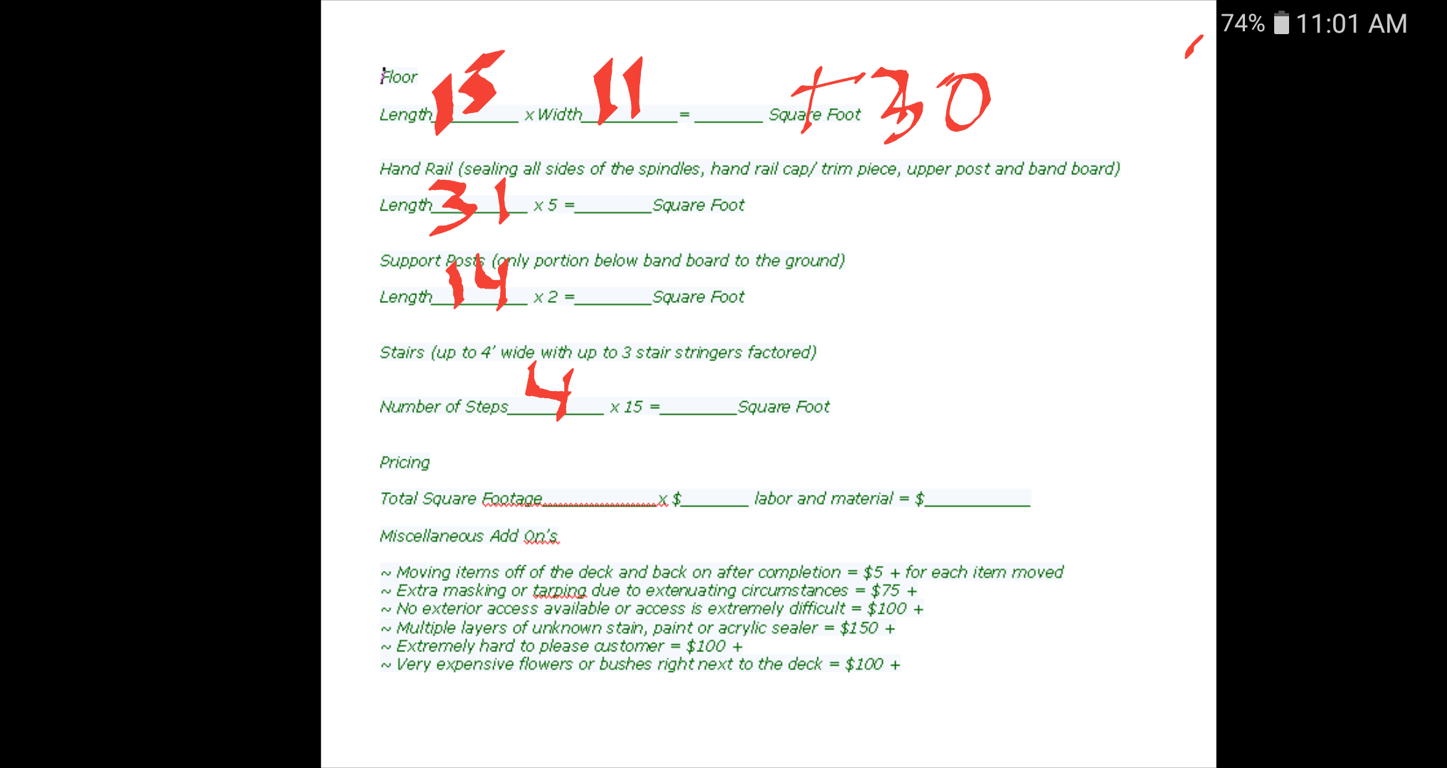

Heres a handy sheet to help you out.
I must have deleted the original file but heres one i wrote on
I had gave them a price for 165 sq ft and it was actually 435 sq ft.
