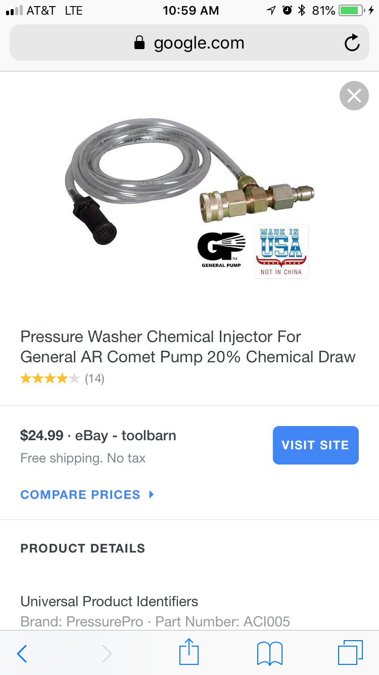

Most big box store PW pumps have the chemical injector built in and they’re junk. You can either cap the chem injector on the machine and go buy a fixed chem injector and put two quick connects on and you’ll be good to go. You can also ditch that pump and get a better one (General, Udor, etc)…put an unloader on it it and you’ll also be good.

Id reccomend getting a better machine when you can…I also understand bills have to get paid. If your not able to upgrade to a pump where you can use an external Down Stream Injector then id go with the X Jet M-5 for the meantime.
Order a X Jet M5 and a gallon of Eliminator from Pressuretek…go find some liquid chlorine 10 or 12.5%…Go make $$ and when you can upgrade to a better machine.
I used an M5 for two seasons…finally switched to a downstream injector with a 35 gal chem tank and boy has it saved me a huge headache. The M5 does and will work in your circumstance though.

Like the others, I’d definitely look into getting a different injector and cap the one you have. And stay away from box store chems. Like @Patriotspwashing said, get some good surfactant like Elemonator. With the right injector and chems, you will be fine. I agree that your machine isn’t necessarily ideal, but its not the problem right now. Read, read and read some more on chems and ratios. Use the search and you can find all the answers you need. Good luck.

Second, if you have the unloaded and DS injector built into the pump, I would go on ahead and upgrade to one that has a separate connection to install your own DS injector and unloader. I went with a general pump, and it came “fully plumbed” (meaning all set up with unloader installed) I believe the one I bought is an EZ4040G. Just match the specs to make sure. Only 4 bolts, not even a key inside to replace it.
Once you have the pump installed, get a DS injector. I’m currently using a fixed one, but am about to try out an adjustable one simply because I am drawing waaay too fast lol. Make sure you install it the correct way, put PTFE (Teflon) tape on all your threads, and most importantly- install the DS injector facing the right way. Yes, I made that mistake, because the pump has a female connection, & DS injector has a male. SMDH😖
