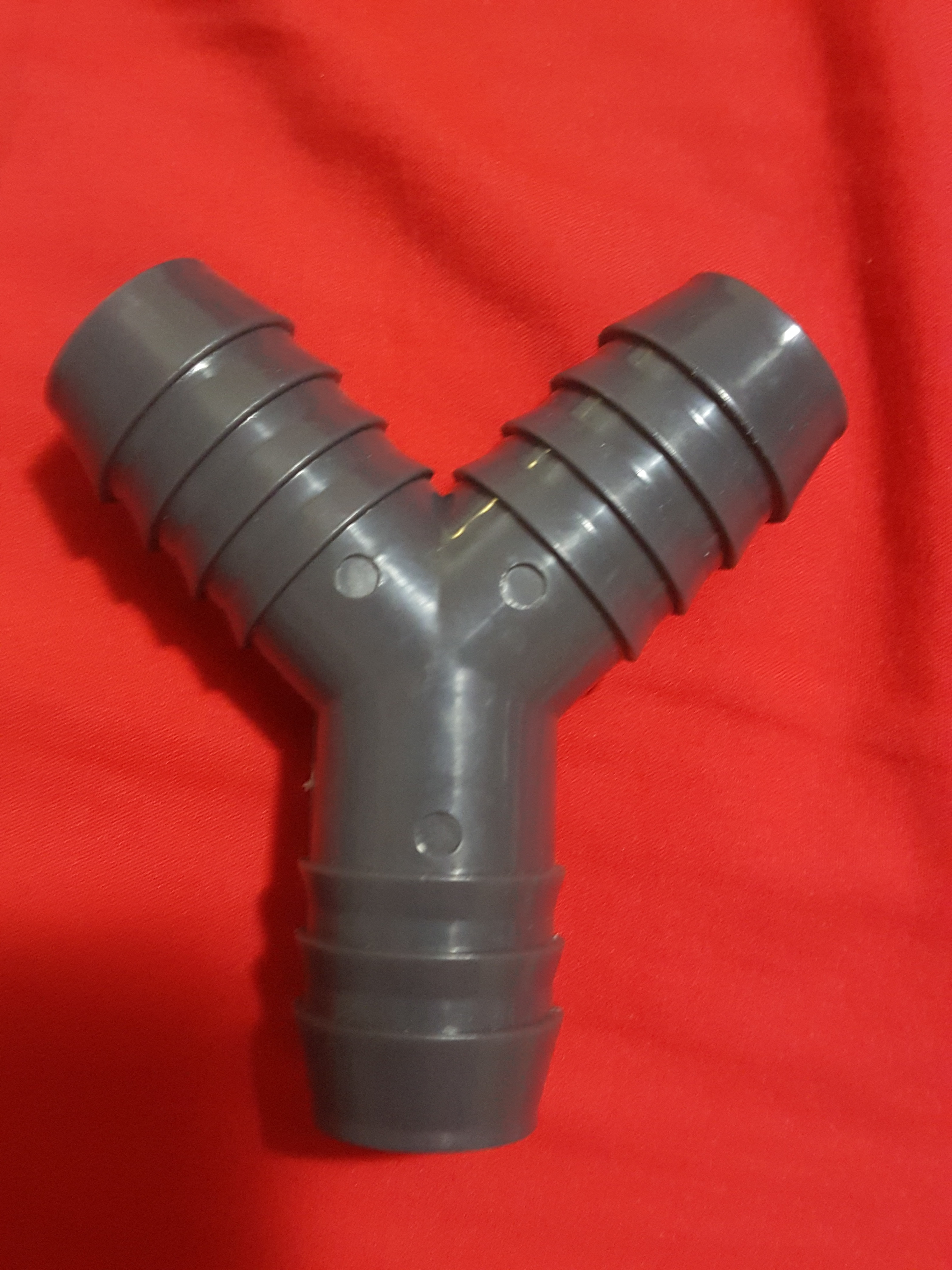

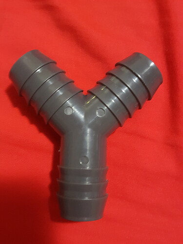

As per everyone I’ve ever talked to…a T fitting is just another 90 degree fitting and 90 degree fittings slow down water…now this is what I have…makes me feel like my water is more streamlined…weather it really makes a difference or not I’m not sure… guess if I was really bored I could do a bucket test.
That’s not a good idea
Curious as to why a Y isn’t a good idea but a T is fine? Same principal less restriction
You have much more restriction with that unless I’m missing something and that is 2 inch Y. Not an @Ikii 2 inches. If you are feeding two machines from one bulkhead head: come out with 2 inch bung hole to a 2 inch Tee. On both sides of Tee put a ball valve. From there step down to 1 inch bowl filter and 1 inch supply hose.

@Innocentbystander gotcha makes total sense…lol… no it’s not his kind of 2"…its a 1"x 1" x 1"…I’m a one man show so I never run 2 machines at once…I just have 2 machines hooked up at once… never thought about if I ever had to run them both at the same time …ahhh the changes I’m going to make on my next trailer build!!!..lol…im also going to be on the lookout for a 2x2x2 Y fitting though…
