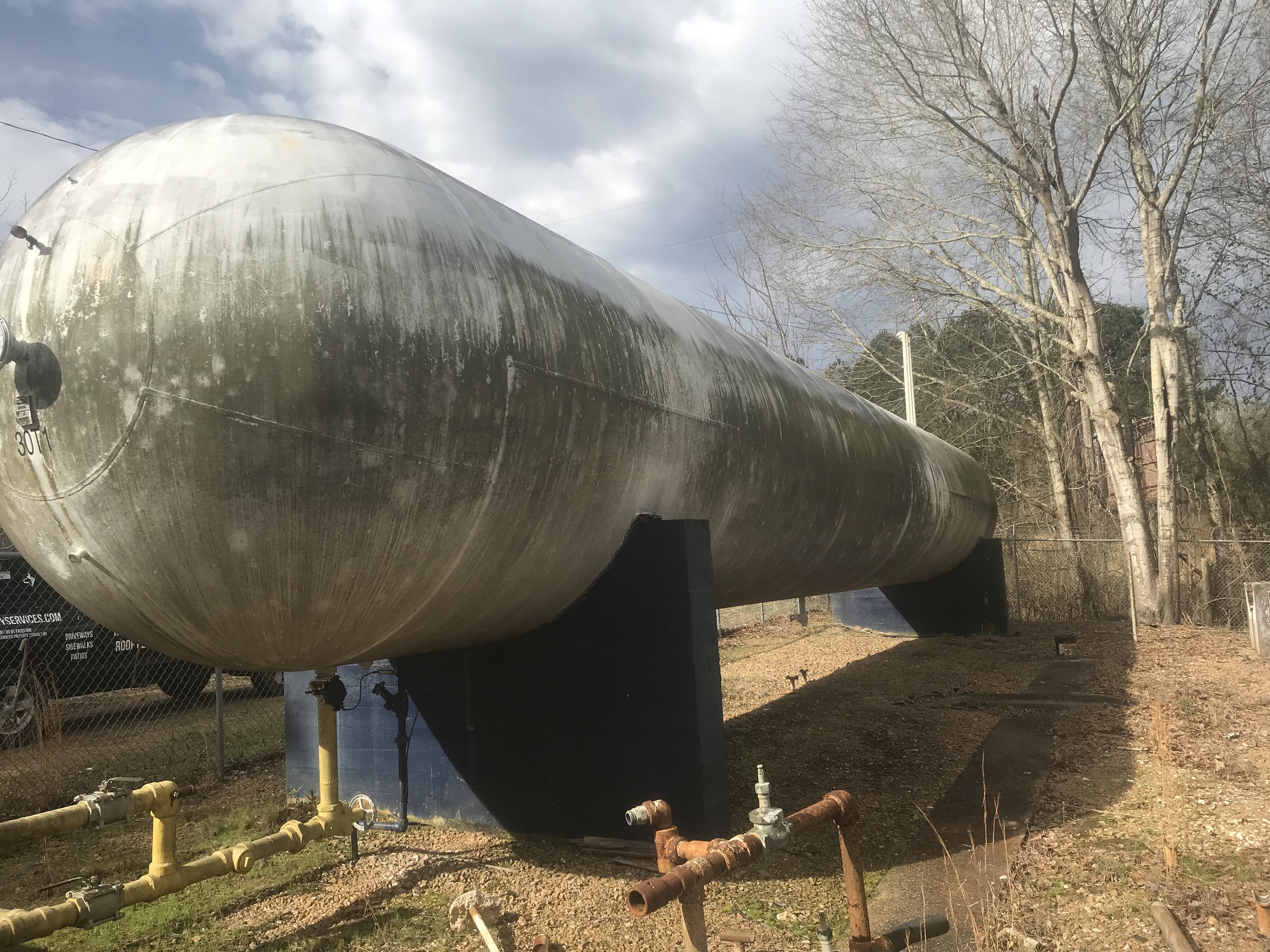

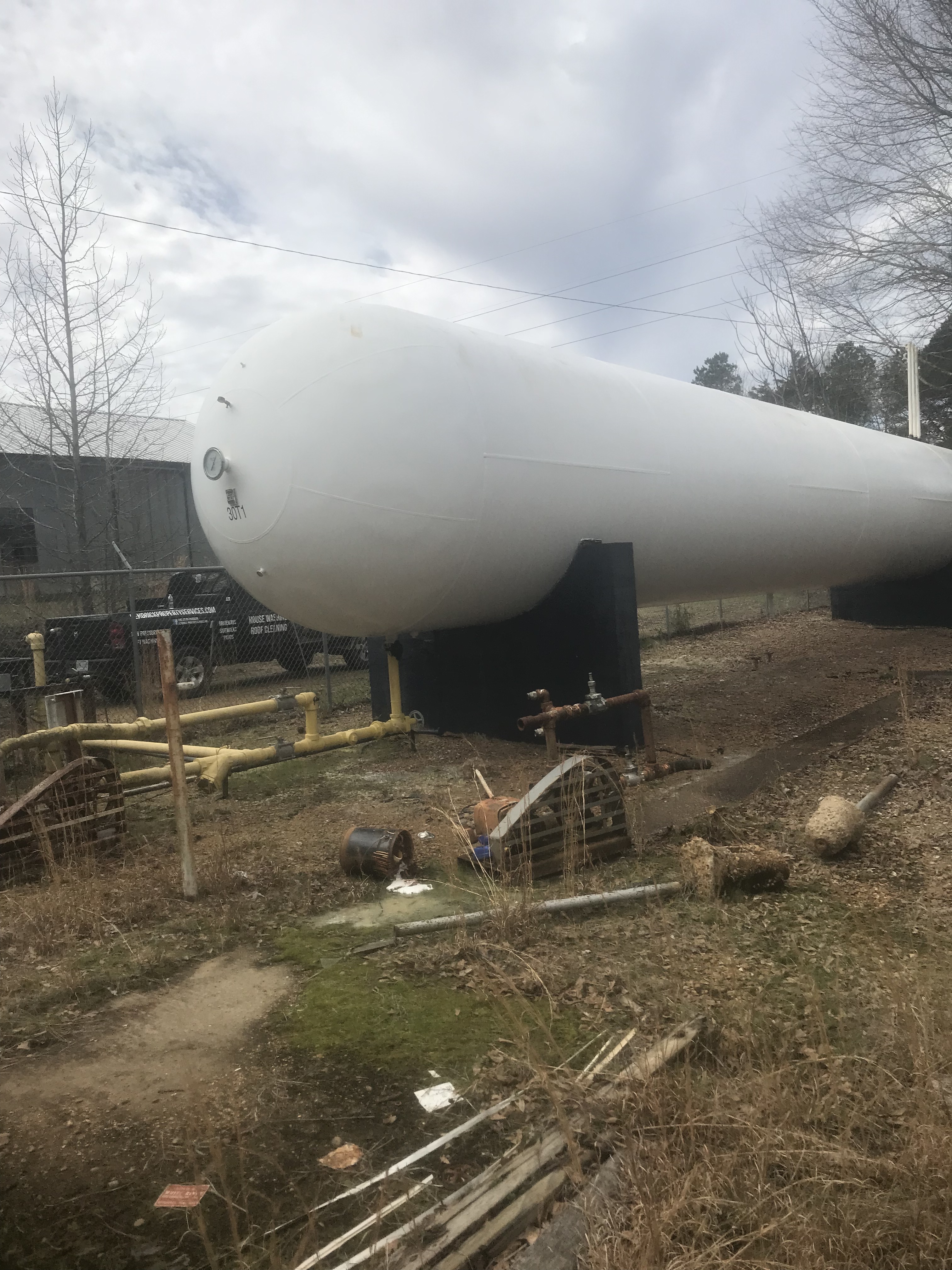

SH and dragon grip 50/50 on these with 3-4 applications
Looks good man.
Outstanding!
Those look amazing! How long did it take you in total? What did you end up charging?
I can only imagine how satisfying that was. Did you end up grounding the machine, did they shut off the valves?
It took about an hour a piece. No grounding equipment or anything like that. I never even got on a ladder. I mixed the SH 50/50 used the Gen 3 to apply it I used the zero tip to apply mix to the top. I just let it kind of rain down on it and checked to make sure I got it all. Then light pressure with the washer to rinse.
