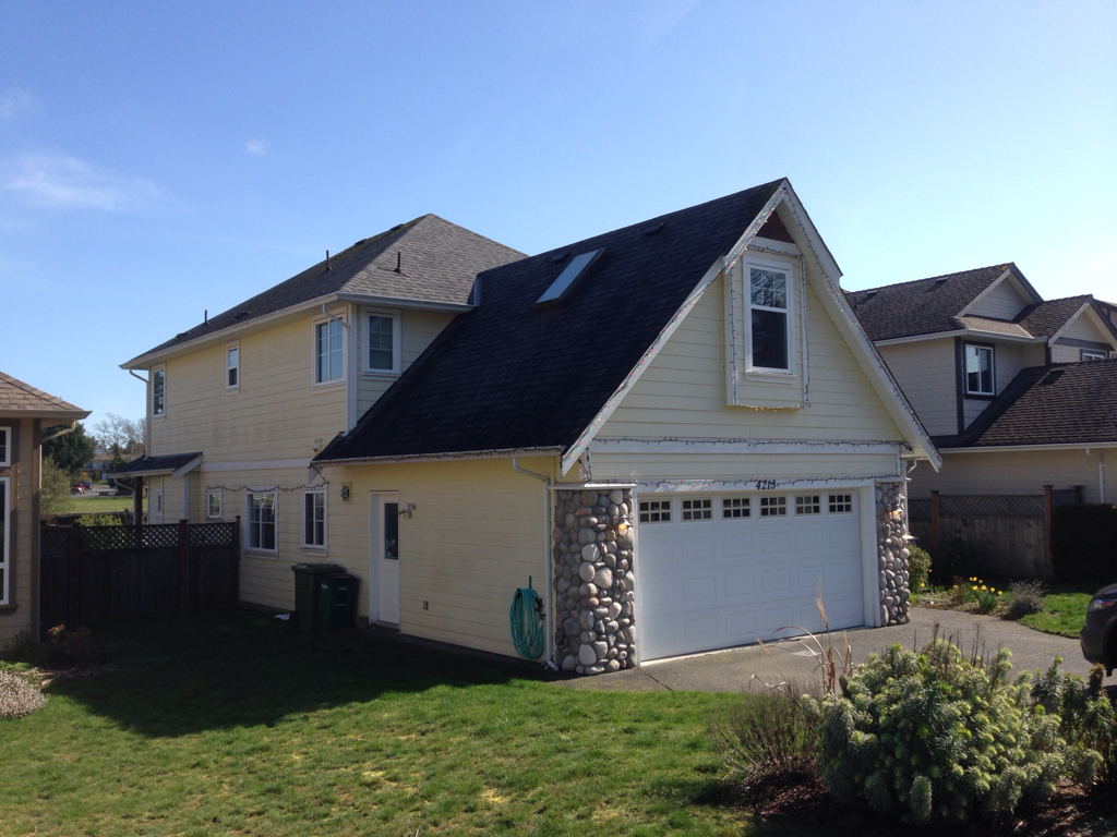

This Forum is priceless. I just booked this hardi board House wash and driveway cleaning for tomorrow

Hardiplank is very common around here and these guys were spot on with the proper cleaning process
Damn right!
I cleaned that house in the pic above today and it came out perfect. Also did the drive way in the same way and then re applied my house wash after I used my surface cleaner. Turned out better than expected. Can’t wait to see it dry!
