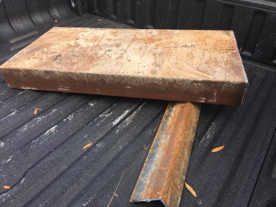

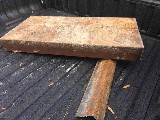

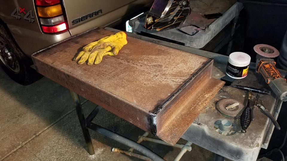

Get rid of thin crap and build your own!
My skid is a 3/8” thick, 18" wide C-channel, 30" long, 4" angle iron welded on the ends to stiffen her up and also give me a place to bolt this puppy down.
Did I mention she weighs 143lbs :+1:
Got all this from a scrap yard. Cost me about $60!
And yes, that’s a 37hp kohler
I can’t stress enough that you CAN NOT have any Flex in your skid! It must be rock solid. That 37hp will destroy your aluminum frame.
