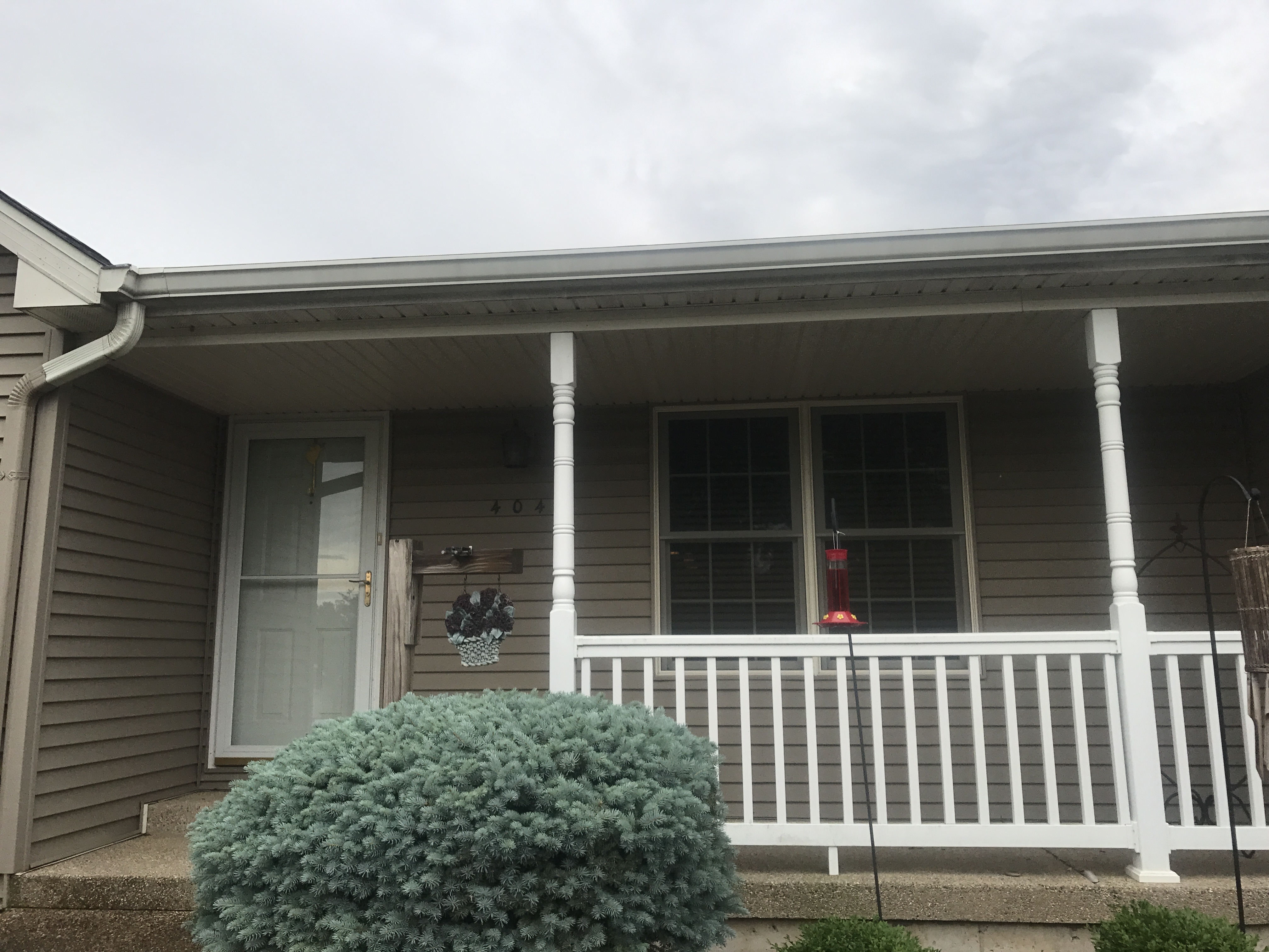

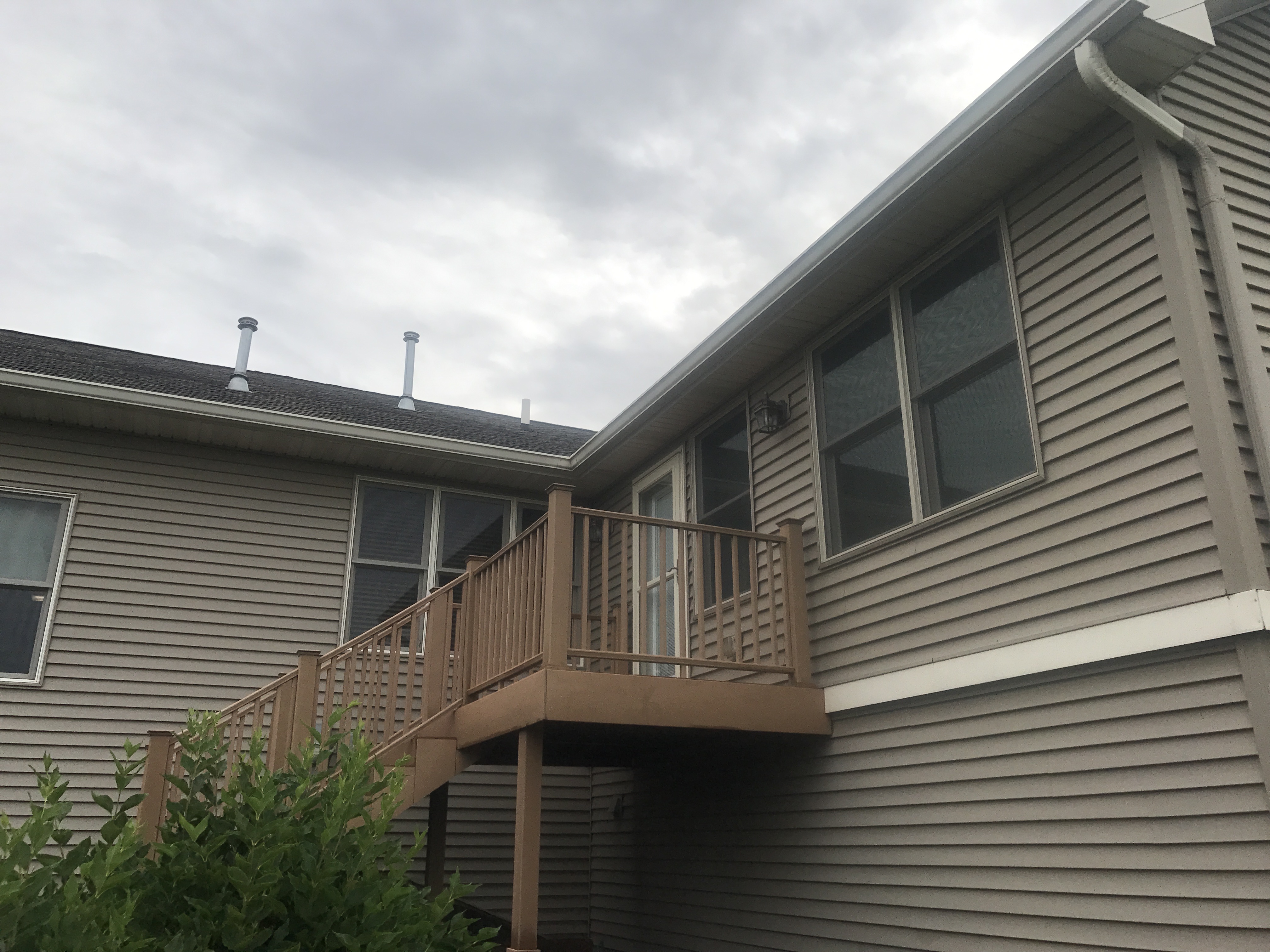

I’m quoting this job on my own, I usually sub-contracted out these jobs to another guy in my area but we recently had a falling out and I don’t want to do work with him anymore. I’m not going to turn down work so I need help here as this is my first time. I usually stick to house washing and window cleaning. I told these people a rough ball park of $700 and told them I would get back to them later on today with an actual quote. It’s a one story home but the back is on a slant causing it to be more like a 2 story home. Level ground I don’t see too much of a problem using ladders to reach the gutters. Now here is my question, can you guys tell me tips and knowledge on getting these zebra stripes and mold off the gutters. What chemicals, how to apply, how hard is this to do, what is some things I should know…anything would help. Also if you think you could give me any input on how you quote these jobs. Thanks in advance I’ll check back later today guys!
