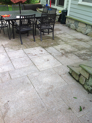

I have to bid a Granite Patio, 850 Sq Ft…. anybody do this before? Recommended Pressure? It has a ton of mold so I figured I would bleach wash by hand/brush, since it is small, followed by a light rinse and not use the surface cleaner as it would be too much… Any help would be appreciated.

Some house wash mix… a little dwell time… and a low pressure rinse.
Should be good to go.
its granite, why not use a surface cleaner?
That being said, I’ve never had the opportunity to wash one
Hey JC, I guess afraid to mess that stone up. Expensive fix…

granite is VERY hard
