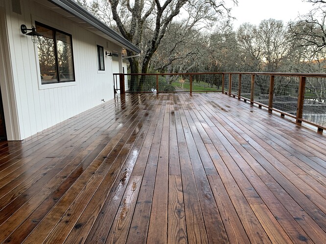

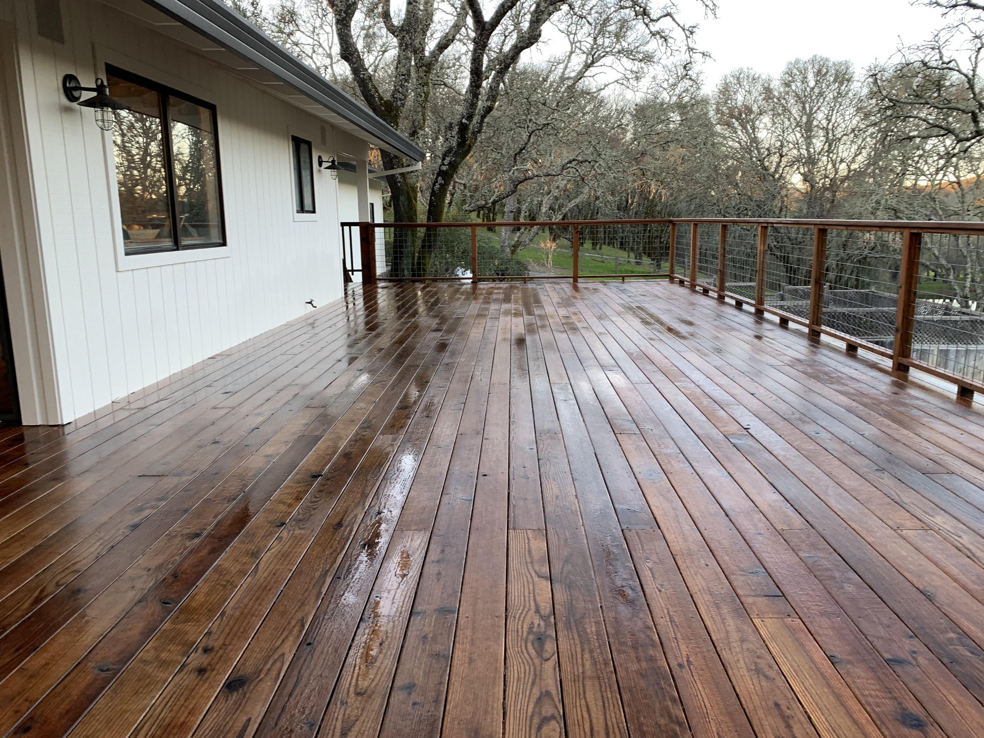

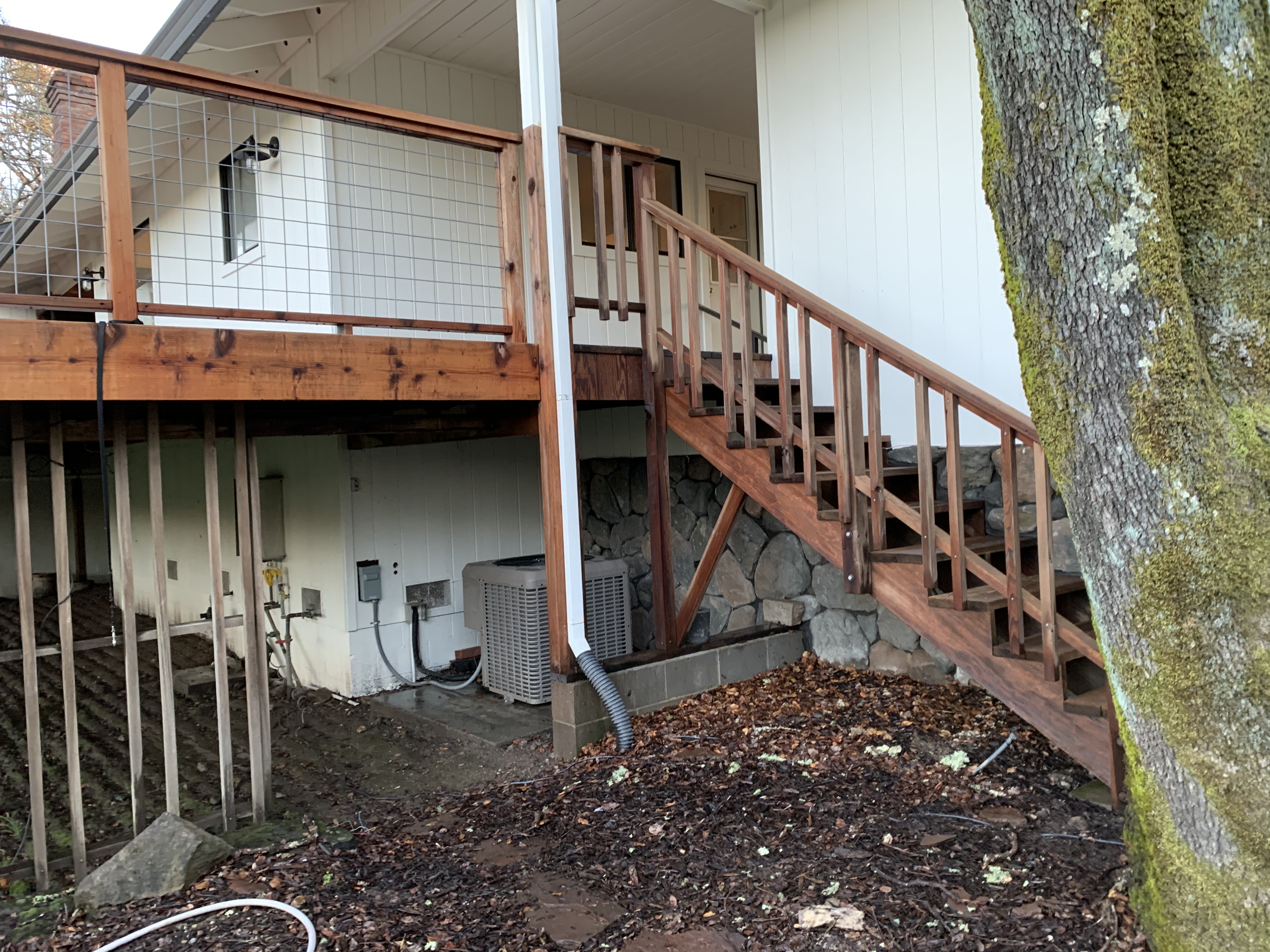

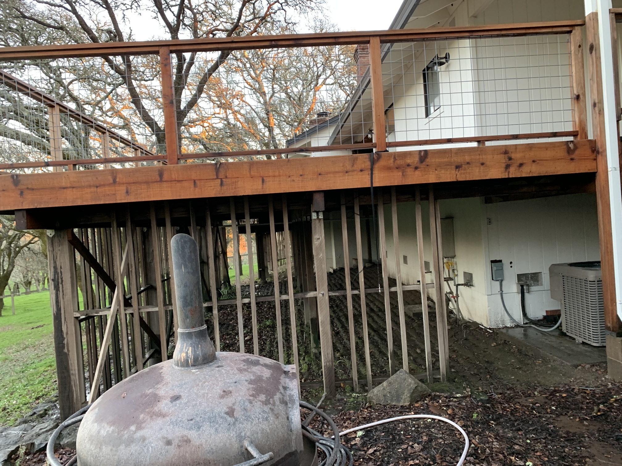

I’m on the fence about getting the graco project sprayer or the x5. I am leaning towards the x5. I have a 600sf deck I will be spraying oil based stain on this Friday and wondering what the best one to get is? This is that same deck I stripped with sodium metasilicate recently and hit with oxalic after. It’s been drying for over 3 weeks now. What would the best tip be to use? @marinegrunt also used one was yours the x5? In addition to the deck the only spindles are on the steps and the rails around the rest of it are wood with metal panels for the siding. I will have to mask a lot would you guys recommend just painting the railing tops by hand and masking the metal or just spraying all of it?
I just did a deck last fall that had those galvanized hog panels. I ended up completely removing them because it would’ve been a pain and took forever staining around them. It was a pain taking them off but it was definitely less tedious and time consuming as staining or masking them off. It looks like yours are sandwiched though. The panels I did weren’t sandwiched so the backside would’ve been impossible to mask off. Yours might not be so bad. Mark recommended just staining them at the same time as the deck. I was using waterborne so not sure if you can do the same with oil based. The customers wanted theirs to stay gray anyways. They wanted them painted while I had them off so I went ahead and did that too. They paid a premium but they turned out pretty good. A lot of paint went to waste due to over spray. The was one of my last jobs before the season ended so was a great way to end the year.
Let Mark recommended a sprayer. He has used and has a number of different machines so can give you better advice than I can. The tip used depends on the viscosity of the stain and how wide of a spray pattern you want. The larger the orifice the more stain coming out of the tip. You want to keep it small enough to where the stain is still atomizing well though. If a tip is labeled “312” the first number is the width of the spray pattern. The 3 means it’s a 6" pattern when spraying at a distance of 12’ away and the 12 means it’s a .012 orifice size. For deck boards I usually use a 5 but will go down to a 2 for spindles. Make sure you have a variety of different tips and mess around with them to find out what works best for you. Your technique and speed will come into play with what tip works best. Just practice by spraying water at first so you can get an idea of how the different size tips work. I’ve used the no name tips on Amazon and they seem work well.
Awesome thanks man. Practicing with water is a great idea! I am just gonna go for the x5 since it can spray way more gallons per year (lifespan). I know it’s not the greatest but it will be nice to have something I would look forward to using over a cheap handheld wager or some other knockoff brand. So it’s pretty easy to use I’m guessing? My main concern is having the stain be too thick, or dark, in some areas, even with back rolling it. I have a fair amount of experience painting but not staining. Can backrolling cause you to put too much stain on one spot and make it darker than the rest?
Staining is easier than painting. I always back brush. I don’t back roll. Not sure if there’s a difference though. Oil based stain shouldn’t be thick but I guess it depends on the type. I think a lot of oil based stains are penetrating so should be about the same consistency as water. Some waterborne are somewhat thick but I’ve never had an issue with some areas being darker than others. Super Deck from Sherwin Williams is more like a paint than a stain. I’m not a huge fan of it but it looks nice. I think this year I’m only going to offer Wood Defender oil based. Although, I think I’m going to try and stay away from staining. There sure is good money in it though. It takes some time to hang paper, plastic, and tape things off but the staining goes quick. Which brand of stain are you going to use on this job?
