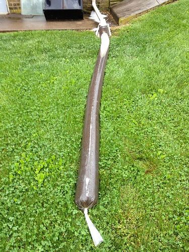

Get some 3 mil contractor bags to place at bottom of downspouts (You may have to remove the downspout leaders that go out in the yard).
The challenge that I issue to new roof cleaners is to see how little product you can use to clean the roof. It doesn’t need flooded in most cases. More is not necessarily better and enough to kill the growth and remove its color is the exact right amount.
Stop often and check you bags. Remove them before you think you need to.
After cleaning, flush the gutters (again, into bags) to remove the inch or so of roof bleach that always ends up standing in them.

Tim. So these 3mil bags will not bust when I pick them up to remove them? I imagine they can only handle so much water, not to mention getting too heavy to lift. So I guess my question is what is considered full to the point I need to replace them?
Switch them out sooner than you think they need switched.
Yes, they will bust. I just never had it happen to me.
Get some big rubbermaid totes and place the bags in it for transport.
And then get some poly tubing so that you can see what you’re dealing with.
Sorry to keep bugging you with stupid questions, but are you using the poly tubing for your hose line or where/what are you using it for?

If you can’t get the poly tubing just get some heavy duty garbage bags. What I starting doing is bag the gutters, lightly rinse the roof, change out bags, and then rinse the hell out of it. By the time your done it should be so diluted down it wouldn’t kill anything. Sometime I even stick a garden hose in the gutter to make sure it’s diluted down enough. Another local guy laughed at me and said that was overkill but the way I see it is overkill is better than replacing thousands of dollars worth of landscape. Good luck on the job!
