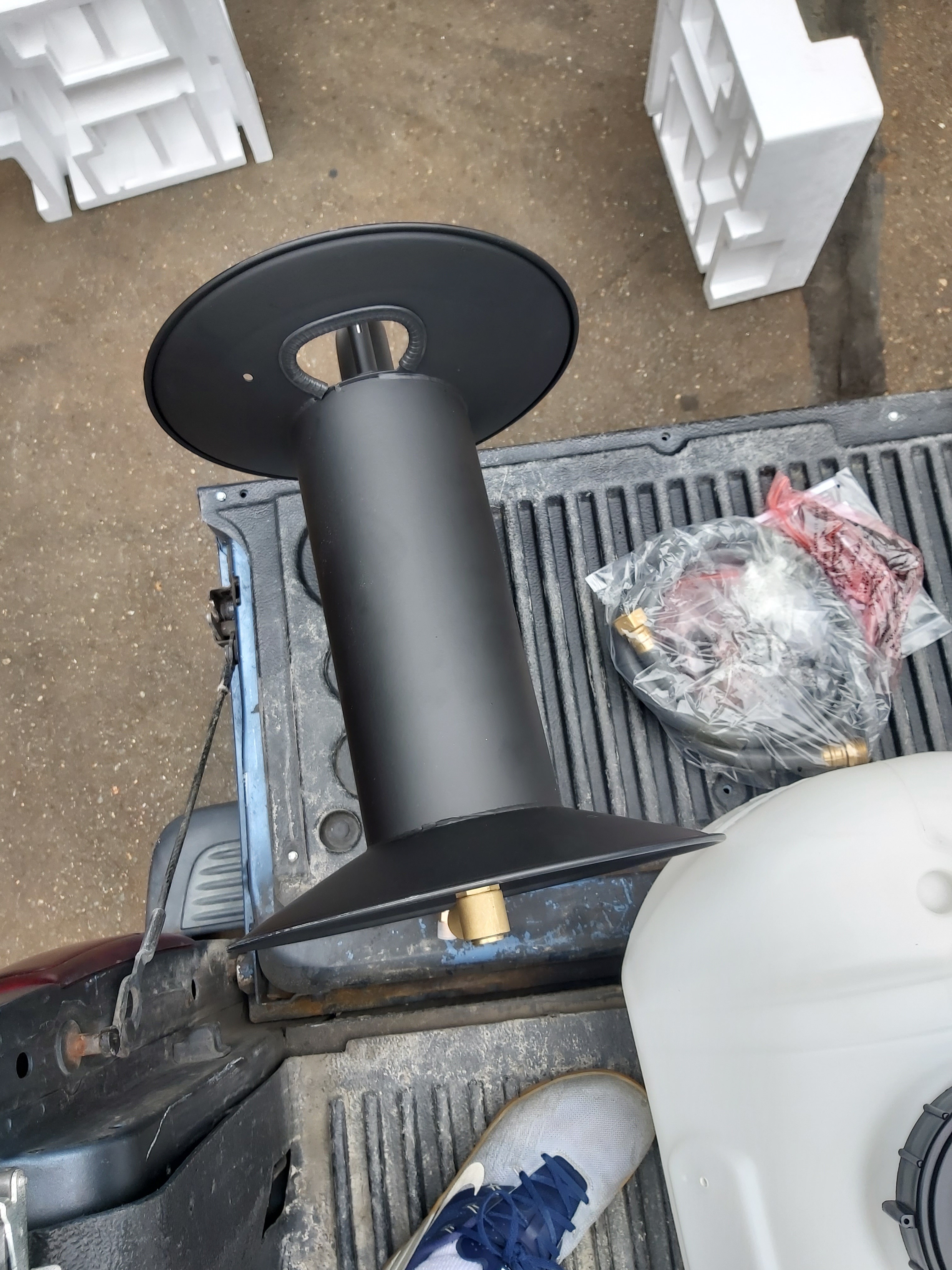

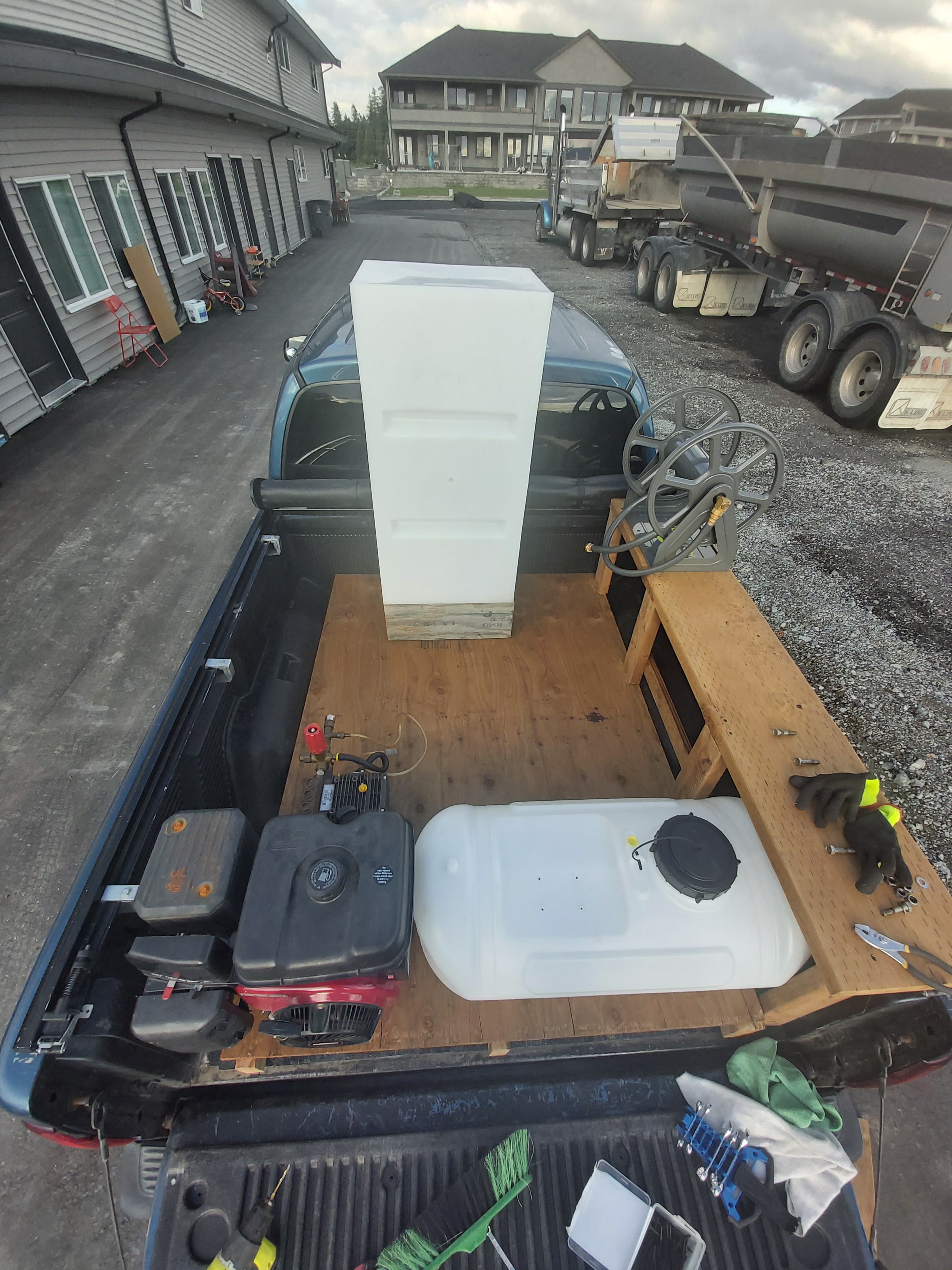

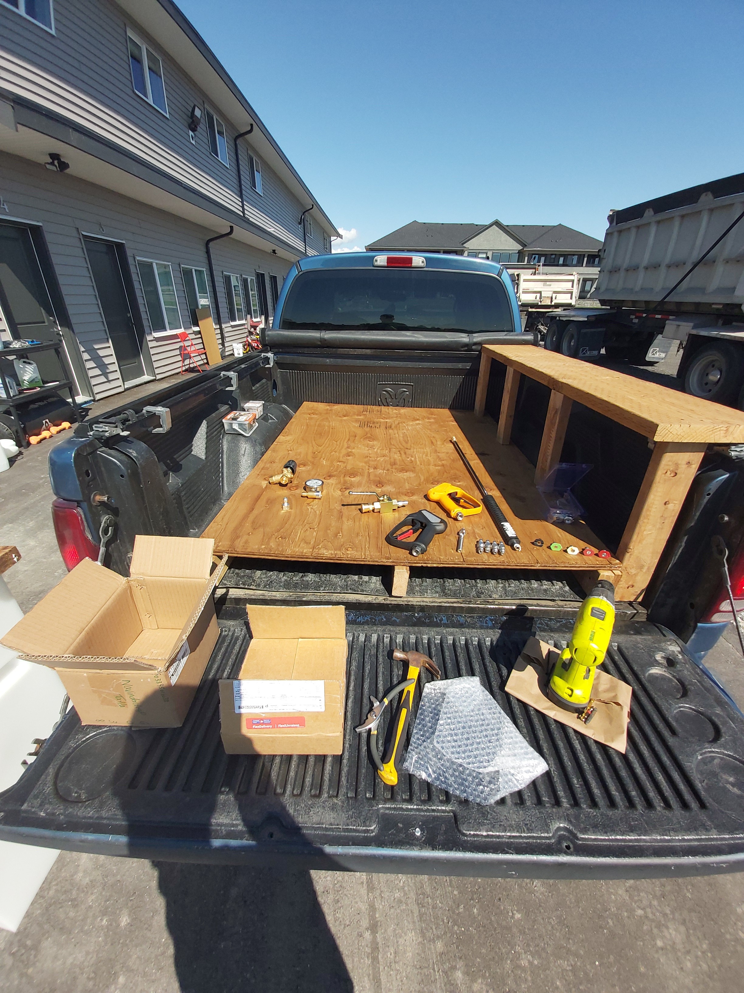

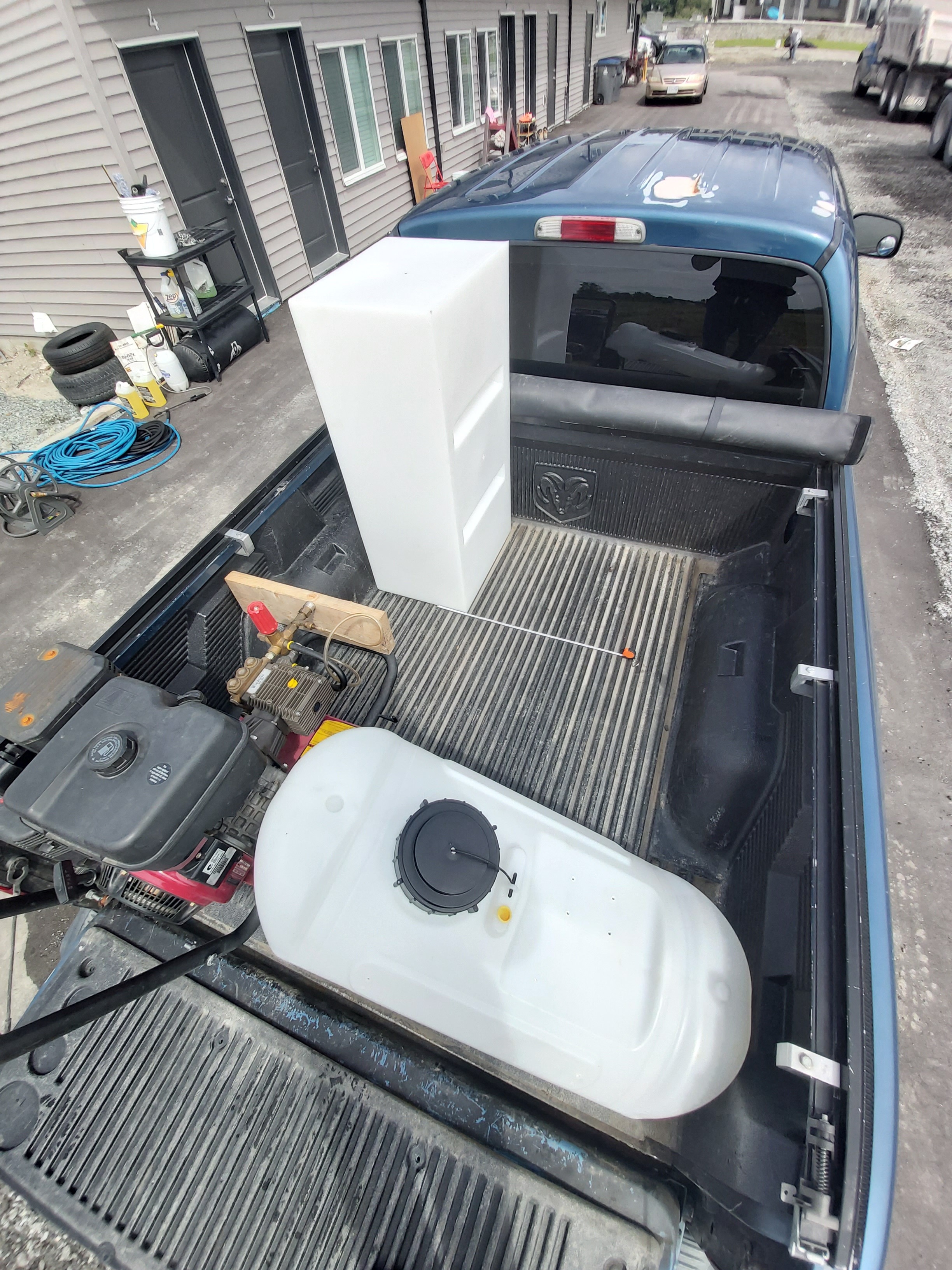

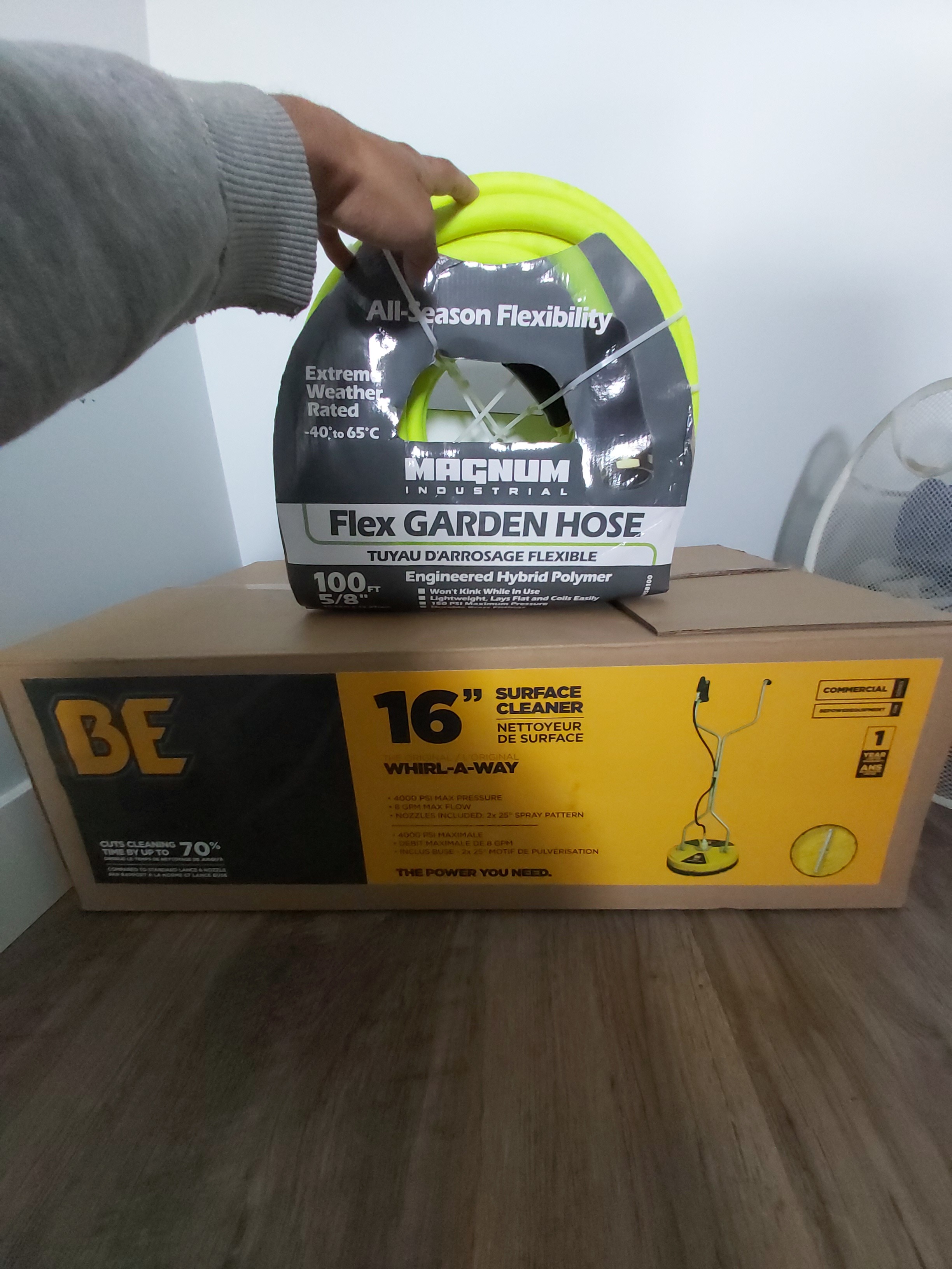

After many months of asking questions and researching Im excited to finally have the money to purchase my start up equipment and am ready to conquer the world lol. Just got some pressure treated wood which I will be building my rig base off. Just wondering if a ladder is necessary or do guys just carry that for roofs? Will have to get the ladder rack built on left side if so. I got another $1500-2000 I can invest into this start up. A portion is going towards marketing, shirts, business cards, yard signs etc. Should I invest in a Xjet m5 or add a 12 volt system. How much can a 12 volt cost to get set up? I got the 39 gallon for the buffer tank & can probably fit another 66 gallon tank beside it for a 12 volt. I can also fit a 3rd hose reel at the top. Or should i just keep the set up basic and invest in a mini trailer for a soft wash system later on as i get sales… what’s your thought guys. How would you play with the rest of the money? Cheers.

Many members on here will tell you that wood will be destroyed in short order.

If your gonna roll with that plywood skid I’d suggest more 2×4 floor joists under there, The weight is gonna sag it the way you have it now.

From my experience I would make that truck work for you if you can keep it dedicated to washing. Skip a trailer and go from that truck to a service/utility truck or flatbed. I have an SUV so I bought a huge trailer and now would like to start saving to get one of those trucks. It feel dangerous pulling a heavy trailer around everywhere and it is putting serious wear in my personal vehicle.

Get one of the small foldup style ladders from home depot and make a little spot for it to stand vertical in your trailer.

Downstreaming is an option for house washes. I’d get some Flexzilla, I got regular intake garden hose and regret it since Flexzilla wasn’t easily available where I am (outside the US). Hose reels are important, the amount of time you will save is amazing + it’s just more professional looking. Optics are a thing.

I blew a hole in my hose yesterday for the first time. I had to hand roll it up so I could take it in to Napa to get it fixed. No way would I ever not have a hose reel. If I had to I’d eat Ramen Noodles for a month just to save up to get one. Heck, I’d even eat dog food. For a few hundred bucks I see a reel as a necessity.
I agree a reel is very nice to have but we all have to prioritize. Having everything to start with is beyond the means of many new PWers. It’s also easy to add as your bring in money. :+1:
