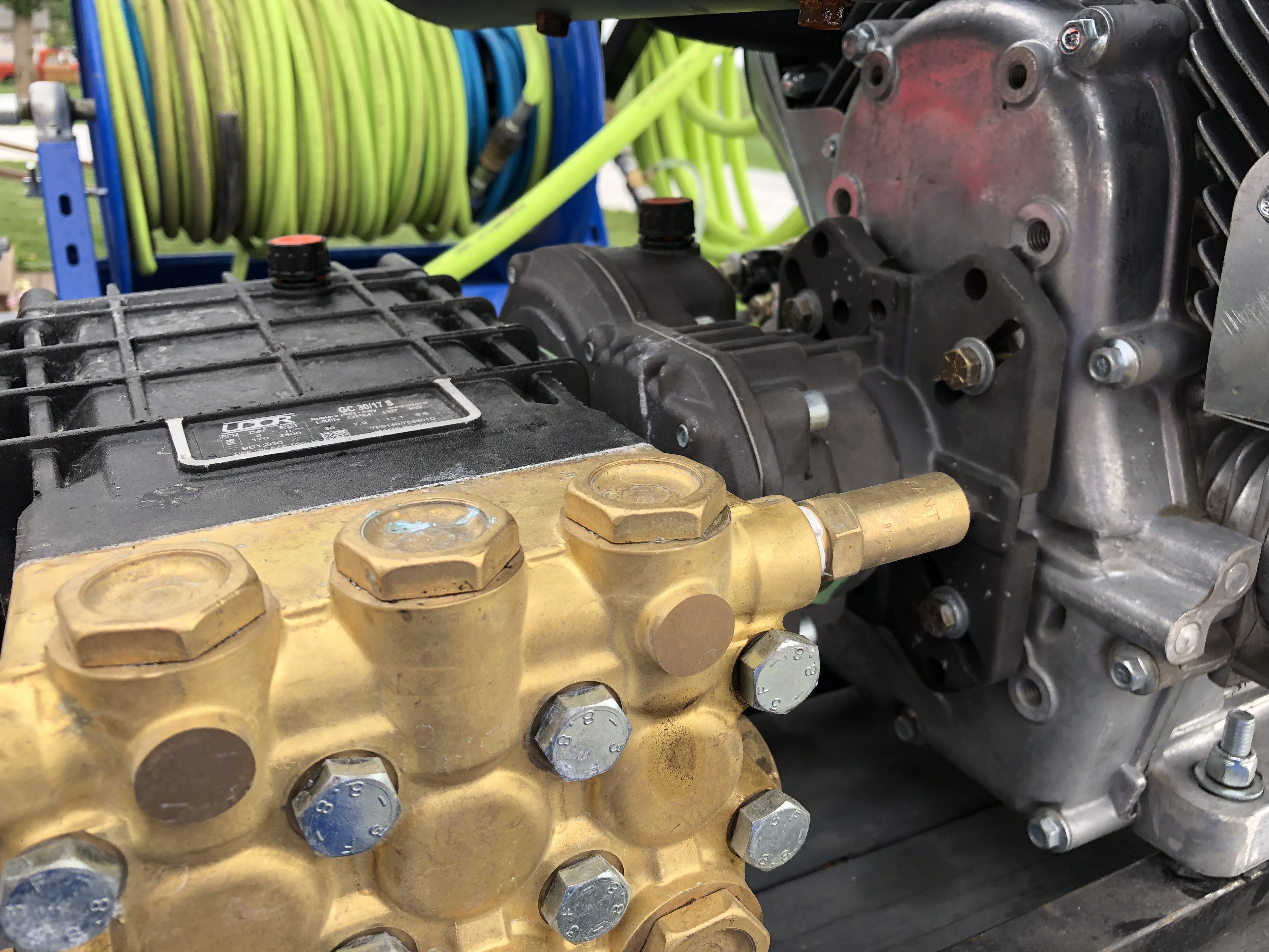

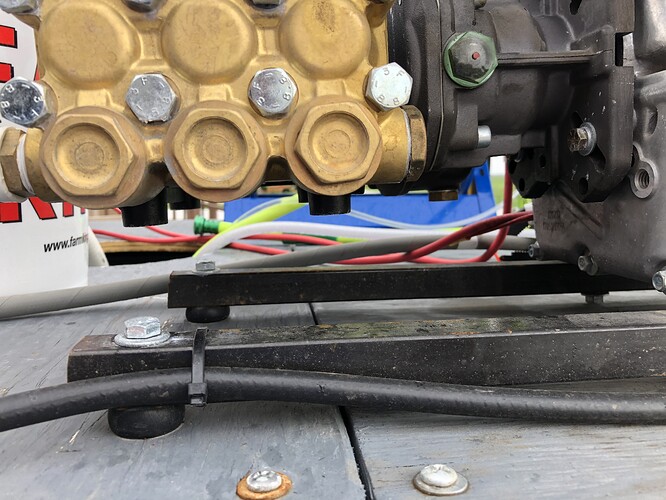

With the larger gear drive units, is the pump supported to the skid at all, or is it still just bolted to the motor?
Just bolted to the motor.
Seems sketchy
Just for you!
